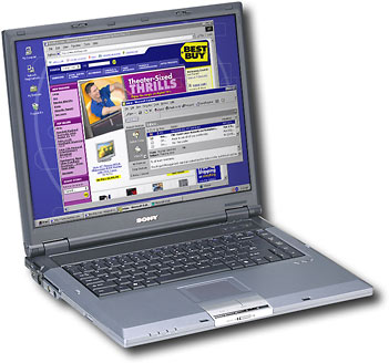

Sony Vaio GRT260G
  • Rikintosh
    • Oct 2020
    • 5
    • Brasil
    Sony Vaio GRT260G
    This notebook was of my daily use, and I have a lot of esteem for it. However, one day I was using it, it froze (it was very hot), so I hung up, and when I turn on it again, it had no video.
    I bought a new video card for him, but I was not lucky. I changed processor, hd, memory, display, with no luck. He's a pentium 4, what could have happened?
    Last edited by Rikintosh; 10-06-2020, 10:35 PM.
    Sony VAIO SVF11N1L2E Hybrid (2-in-1) Fit multi-flip Specification for Upgrade or Repair
    This specification for the Sony VAIO SVF11N1L2E Hybrid (2-in-1) can be useful for upgrading or repairing a laptop that is not working. As a community we are working through our specifications to add valuable data like the SVF11N1L2E boardview and SVF11N1L2E schematic. Our users have donated over 1 million documents which are being added to the site. This page will be updated soon with additional information. Alternatively you can request additional help from our users directly on the relevant badcaps forum. Please note that we offer no warranties that any specification, datasheet, or download...
    09-06-2024, 05:27 AM
    Sony VAIO VGN-FZ31J FZ Specification for Upgrade or Repair
    This specification for the Sony VAIO VGN-FZ31J can be useful for upgrading or repairing a laptop that is not working. As a community we are working through our specifications to add valuable data like the VGN-FZ31J boardview and VGN-FZ31J schematic. Our users have donated over 1 million documents which are being added to the site. This page will be updated soon with additional information. Alternatively you can request additional help from our users directly on the relevant badcaps forum. Please note that we offer no warranties that any specification, datasheet, or download for Sony VAIO VGN-FZ31J...
    09-06-2024, 05:27 AM
    Sony VAIO SVT1122I4E Hybrid (2-in-1) Tap 11 Specification for Upgrade or Repair
    This specification for the Sony VAIO SVT1122I4E Hybrid (2-in-1) can be useful for upgrading or repairing a laptop that is not working. As a community we are working through our specifications to add valuable data like the SVT1122I4E boardview and SVT1122I4E schematic. Our users have donated over 1 million documents which are being added to the site. This page will be updated soon with additional information. Alternatively you can request additional help from our users directly on the relevant badcaps forum. Please note that we offer no warranties that any specification, datasheet, or download...
    09-06-2024, 05:27 AM
    Sony VAIO VPCM12M1E/W Netbook Specification for Upgrade or Repair
    This specification for the Sony VAIO VPCM12M1E/W Netbook can be useful for upgrading or repairing a laptop that is not working. As a community we are working through our specifications to add valuable data like the VAIO VPCM12M1E/W boardview and VAIO VPCM12M1E/W schematic. Our users have donated over 1 million documents which are being added to the site. This page will be updated soon with additional information. Alternatively you can request additional help from our users directly on the relevant badcaps forum. Please note that we offer no warranties that any specification, datasheet, or download...
    09-06-2024, 05:27 AM
  • Carlos#2003%
    by Carlos#2003%
    02-15-2024, 07:52 PM
