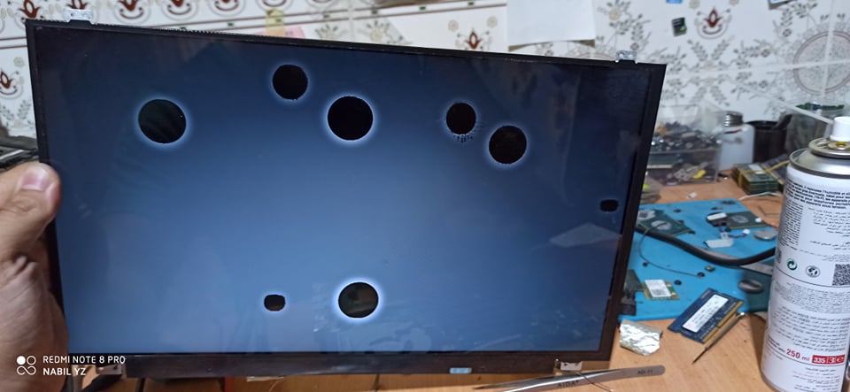

    hey i have toshiba TOSHIBA C55- B861 borad numb DA0BLJMB6C0 REV C
    the probleme when i turn on it work good on external screnn but the inside screen only get backlight but no data
    LVDS PIN 30 PIN: pin 1 and 2 i found 19v pin 4 and 5 got 3.3 pin 6 3.3 v pin 7 no voltage pin 8 no voltage pin 11 0.09 pin 12 0.12

    try another display.

      i did try new display and new screen cable
