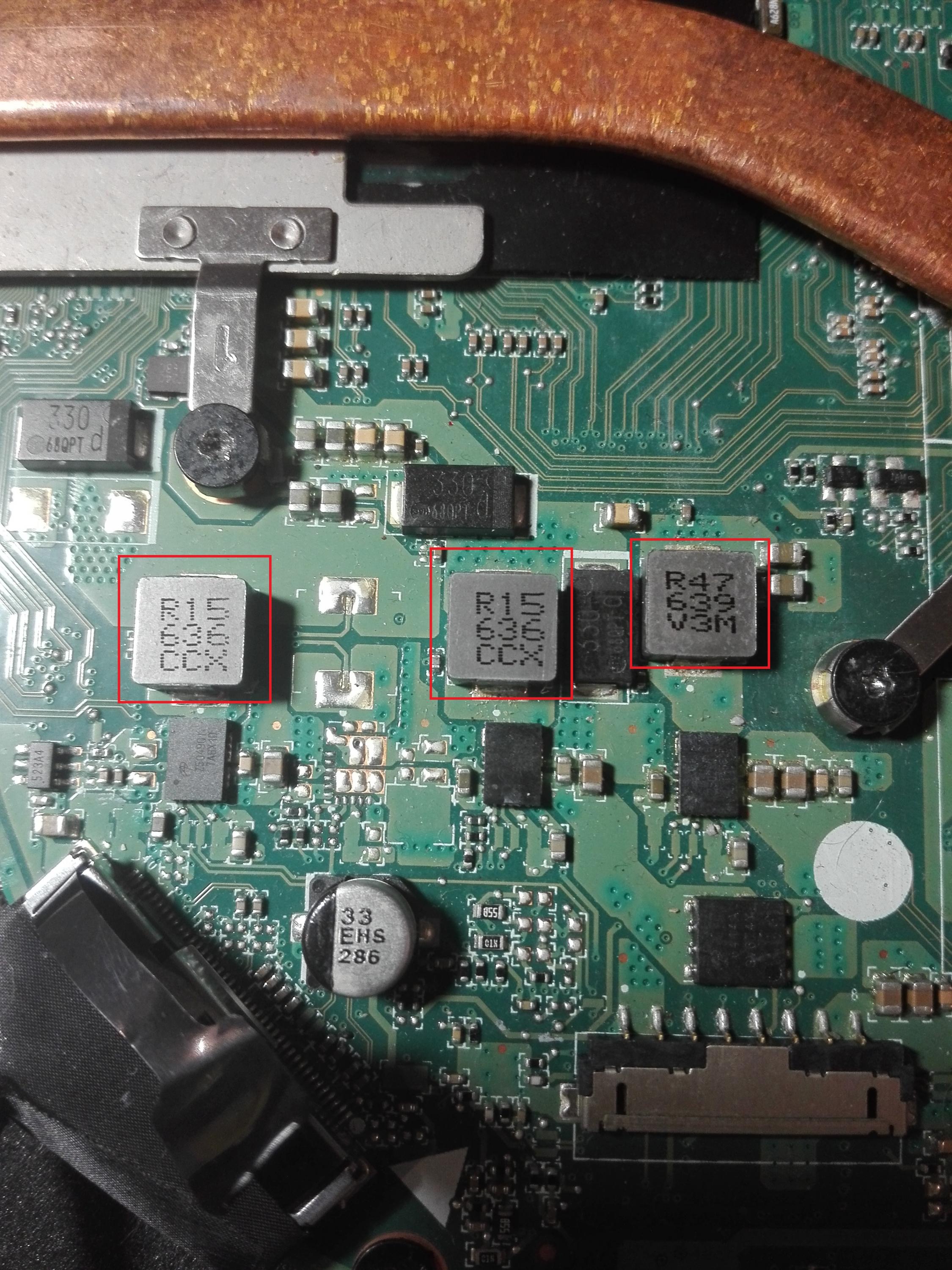

    Good afternoon, I come to ask your help to identify which is the electronic component that is marked in red. It is found on a notebook motherboard.
    What is the component called?
    And if it's normal to overheat?

    Post in english please !!! .Those are coils. What is the motherboard part number,what problem are you having ?

      Thanks a lot for the help. has no number or reference on the motherboard. the problem is notebook has power but does not give an image. I already reprogrammed the bios but it didn't work. I noticed that one of the coils is very hot, is it normal?

        Seems like acer but there is part number on mb.You need to find out.

          where can i find this part number? can someone help me? it is an acer E5-575G.

            how can I read the reference of this coil?

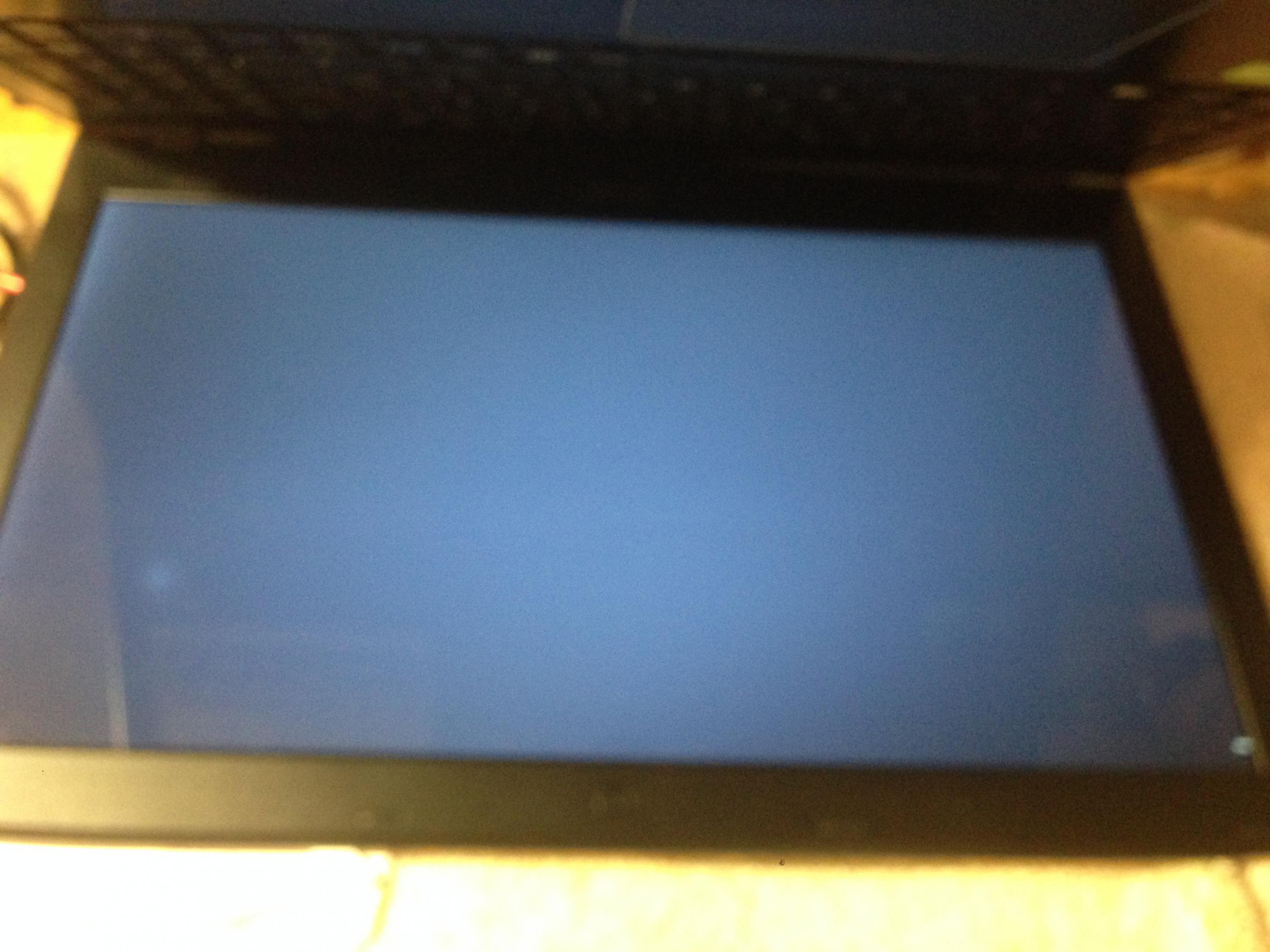

              The problem I have is: the notebook turns on and the screen also turns on but there is no image, it is all black with a small white stroke in the corner blinking.

                  Wait, the blinking line is an image.
                  It does not seems to load the os. Remove the hard disk and see it you can see the post/bios screen.
                  Have you already removed the internal battery for a while to reset the bios?

                    I did everything I was told. I took the battery out of the bios and waited a few hours. I took ram and disk the screen is completely black. Only with the ram a small flashing line appears in the image. Does anyone have any idea what it might be?

                        tap f2 right after switching it on and see if it loads bios
                        also try an external monitor

                          I did as indicated by the f2 key right after starting. but it does nothing. the laptop starts with the black screen and the white cursor flashing in the upper left corner.
