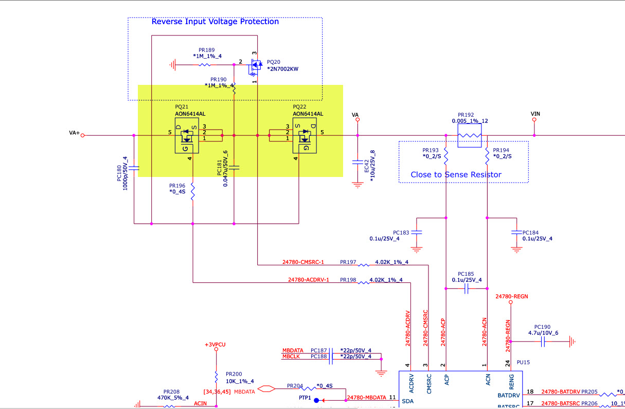

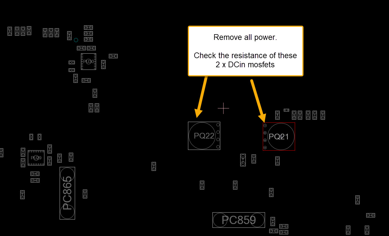

                    See attached.
                    Often the 2 x DCin mosfets are the suspects. Usually the 2nd one is found to be defective and has to be replaced but start your investigation.
                    Remove all power. Meter in resistance mode.
                    Check the resistance across the mosfet pins and post your readings:
                    source (1-2-3) & drain (5-6-7-8)
                    source (1-2-3) & gate (4)
                    gate (4) & drain (5-6-7-8)
                    Check each of these mosfets.

                      Originally posted by mon2
                      See attached.
                      Thank you very much for youre reply!!
                      The readings are as follows:
                      PQ21
                      source (1-2-3) & drain (5-6-7-8) - 0 Ohm
                      source (1-2-3) & gate (4) - 0 Ohm
                      gate (4) & drain (5-6-7-8) - 59 Ohm
                      PQ22
                      source (1-2-3) & drain (5-6-7-8) 75,3 kOhm
                      source (1-2-3) & gate (4) - 59 Ohm
                      gate (4) & drain (5-6-7-8) - 75 kOhm
                      I hope it makes sens..?

                        Both mosfets are with low resistance readings.
                        Can you confirm the meter scale used for each check ? If possible, post a pic of your meter.
                        Is it possible that the meter was showing 'OL' = over limit so the next higher scale on your resistance setting should be selected.

                            The readings are very low. It is very possible that one mosfet is causing the other to look bad. Bad influence from the same family of mosfets. Movie to follow soon...
                            If you wish to proceed and have the tools, remove the 2nd mosfet @ PQ22.
                            Then check the resistance values again. Just note which part is placed where and also the orientation of pin # 1 - a picture will be very helpful before you start.
                            A good idea to also check the resistance of the part after it is removed and on your work table. This will offer a good idea if the low resistance is being influenced by other parts on the logic board or not.
                            Start with remove PQ22 and if required, remove PQ21. These mosfets are very common and can be replaced with other vendors and parts with the same fit and function. Interested in the resistance readings of the pads on the circuit board.
                            Before you proceed, use flux if available, low air pressure so the other parts do not go flying + tweezers + circular motion till the solder melts. Do not force the movement of the parts else the PCB traces / pads will tear off!!
                            Be patient and the mosfet will eventually just swim on the solder pads of the PCB which can then allow you to remove with tweezers.

                              PQ21 is clearly the one that's shorted. And there'll most likely be a short to ground on main power rail.

                                  First - I better correct the info on the resistance on PQ21...
                                  PQ21
                                  source (1-2-3) & gate (4) - 59 Ohm !!
                                  ... I'm sorry, my first reading was faulty - I don't know why..?
                                  When that is said - I'm more confident now, that you are both right - One or both of PQ21 and PQ22 has shorted. After reading the excellent thread - https://www.badcaps.net/forum/showthread.php?t=90356 it seems I should also check the main power rail. I can't inject power as of now, as I'm waiting on my bench power supply (wuptidooo :-) ) being delivered hopefully late next week. I have tried to make some readings on the resistance between VA+ and ground and found:
                                  I'm not sure it tells a lot, but ...?

                                    With enough flux on the part, remove PQ22 mosfet. Be patient to allow for the metal underside pads to melt the solder. Nudge the part now and then to check if the part is able to swim on the surface before plucking it off the board.
                                    Never push this step. The solder will melt if you apply small circles over the topside of this body.
                                    After the part is removed -> check the resistance to ground again for the main power rail.
                                    It should certainly not be a 0 ohm resistance to ground which is concerning.
