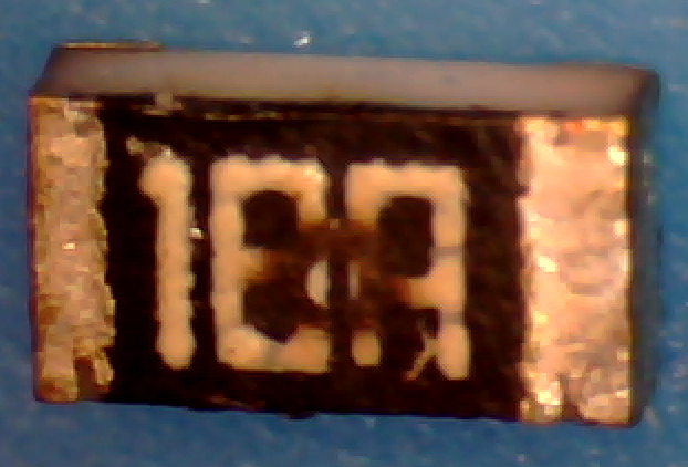

    Hello have this Lenovo E480 that after storm wont work
    NM-B421
    two chargers USB-C dont give me voltage. so i cut one and with cable connect my source and see 2.7W steady. Found hot area near power connector with burning resistor. it is so tiny that i cannot see its value
    when connect charger on one side of this resistor is 20V on other side is pulling down to ground by Q4202

        Re: Lenovo E480 no sign of life
        in schematic i dont see any ID pin but in cable there is wire for it.
        Anybody know how this USB-C charger work? i have new charger, why it dont give voltage?
          • 20914
          Google search "NM-B421 VSYSTEM2" ,you`ll find some posts on chinafix and elvikom. USB-C is still a mystery to me.
