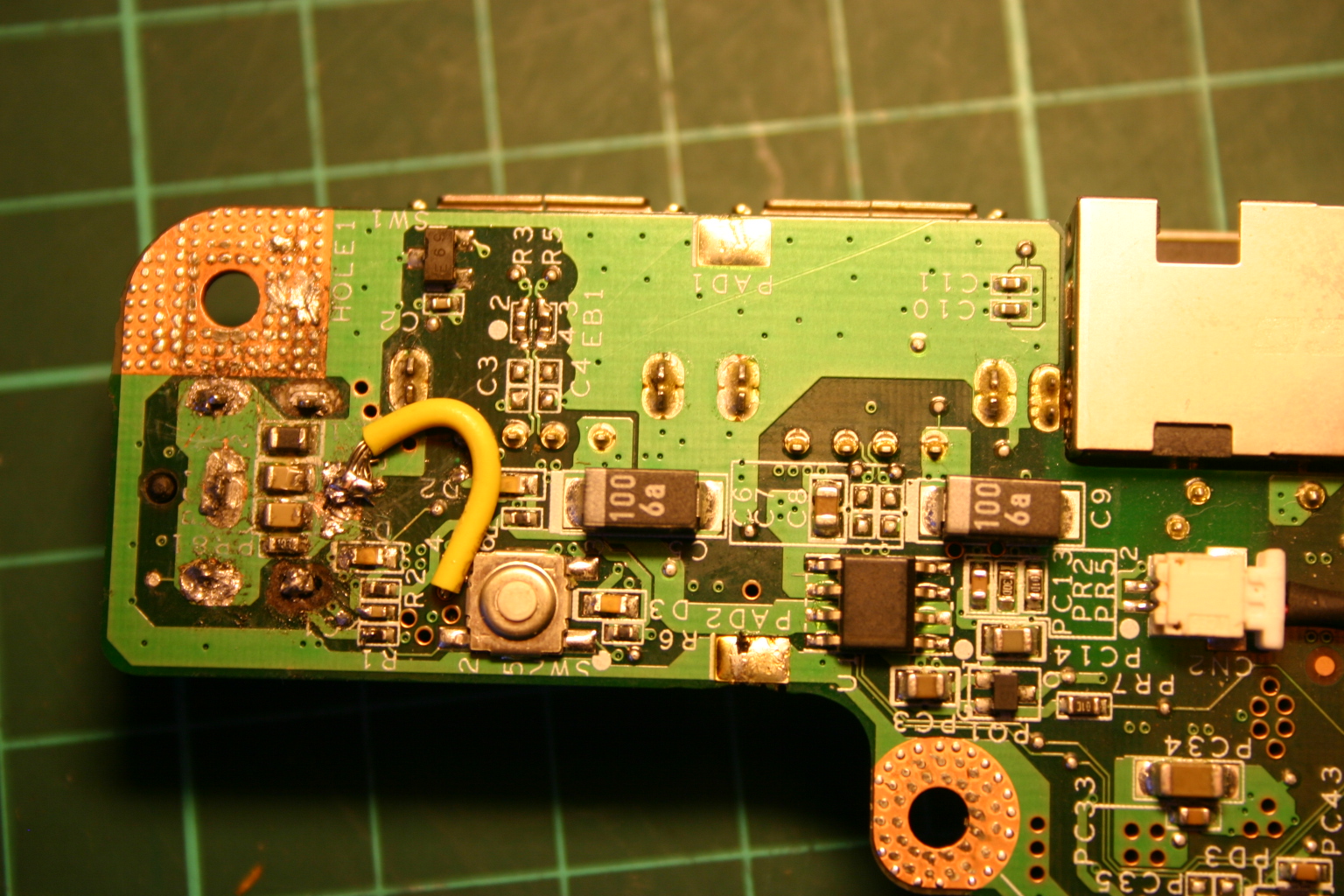

                        Originally posted by filesponge
                        Hello everybody, I was browsing the net to see about this MA7 problem, and found this forum. After seeing the original message left by BTMMIKE, it confirmed what i'd been wondering about - the silly design of POS pin on these sockets, added to a bad design where it goes thru the board, means it does indeed wear a bigger nasty hole in the contact.
                        The very small photo showed me just what i needed to see, and believe me this is a simple repair
                        I've attached 2 photos as clear as I could get, so hopefully this will help others with the same problem. As mentioned previously, many ebay-type suppliers don't seem to know what they are selling.
                        There are 2 main types of this socket - one is used usually by IBM and has a flat rear pin. The Gateway MA7 uses a round pin - the 2 sockets are NOT compatible, cos the pins are just the wrong size for a quick swap-over.
                        The other point is, most of the suppliers are selling ones with only 2 ground/side contacts, so the socket is less sturdy. The MA7 uses 4 ground/side contacts, a ground/centre contact, and a rear/Positive round pin.
                        So assuming you have the right one, you can just put a wire from the underside of the positive, and then poke it thru one of the tiny holes shown in the photo. Sorry about the bad soldering shown (lol) here but the local shop had no 1mm tips for me so i'm waiting for one, this was done with a monster 3mm on an Antex
                        There is a small black fuse (is it a fuse? looks like one to me, it's either that or just an un-needed smoother) sat just behind the rear of the socket (in the photo it links the red to the green area).
                        It's up to you if you attach to the 'red' side of that instead of directly thru the board as I have done. Depends on how much that part bothers you, but I couldn't get in there to solder to such a small component with my monster tip today
                        It works fine, done 2 without a hitch and they all start up now with all blue lights showing
                        Hope this all helps somebody. I'll drop back in again soon and see if anybodys read this
                        (I soldered a blob directly across from my wire to the nearest good sized component - but I advise just soldering your own wire onto the hole it comes thru. On these boards, no way would my iron get the solder to grip the actual board itself. Maybe bad board surface/solder tip/solder quality - I wont know till I get the proper stuff in a few days.
                        Good luck with this one

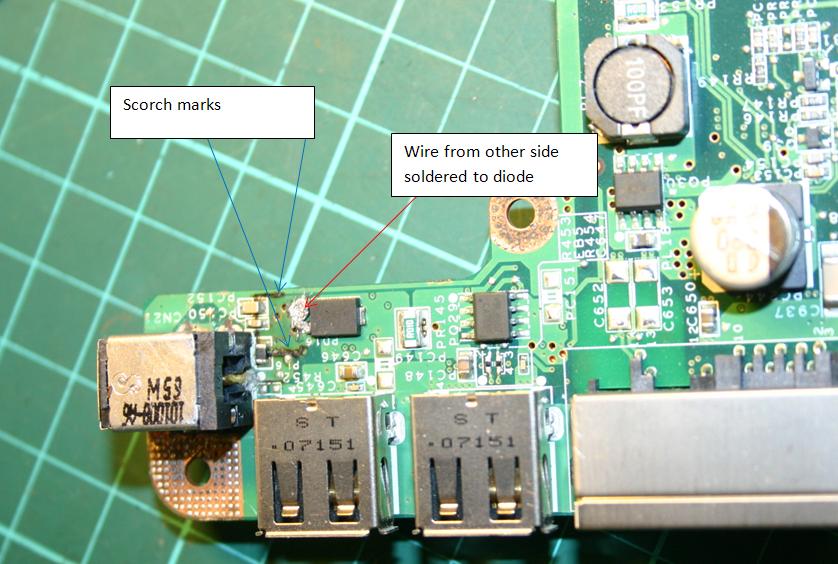

                        thank you filesponge for this solution, i have mended 1 mobo with your informative instructions and pics.
                        however, the 2nd board i have attempted to repair has not worked. this board is different in that it has scorch marks on the board and smelt of burning when power in but works ok on battery.
                        i have included a pic of scorch marks.
                        when i first replaced dc jack i noticed
                        there is also scorch marks round the hole for the dc jack back post, also the board is broken around the hole and a bit of copper is poking through from the board. im thinking, should i remove jack again and insulate the post from the board? leaving enough of the post on the underside (un insulated) to attach wire to?
                        • pc_ste
                          • Nov 2012
                          • 4
                          • U.K.
                          tried avoiding any connection to post hole and connected wire from post to diode. still no joy. is there another place i can attach wire to? lights still come on with battery
                            There are two places you need to jumper. You need to jumper to either of the two resisters on the top of the board. When the plated thru hole goes bad, you lose connection on both sides of the board.
                              hi spitz, thank you for your info. could you please clarify where i need to jumper to?
                              i have included top and bottom pic, could you please point out on these pics where i need to jumper to, im not sure which are resistors.
                              thanks again
                                i have included top and bottom pic, could you please point out on these pics where i need to jumper to, im not sure which are resistors. thanks again
                                On the top of the board to pd16 as you have done. On the bottom of the board you need a jumper to pc1 and pc2 capacitors that are right under the jack. The side closest to the pin. Make sure you do not include pl1. You can put a blob of solder between the pin and the two capacitors.
