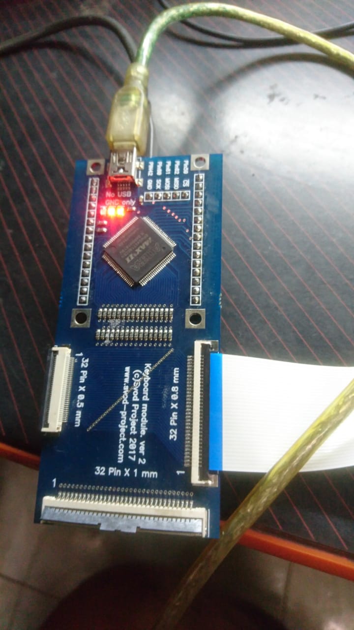

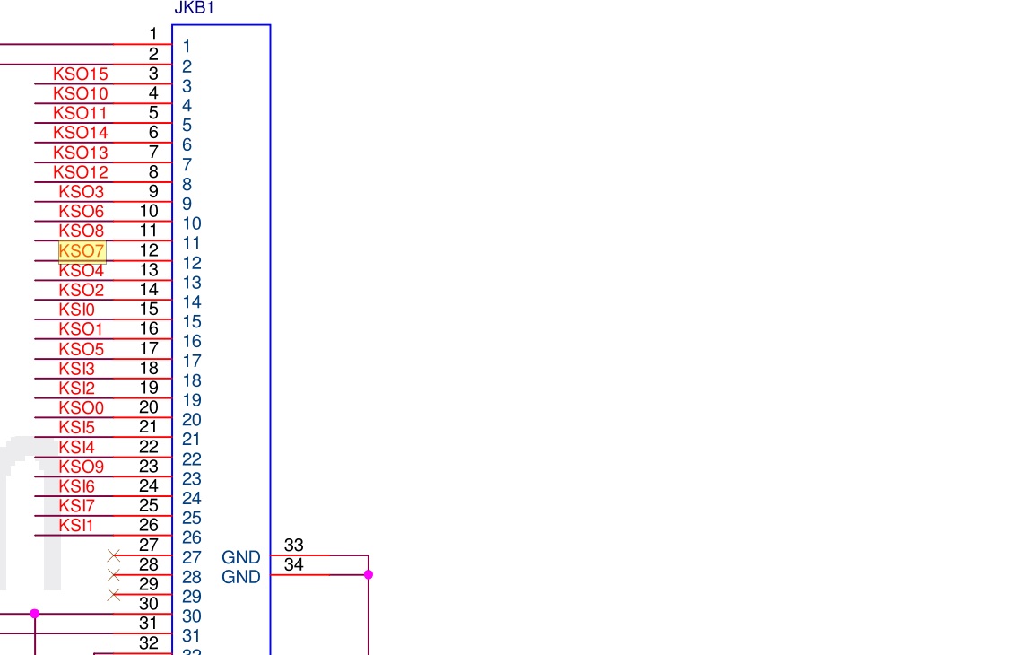

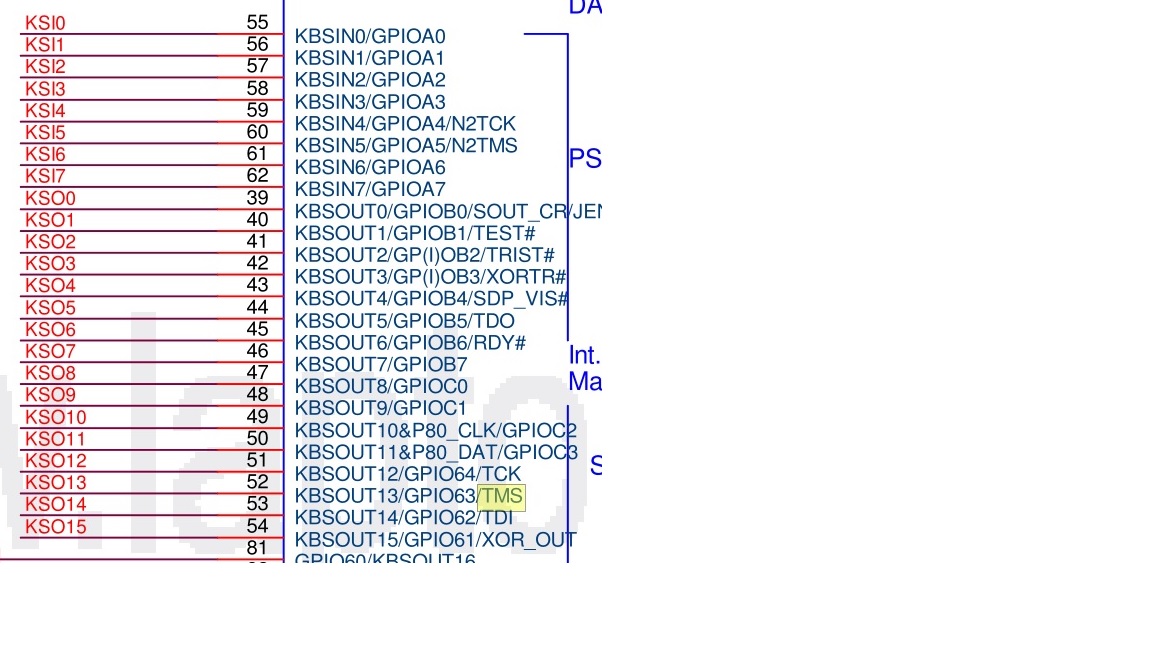

hello guys i have a lenovo 520-14IKB CIUYA YB SA SD LA-E541P Rev 1.0 , it has a nuvoton ncpce388nb i know is programable, i been trying to program these nuvuton but it giving me problems i attach the svod i been using, can someone tell me the right way to program these kbc, with pins out please, all are ok i even have continuity from motherboard to svod, so i dont know what could be the problem.
how to program using svod 2 nuvoton NPCE388NB0DX
