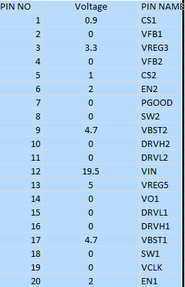

TPS 51225 No 3/5 voltage.
  • IamPritesh
    • Aug 2017
    • 356
    • India
    This Laptop came as a short ot ground on 19v rail. The faulty capacitor has been removed which was close to this TPS51225 IC
    Please refer to the readings of the IC in the attached image

    Re: TPS 51225 No 3/5 voltage.
    do we have to guess what the motherboard is ?
      So sorry brothers... its DELL VEGAS/TURIS SKL7KBL 15431-1 91N85
        there are 3types of that regulator
