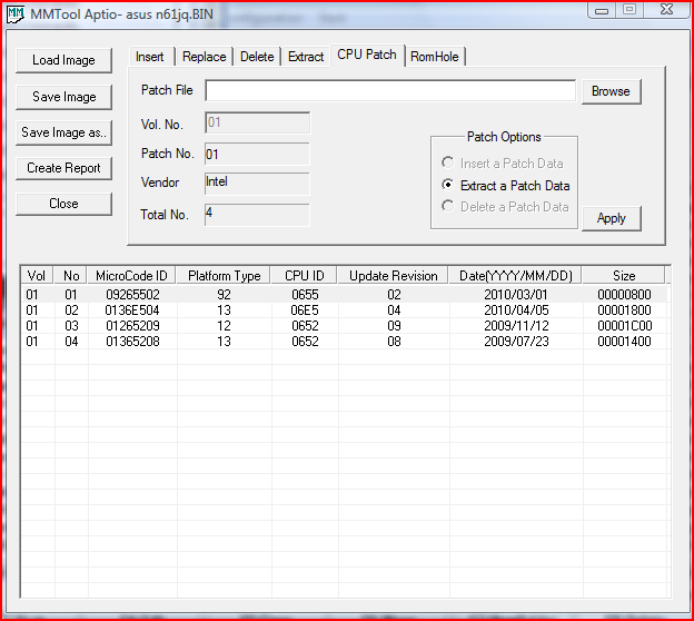

            I have open the original bios with mmtool and this is the result:

                Seems that CPU ID: 06E5 is for Core I7-720QM, i7-820QM and i7-920XM.
                The weird thing is that with the i7 tested hung quickly than with i5.
                I7 tested is good. (tested on other mobo)

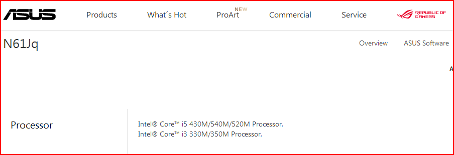

                  heres the spec page: https://www.asus.com/Laptops/N61Jq/specifications/
                  Try it with PC3-8500 RAM

                    Seems that this mobo should mount a core i5-430 or similar.
                    I don't have any PC3-8500 ram, i'm trying to get one module to test it.

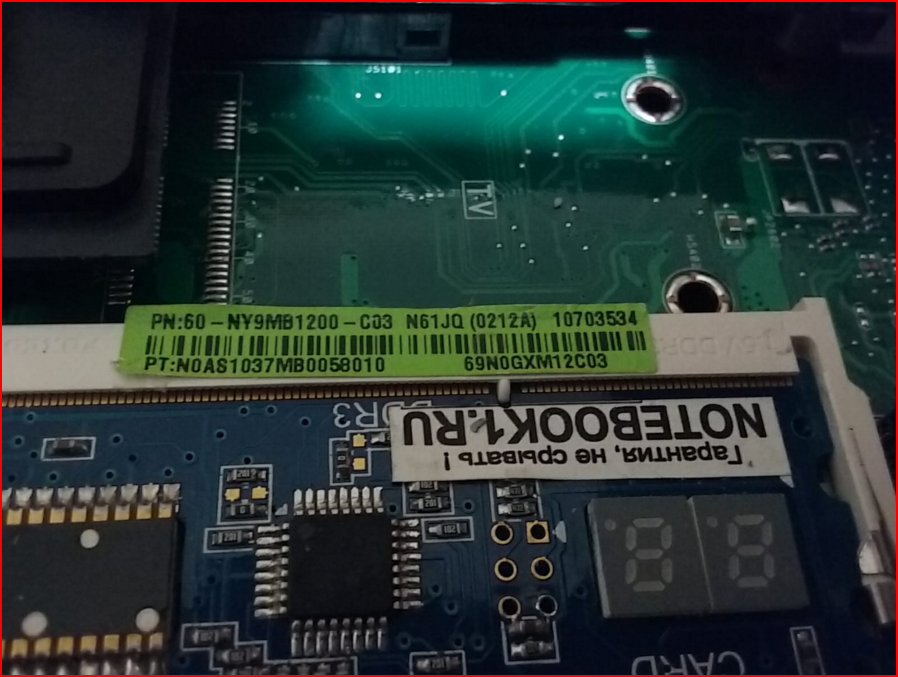

                        Your bios backup is from a N61Ja .What part numbers do you have on the green sticker ,on the ram slot.
                          Seems that both models are almost identical.
                          https://www.asus.com/es/Laptops/N61Ja/specifications/
                          This is the number on the ram slot:
