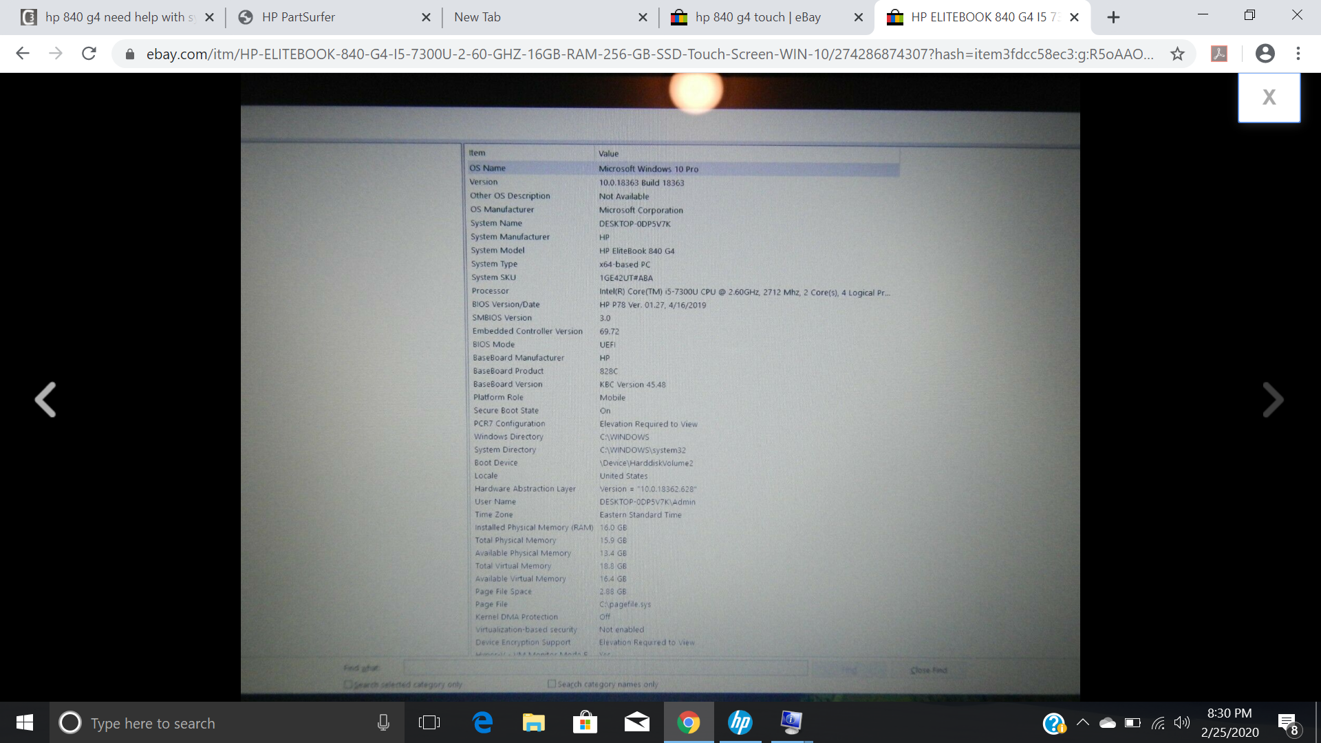

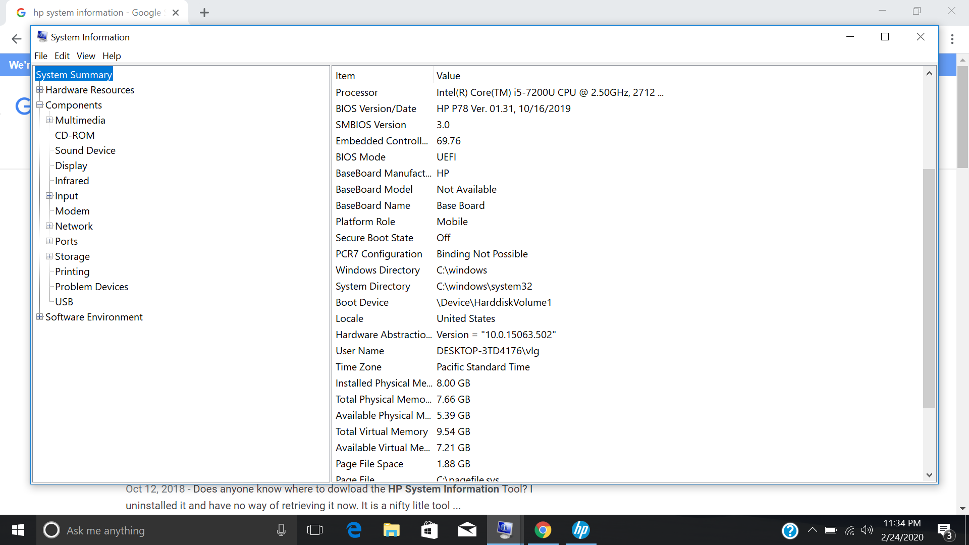

        Here's something interesting I found when doing some more digging.
        The mainboard info on my machine is missing when I look at system information. The first screenshot is my actual PC, note the mainboard info is not present. The second screenshot was borrowed from an ebay seller selling a 840 G4 touch, their mainboard info is populated. Could this be a problem or part of my solution?

          Re: hp 840 g4 need help with system hardware configuration
          I dont think so. The mainboard info you are talking about is what we call DMI data. Missing dmi data has nothing to do with touch enable.Its all about some additional hardware components needed for touch screen enable option.
