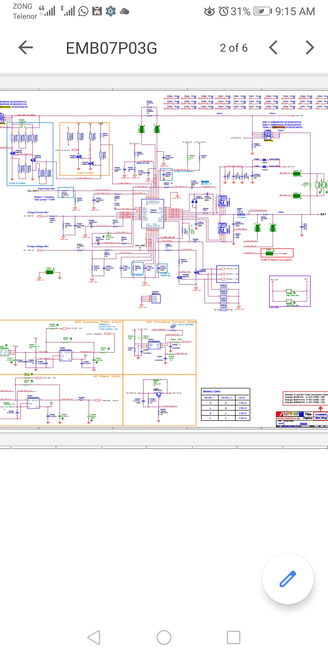

    Pardon, but how much voltage should I be getting on AC_BAT_SYS? Is it 5 volts or is it 19 volts? Either way, it's not coming there. lul

      Check this section..check voltage on Pq8802 on both side(Drain& Source)..

        Drain = 19.29 V
        Source = 18.80 V
        That thing next to it, what is it? Where is it located on schematics?
        full size https://ibb.co/QrDZXFv

          I think you are showing( FET )PQ8803
            Re: ASUS K53SV not turning on
            I think your uploaded schematic not matching with you laptop motherboard..
            Upload clear pics of board.
