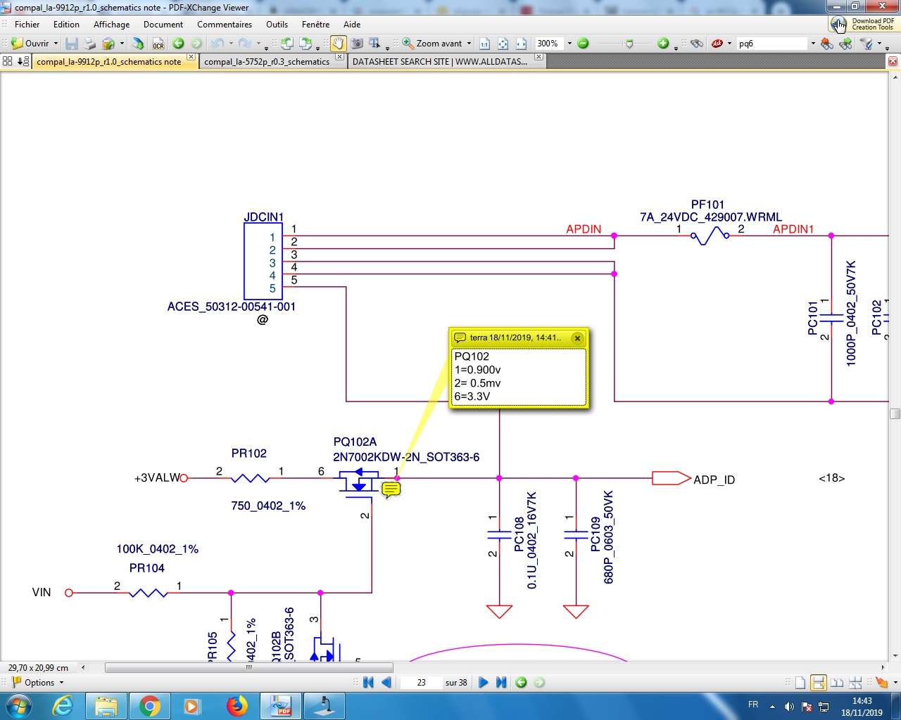

    when i plug charger , i find 0V at PF101.change cable same thing.
    No short to ground , i find 88 Kohm on both side of PF101 with multimeter .
    i inject power on PL101 = not shorting.
    I find no Volt too at PQ102A ( ADP_ID ).
    I m so confused ,What to Chek else please!

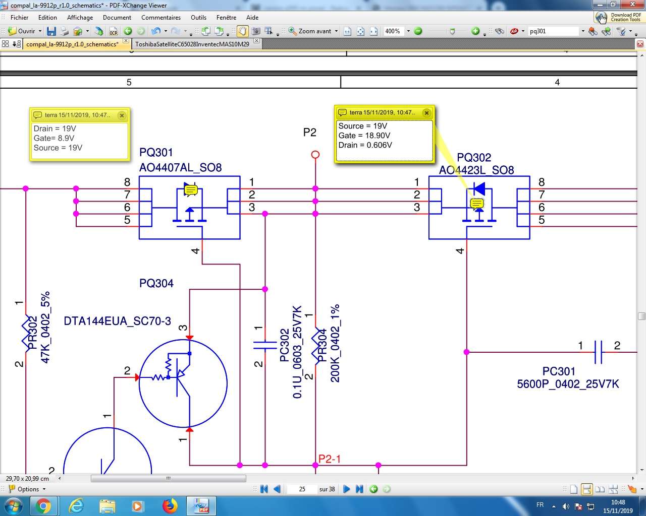

    Your charger is faulty or PQ301 /302 short ,you should get +19V on PF101 inject +19V on PL101 and see if the 1st Fet is switching voltage on S D G?

        Put the multimeter continuity test mode test S G short or not
        Change the 2nd Fet it’s short Gate Voltage is to high most probably short Between S G

          Measurements are wrong, both gate are tied together, they cannot have a different voltage.
          It'd rather be first MOSFET shorted, but cannot tell without exact measurements.

            Agreed but going by the measurement of 1st mosfet, if that's correct, problem may lie elsewere.

              Re: Lenovo g505 no power
              Back again..thank for your help...i change both mosfet ( Pq301 Pq302) same issue.
              Resolder the origional mosfet ( tested no short between S and G ) and i inject 19v at the drain of Pq 301 and find 19 V at PR301, push the power button and the laptop works .
              i re-connect the cable at JDCIN1 and with power supply i find only 0.890v at PR301.
              What to shek else !!
