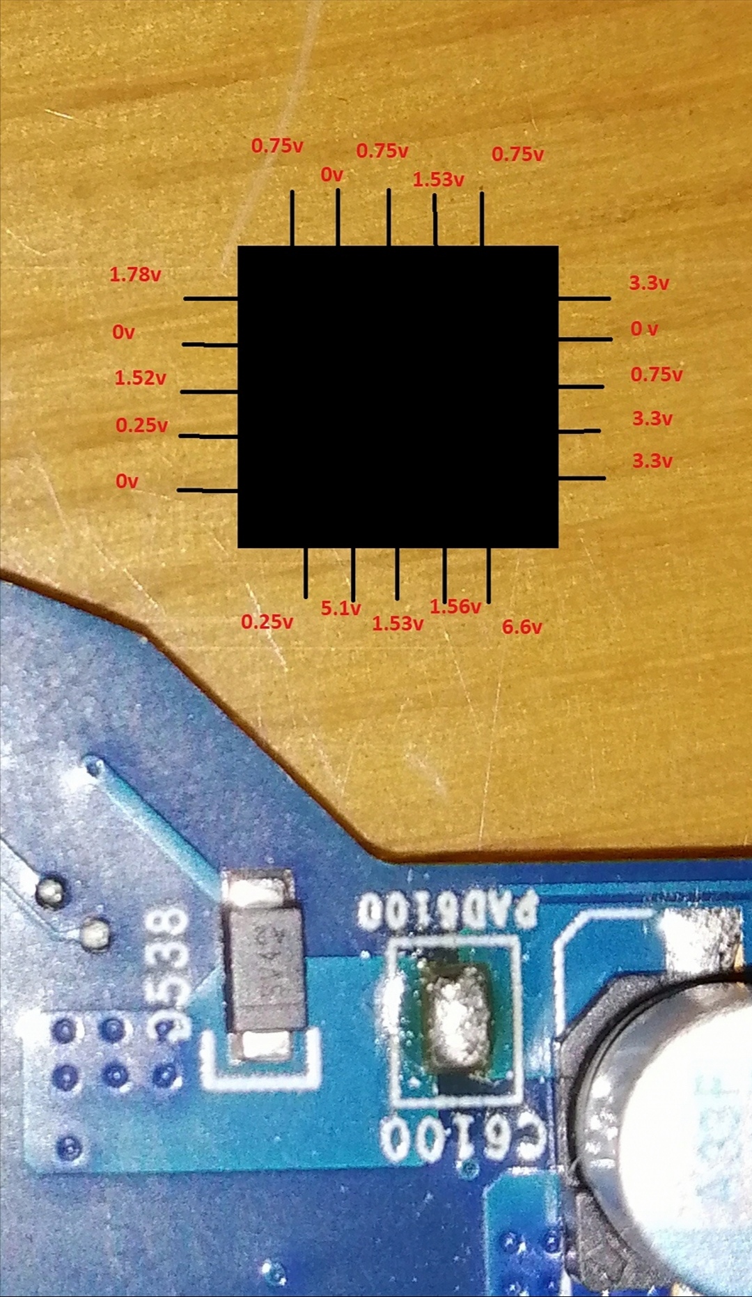

    pin 1 - 0v but pin 2 - 0.8v
    pin 126 - 0.79
    pin 199 - 0.8v
    pin 203 - 0v
    pin 204 - 0.76v
    pin 75 - 0v bu 76 - 0.79v
    is the Schematic i have send doe's mach page 25 because voltage's are not correct

            the RAM slot voltage must be
            pin 126 - 0.75V pin 1 0.75V
            pin 199 - 3.3V
            pin 203 - 0.75V
            pin 204 - 0.75v
            pin 75 - 1.5V
            trace back missing voltage's and check out page 15 of Schematic make sure all the voltage's are ok

              I have 0v on pin 1, pin 203 and pin 75
              On pin 199 i have 0.75V
              Pin 126 and pin 204 are ok
              Also tried onother CPU but the same problem
              And 0.75v on pin 199

                          Can you measure voltage on all pins of U6200(TPS51216) and post here??
                          • dmmitrevski
                            • Nov 2019
                            • 40
                            • North Macedonia
                            #53
                            Re: Compaq CQ58-d33SZ Caps Lock blink 3 times
                            Yes i measured them
                            Here it is
                            https://ibb.co/5WtqYHv

                              The measurements are not visbile clearly after zooming in on pic. better you write here pin voltages.
                              • dmmitrevski
                                • Nov 2019
                                • 40
                                • North Macedonia
                                #55
                                Try now
                                I do not know the exact pin number layout
