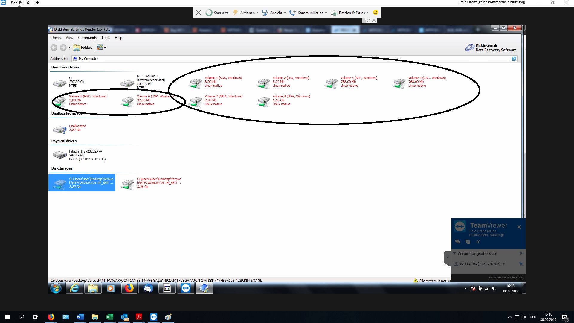

      Hello thnx for reply , i should update the case.....
      ive seen there is a difference between that 2 Mmc, one is 8 the other 64GB

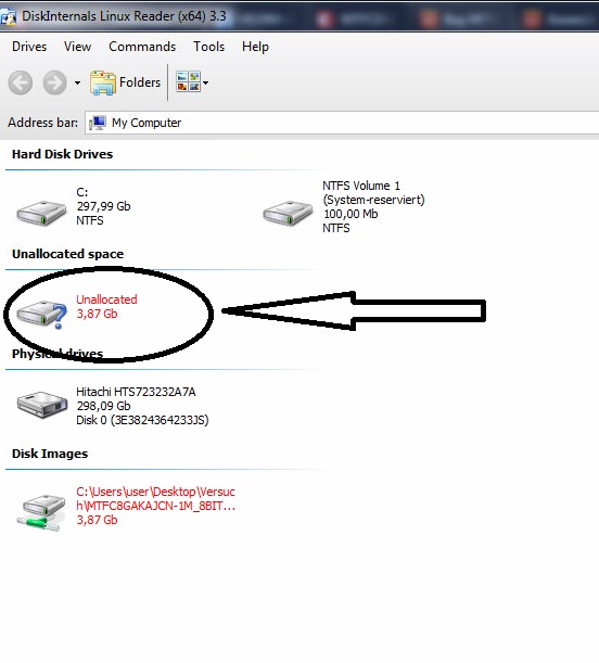

      I have now another problem, when i desolder the JY995 (8GB MMC) and try to backup it with the RT809H programmer the software and partitions on the JY995 are destroyed and i cant make a backup(see pic 1).....
      Normally the software is linux based and there should be some partitions like on (pic 2)
      Can somebody tell me another option without killing the mmc ?
