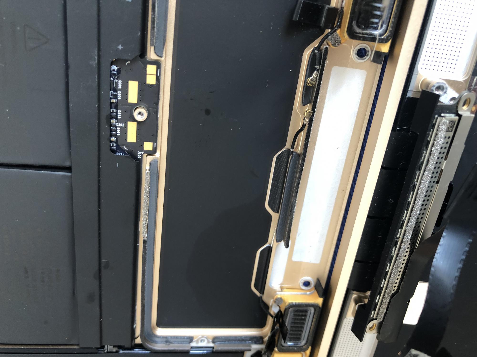

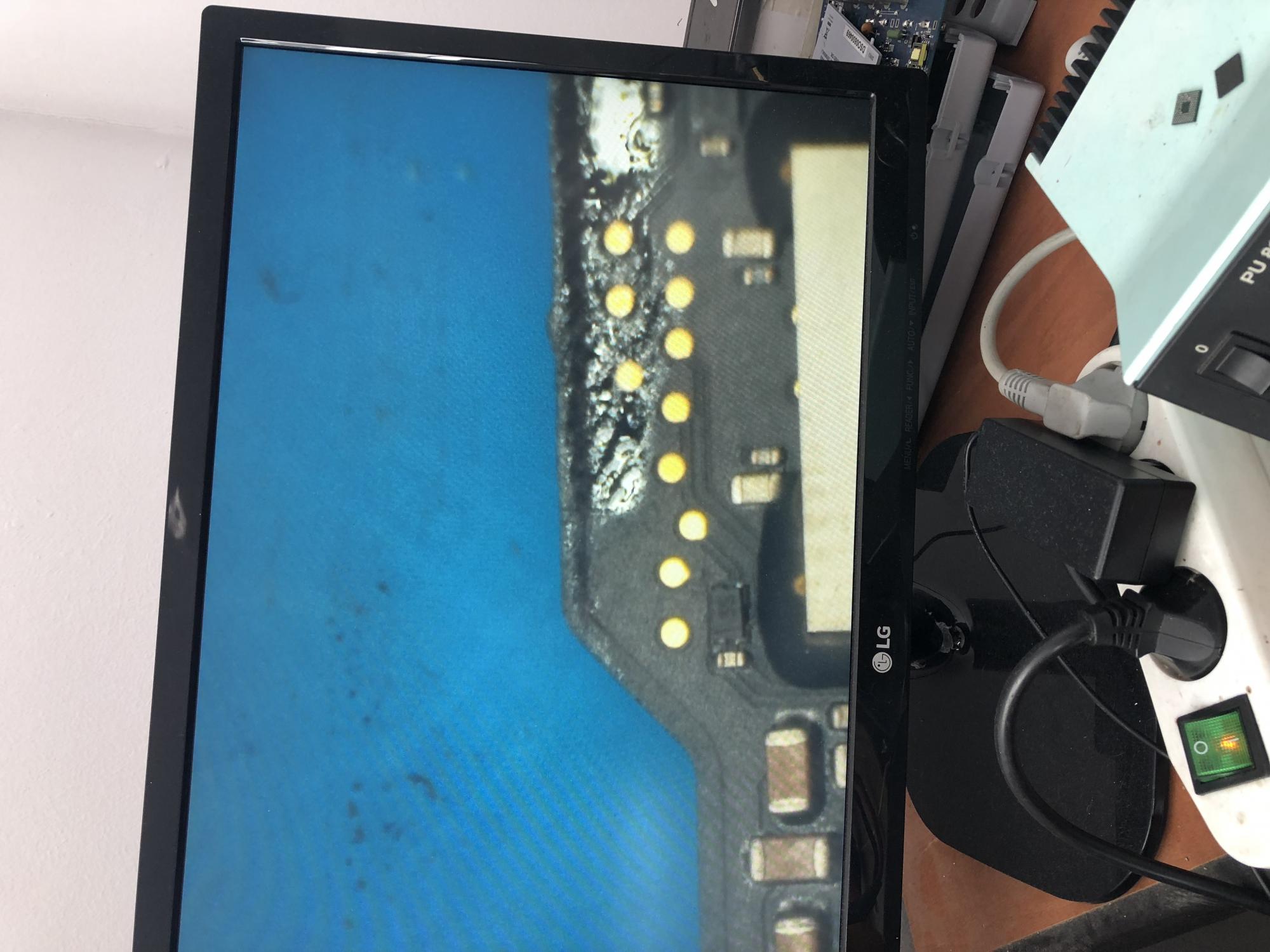

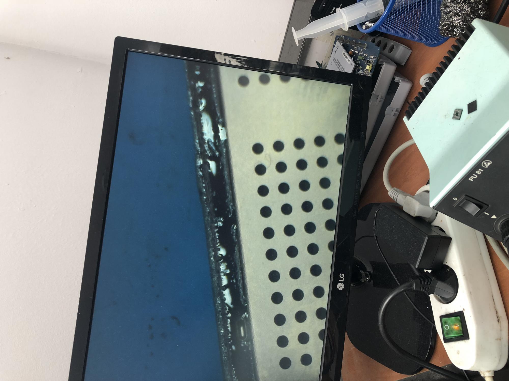

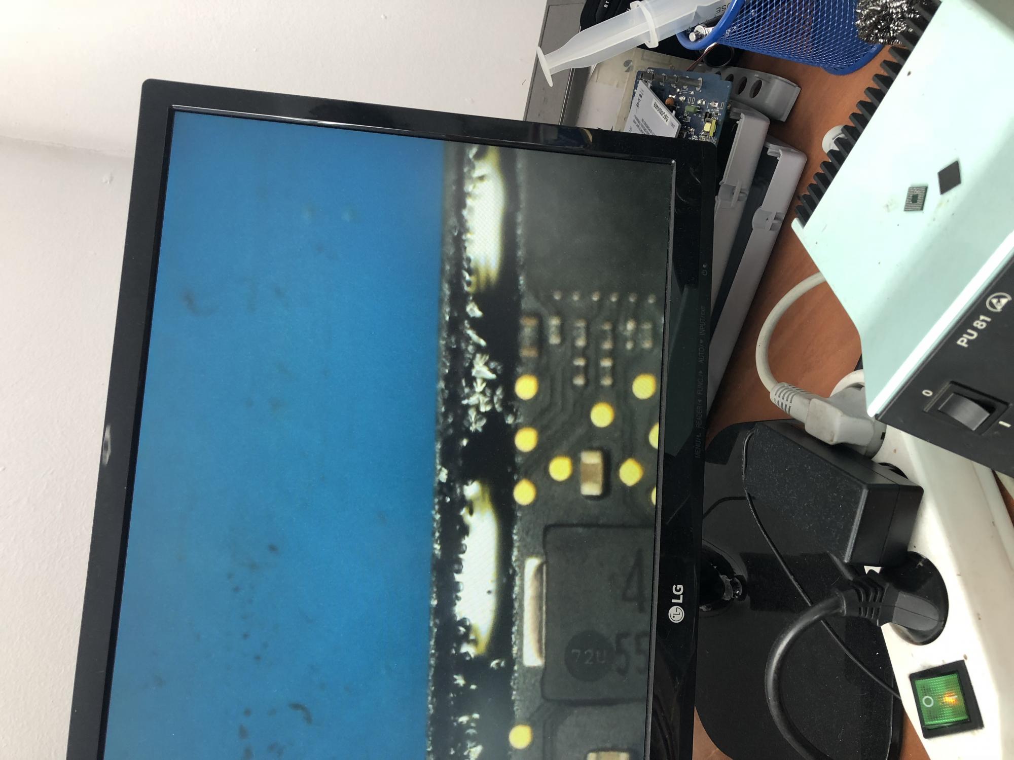

          • justin35
            • Jan 2019
            • 149
            • It
            Re: Macbook 12 in a1534 (2016)no power - need help
            What is correct voltage and aperage drawn by a good working board?
            Should it be 20v or 14.7v on the usbc meter?
            Ps: i attached some pictures of the motherboard i pulled out... looks like liquid damage on the back all the way arround the edges...
            • KvnTM
              • May 2018
              • 434
              It kinda does look like water damage. Is there no corrosion on the board?
              USB-C Should jump from 5v to around 20v.
              Check U4700. This chip is a common failure point of this macbook.
              EDIT: Are you sure that it doesn't turn on? There is no chime or power led on these machines. Maybe the backlight is dead. Shine a flashlight on the screen and take a look. Also does it react to caps lock? Not sure but I think these still have the little green led inside the key.
                  Well after cleaning the board with alcohol the machine works.
                  It takes 14.7v and reaches 0.8-0.9amps
                  But i ran into different problems...
                  It shows 0% battery after 5seconds you plug in the charger...also it plays iphone charger detection sound.
                  And it doesn’t see internal hard drive (question mark folder)
                  As far as i saw on google no ssd means dead cpu???
                  Thanks again everyone!!!
                  EDIT:
                  Now The green led on pcb is on when i plug in charger.
                  Board is 820-00045a
                  • KvnTM
                    • May 2018
                    • 434
                    Originally posted by piernov
                    A1534 will work on 14.5V from the USB-C charger.
                    U4700 is on the 2015 model (820-00045), not the 2016 model (820-00244).
                    From the "Then 14.3v and 0.55 amps and it remains like this." statement, this does turn on and even CPU VCore is present. But most likely not POSTing.
                    Thanks for correcting me on that one
                    EDIT:
                    Board is 820-00045a
                    Do you have access to an ultrasonic cleaner? Maybe there is some nasty stuff under a chip.
                    Since you don't only have problems with the SSD there might be something else.
