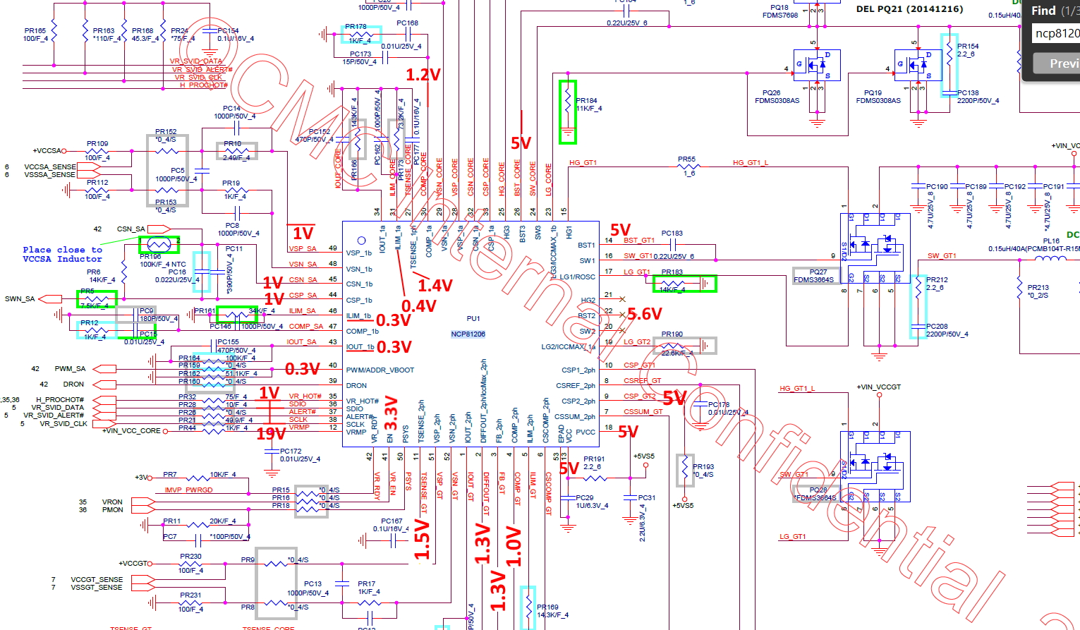

    After a lot of research (Oiginal PID is missing) I find the correct Bios, now all voltage seem corrects but
    the cpu voltages +VCCGT -> 0V +VCORE -> 0V are missing. I change two times the NPC81206 with no luck. All related
    mosfet are functional (I desolder and test)
    On NCP81206 seem that VR_SVID_CLK# = SCLK has 1V but not correctly clock wave
    POWER UP SEQUENCE
    PLTRST# -> 3.3V
    EC_PWROK -> 3.3V
    IMVP_PWRGD -> 3.2V
    +VCCGT -> 0V
    +VCORE -> 0V
    VRON -> 3.3V
    HWPG -> 3.2V
    +1.0V -> OK
    +3V +5V +0.65V_DDR_VTT -> OK
    MAINON -> 3.3V
    +VCCSTPLL ->
    +3VSUS -> OK
    +1.35VSUS -> OK
    SUS_ON -> 3.3V
    RSMRST# -> 3.3V
    +1.0V_DEEP_SUS -> OK
    +1.8V_DEEP_SUS -> OK
    +3V_DEEP_SUS -> +3VSPI -> OK
    SLP_SUS_ON -> 3.3V
    PWR_BTN -> 3.3V
    +5VS5 -> OK
    +3VS5 -> OK
    S5_ON -> 3.3V
    RTC_RST# -> OK
    SRTC_RST# -> OK
    +3V_RTC -> OK
    ITE MAIN SIGNAL
    3 SUSWARN#_EC -> 3.3V
    20 EC_POWEROK -> 3.3V
    33 MAINON -> 3.3V
    35 SUSON -> 3.3V
    73 ADAPTER_SEL_EC -> 1.6V
    77 DGPU_PROCHOT# -> 3.3V
    79 EC_PCIE_WAKE# -> 3.3V
    82 SUSACK#_EC -> 3.3V
    83 VRON -> 3.3V
    87 DSWROK_EC -> 3.3V
    89 SLP_SUS_ON -> 3.3V
    90 SLP_SUS#_EC -> 3.3v
    93 CLKRUN# -> 0V
    97 ACIN -> 3.3V
    98 HWPG -> 3.2V
    100 S5_ON 3.3V
    119 RSMRST# -> 3.3V
    123 LID_EC# -> 3.3V
    124 H_PROCHOT#_EC 0
    128 5VS5_ON -> 3.3V

    maybe the CPU is defective. Do you know what had happened to this CPU in the past?

      SOC likely to be bad.

        I can't find the wrong signal, now with these cards we would need a jtag debugger.

            As far as I know, JTag works only when CPU has power. Then, we can test CPU through JTag-based testing protocols. when CPU has no power, it does not generate any JTag output. Therefore, Jtag is not useful for power-lack problems. However, it may be used for power management/consumption problems.

              Yes indeed, you are right. I thought there was a possibility of using an external supply.
              Regarding this post, I think the problem is that on pin 38 VR_SVID_CLK there should be 1 volt with clock signal but instead I only detect 1V in DC.
              I think this signal comes directly from the pch .

                  I think you should measure voltage on pins 23 to 34 of NCP81206 . what is voltage on PL0004?
