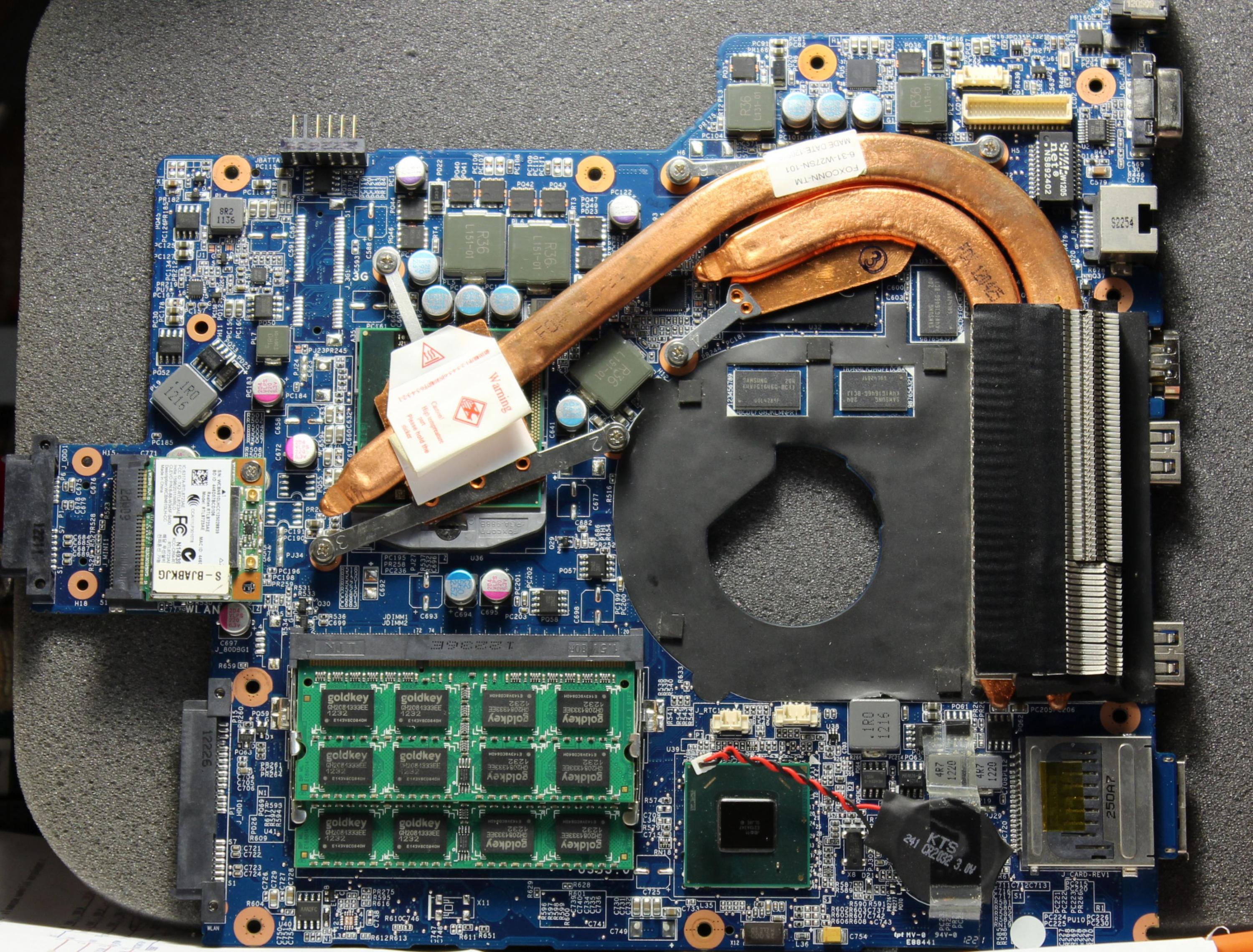

    I have this laptop Clevo and after 5s is shut down . Vga nvidia Motherboard photo .pls help is more urgent
    • 20299
    Re: Clevo W270EN
    What tests have you done so far .

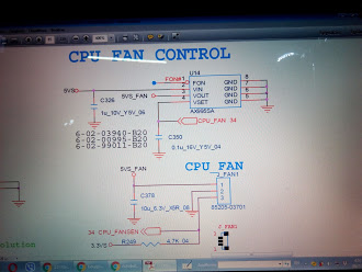

      Hi i have measure in the chip fan controll and i have see this Vin 3,6 v . Pin 1 in the Pin 2 5v Vin Pin3 output for fan 0v and fan not work.And pin 4 Vset nothing , I can find the CPU_FAN 34 Did know anybody where is going out ??? i Have do the fan to work but the laptop going again shut down
