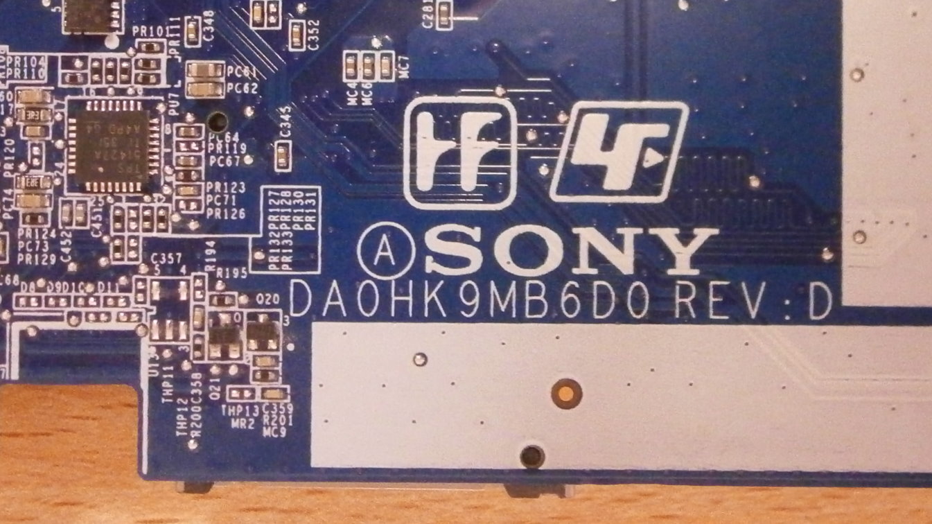

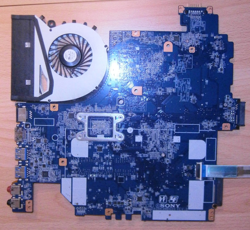

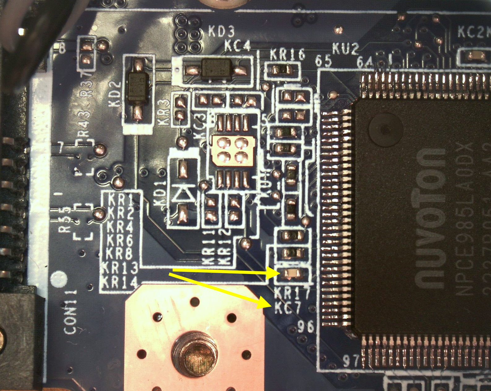

    Sony Vaio SVF1521B4E- Keyboard controller NPCE985LLA0DX
    Laptop: Sony Vaio
    Model: SVF152C29M
    Product name: SVF1521B4E
    BIOS Chip: Winbond 25Q64FVSIG
    Motherboard: DA0HK9MB6D0 REV: D
    The problem:
    - The keyboard and the touchpad are not working at all anymore.
    - Please advise what and how I shall investigate.
    Steps done so far:
    - I have replaced the keyboard with a new one, but the problem is the same.
    - I have re-flashed the BIOS with different .bin images from net using a CH341A programmer using next guide, but the problem is the same: https://www.bios-mods.com/forum/Thre...41A-programmer
    I cannot enter in BIOS, only by chance and only using external USB keyboard + USB mouse, but I can boot from USB drive/stick.
    I can boot only Linux flavors as Ubuntu, but it does not work with Windows live CD or Windows installation/repair – it just boots and stays blocked in a infinite loop and never starts Windows. Linux works fine, but not Knoppix. It may be that Windows and Knoppix require certain basic hardware as keyboard and touch pad to be present, but I do not know for sure.

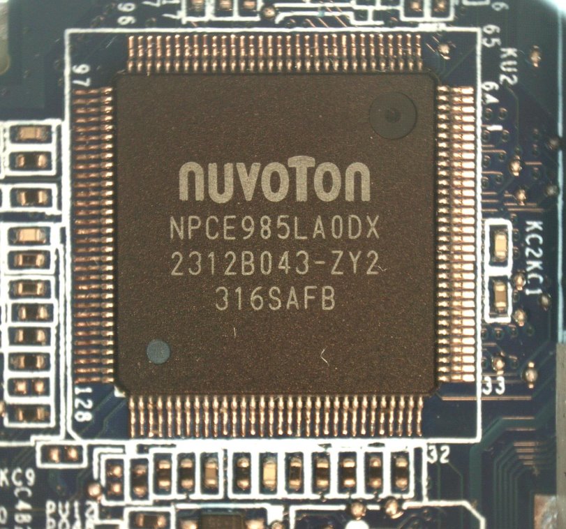

    I tend to believe is hardware failure on motherboard, more exactly the keyboard controller.

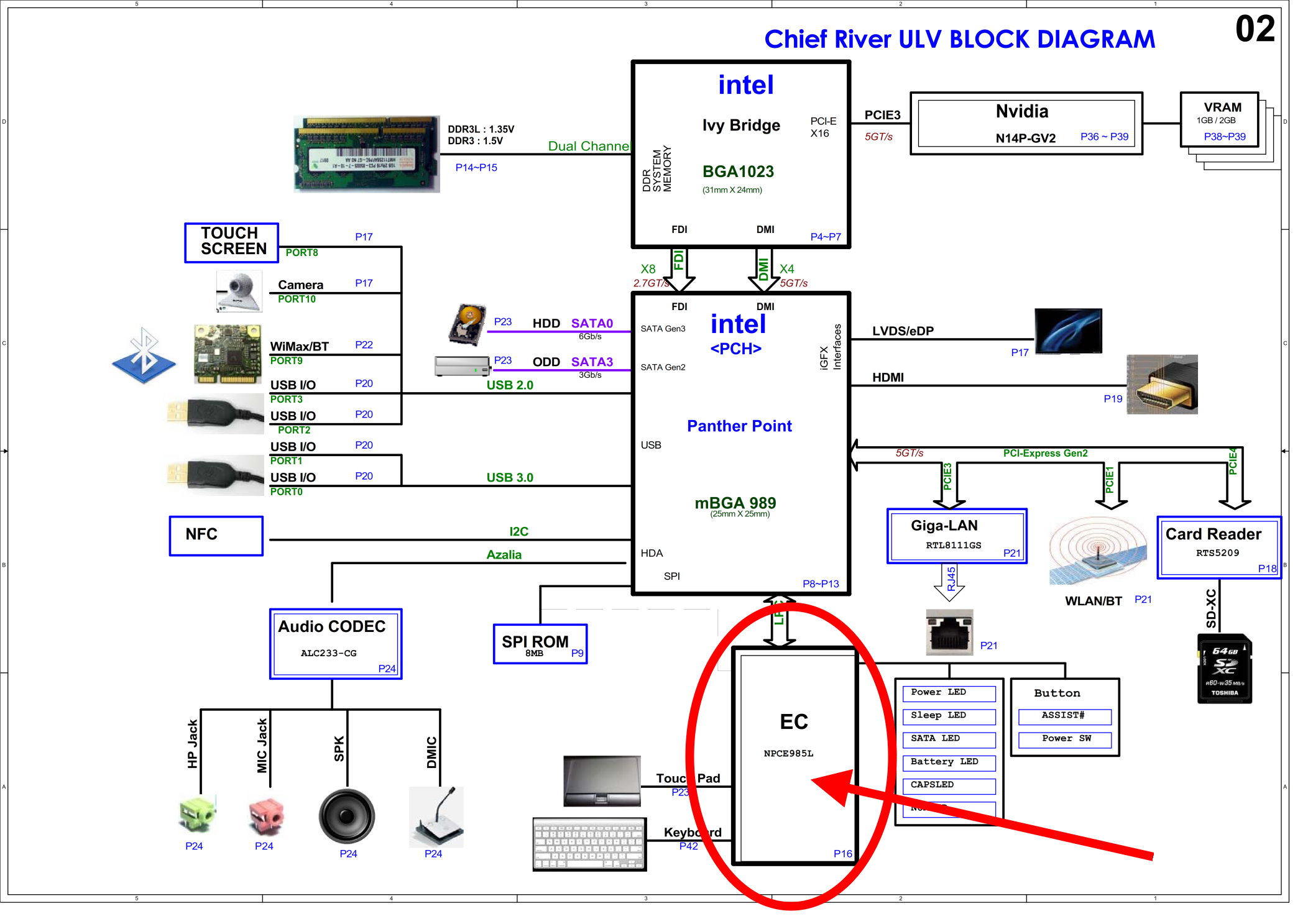

    I found the schematic of the notebook (part of it) on internet.
    I identified it as Nuvoton NPCE985LLA0DX.
    Questions:
    1) Assuming I will be able to replace the Nuvoton NPCE985LLA0DX part, can someone tell me if this component needs programming or do I just buy it new and replace the existing one?
    2) If NPCE985LLA0DX requires programming, then with what programmer do I have to program it and from where do I take the code/image to program it?
    3) Do you have any other suggestions how to debug/analyze or what to search, before I jump into NPCE985LLA0DX replacement?
    Attached are the photos with the motherboard and the keyboard + touchpad controller.

    Re: Sony Vaio SVF1521B4E- Keyboard controller NPCE985LLA0DX
    Hi
    It is non programmable you can change it direktly
    messure voltage on keyb,Touchpad and check if I/O becomes hot

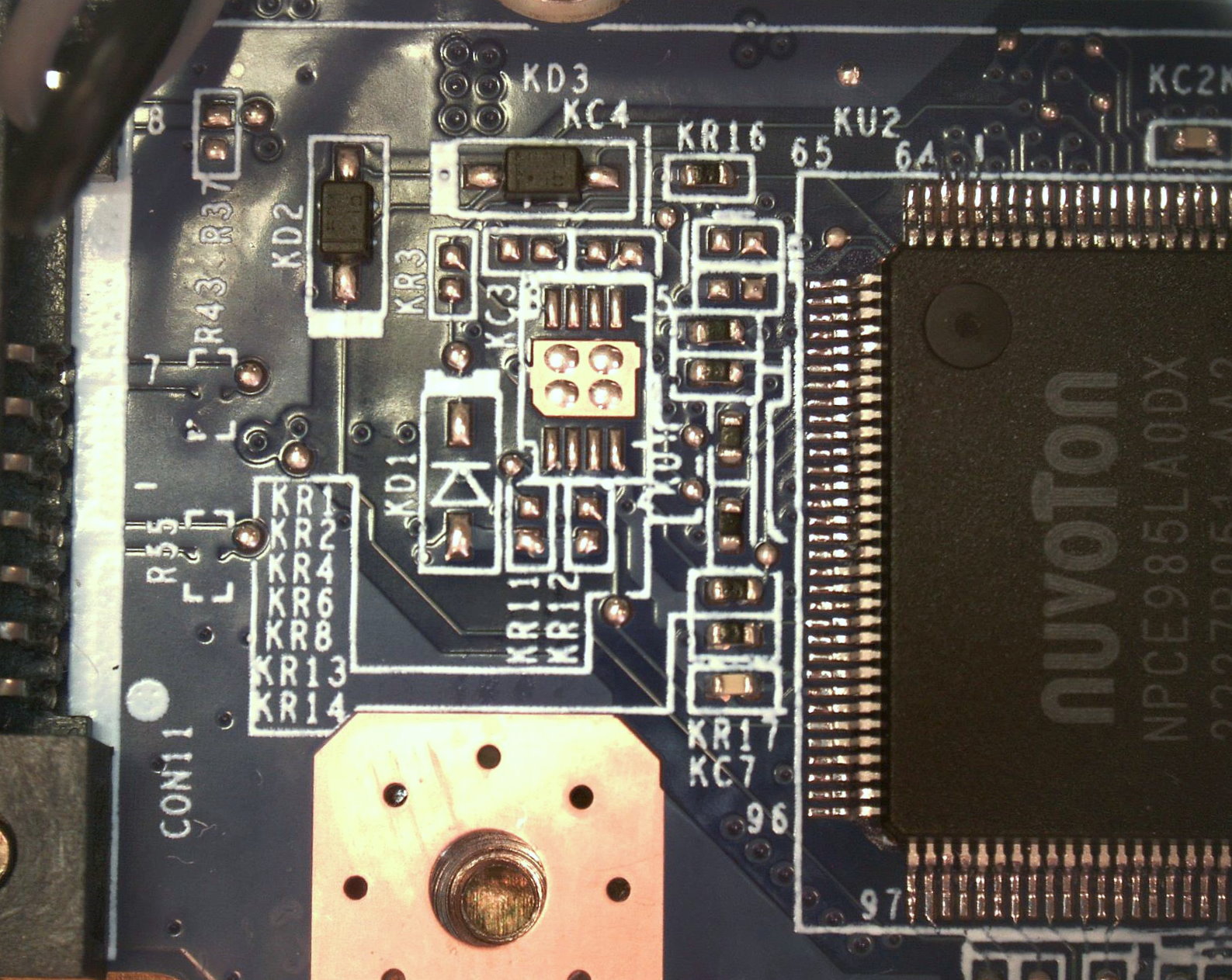

          I have replaced the Keyboard controller NPCE985LLA0DX and the touchpad and keyboard started to work yesterday, but today are not working again.
          I have also installed new keyboard and new touchpad.
          I refuse to believe NPCE985LLA0DX is dead again.
          I rather think is a small component nearby cracked or any other component failed or a PCB trace cracked/destroyed.
          But from yesterday until today ?...
          I cannot enter in BIOS. Of course if the keyboard and touchpad are not detected, then i cannot enter in BIOS. The BIOS was re-flashed several times, but I think is fine. The fact that I cannot enter in BIOS is just a consequence that the keyboard and touchpad are not detected.
          How do I debug now the NPCE985LLA0DX or/and the components nearby?
          I have 3V at VCC of the controller.
          The LED for CAPS Look adn NUM Look are ON all the time when I boot the laptop.
          Yesterday I noticed that at boot moment also the Keyboard LEDs (light) came on, but today not anymore, are shut off.

            Check if all pins are solder properly, sometime a pin seem to be solder well but only in apparence.

              I have used a USB microscope to check the pins for soldering problems and possible short-circuits.
              I checked that again and again during and after soldering process and I made also photos.
              Maybe is not the best soldering, but it seems good enough to me:
              https://tinyurl.com/yxjyexwn
              If some small particles can be seen, those are not soldering remains, but some hair/fiber from a brush that I used to clean the pins/PCB together with dedicated PCB spray cleaner.
              It worked fine for 2-3 hours during the day I soldered the new chip and next day the keyboard and touchpad are again not recognized.
              It must be something else.
              I do not exclude the possibility that the chip failed again, but then there is a cause that makes that chip defective and I do not know now how to diagnose it.

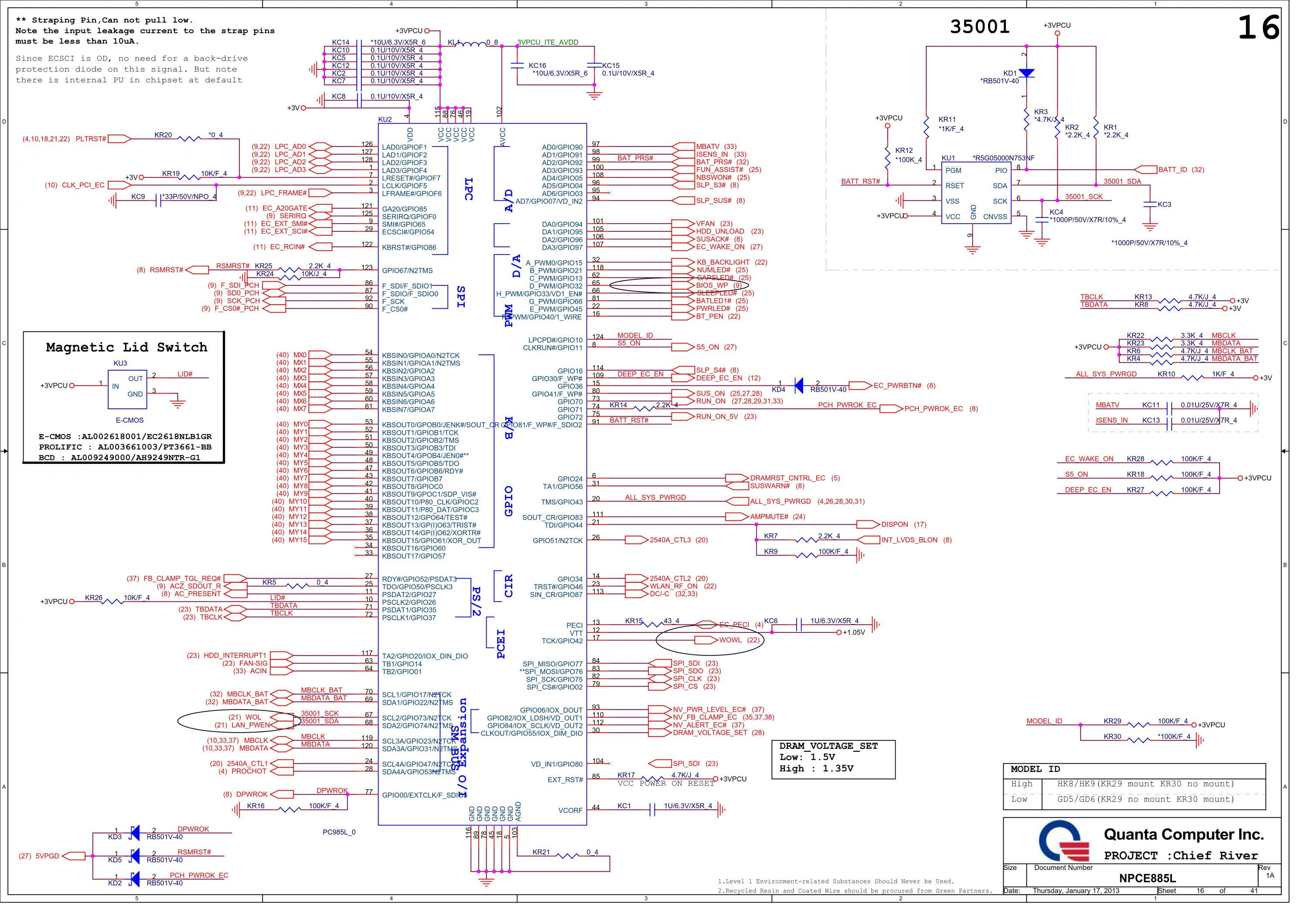

                Dell 14 3474 5437 Essentials Oak 14 DOE40_12314 DDR3L_A00_0603
                Use this schematic. It uses npce985 as kbc.
                • viki2000
                  • Jun 2019
                  • 12
                  The schematic is not a problem.
                  I have found a closer version than the proposed Dell.
                  Attached is the SONY VAIO SVF1521DSGW DA0HK9MB6D0 REV. D.
                  The problem is to know the right/proper values of the signals at the pins of the NPCE985LA0DX chip. A datasheet would help a lot for that.

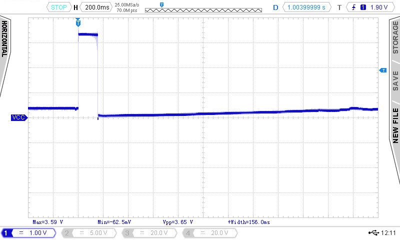

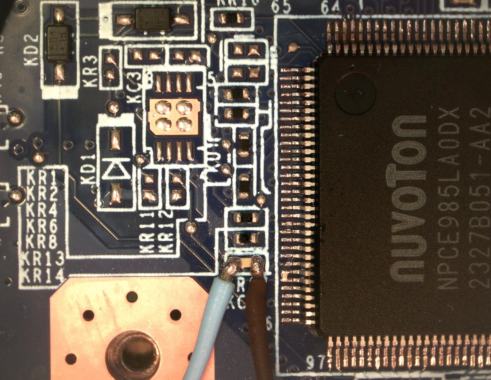

                            I will measure/record the VCC 3Vdc at the NPCE985LA0DX pins during power on moment using an DSO and come back here with the results.

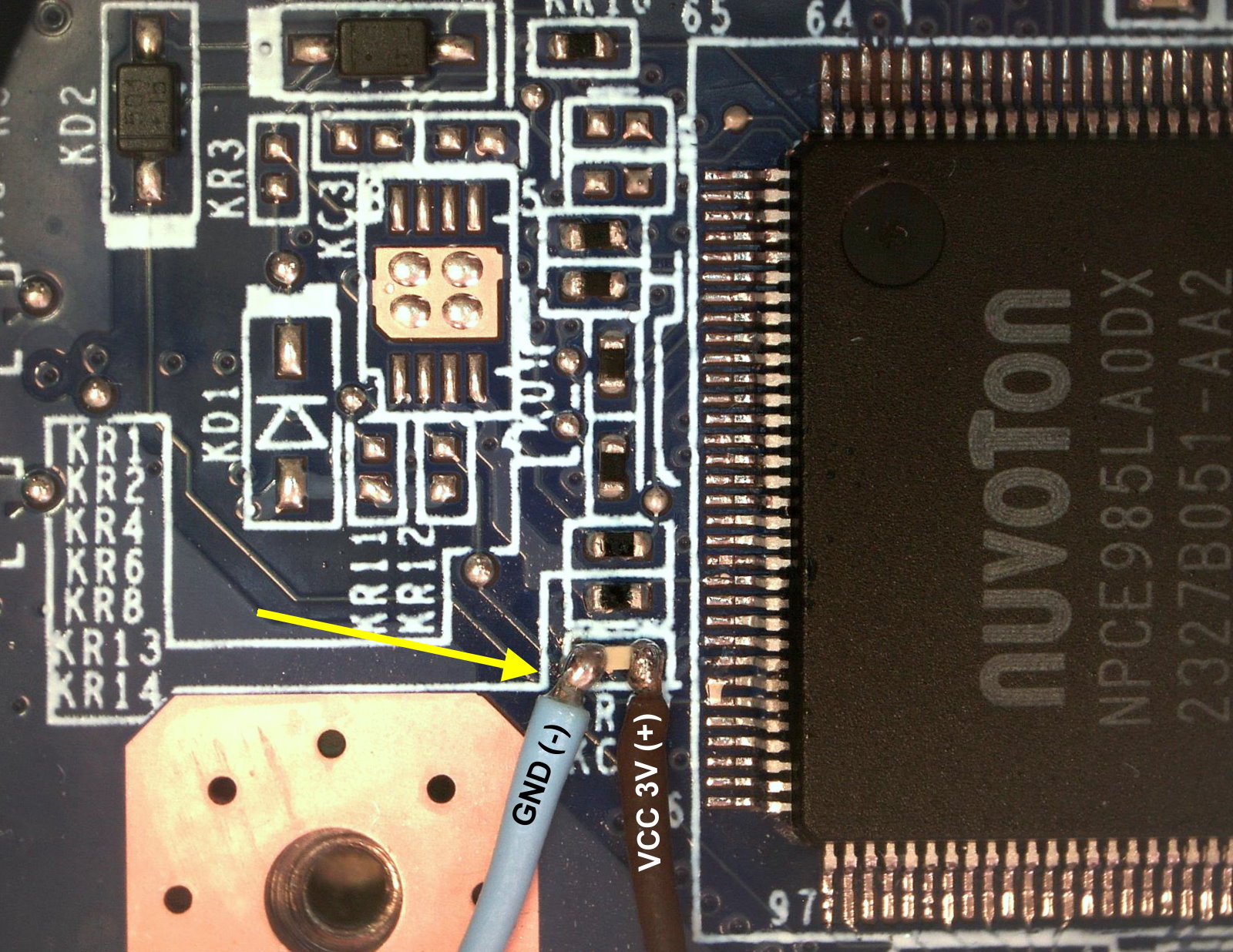

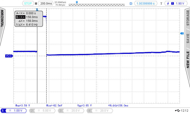

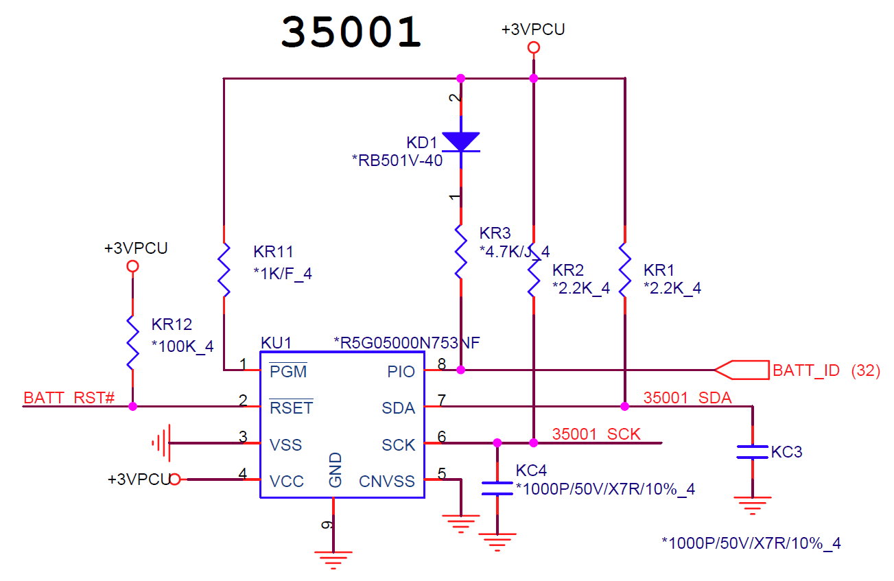

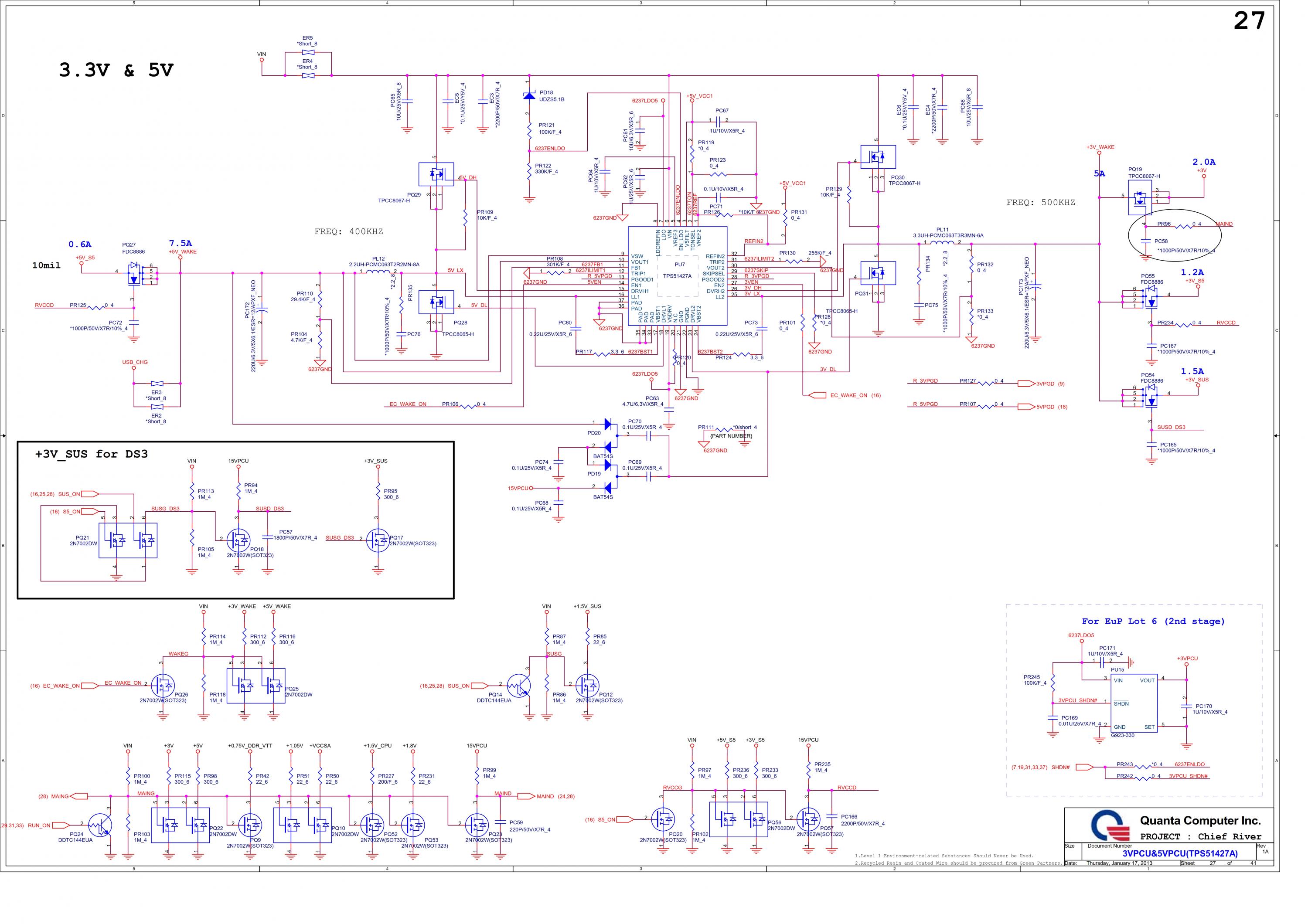

                                I have measured the VCC 3V at startup on KC7 capacitor and was 3.6V, I guess too much.
                                In my case the KU1 integrated circuit is not installed.
                                The voltages come from the section/page 3.3V & 5V, the PU7 TPS51427A.
                                I think I made one fatal mistake. I have used single ended oscilloscope probe and I think it should have been differential probe or floating DSO with an isolation transformer.
                                After the measurement, there was no more voltage across KC7 anymore, no matter what I have tried. I guess more components failed.
                                https://tinyurl.com/y6b475hj
                                But I will check also what Francisco suggested on SPI bus.
                                Maybe you can help with a tip: what kind of test clip do you use for such a small IC as NPCE985LA0DX?
                                It is QFP128 package with 0.65mm Pitch.
