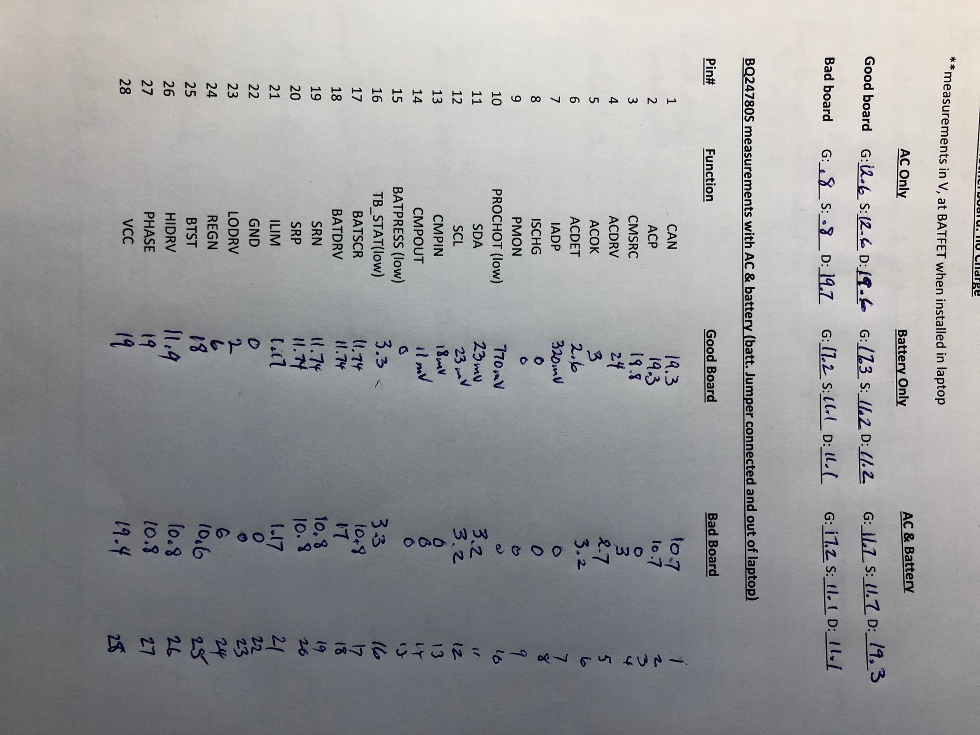

                              Re: asus x451UA no ACOK
                              Did some more measurements and have attached results. I think one of the issues is that the ACFET/RBFET are not turning on when the adapter and battery are in (CMSRC and ACDRV not up in voltage). It does turn on if only the AC adapter is in, so that is weird. The other weird thing is the power and charge LEDs act the same between the good and bad board, which I would have thought shouldn't be the case.
                              Anyhow, I need to figure out why the input FETs are not turning on when the battery and ac adapter are in, but do if only the ac adapter. It appears that the BATFET doesn't turn off when the adapter is inserted as the BATDRV voltage is still 6V above BATSCR
                              Sorry about the attachment. It seems to want to rotate the image when its uploaded.
                                Things that seem out of order:
                                ACDET 3.2V - too high, it is a simple voltage divider - something not correct there - it's value does not depend on charger - check the resistors.
                                SDA & SCL should be pulled high to 3V, communication on the line does not pull the voltage so low.
                                • brew99
                                  • Jan 2019
                                  • 132
                                  I think I transposed the values for ACDET and ACKOK. I'm almost certain that I have 2.7 on ACDET (@ work so can't check right now).
                                  I do have 3.2V on data and clock on the bad board, but the good board shows mV (or I measured wrong), so not sure about that.
                                  At this point I'm going to try replacing the BQ again and see what I get

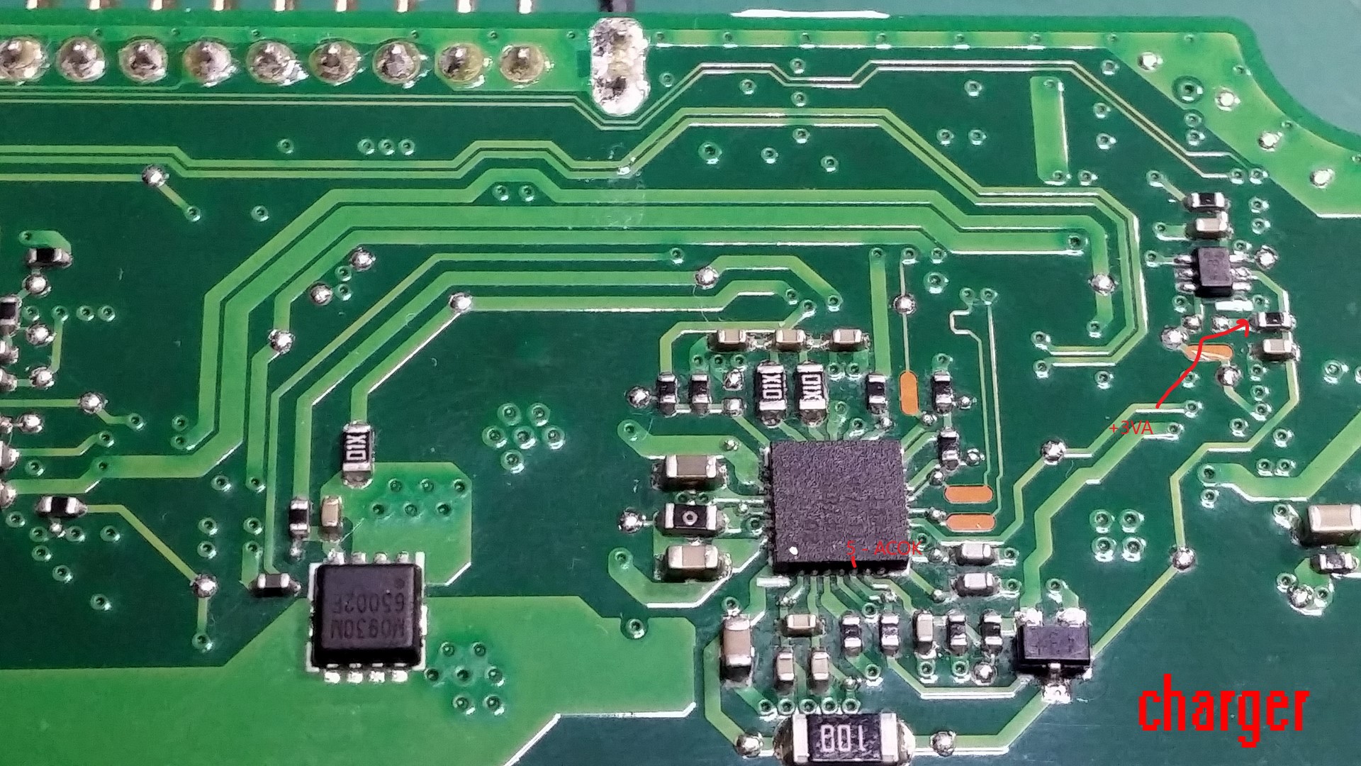

                                    I'm still fighting with this board......It's now at a point where it works on Batt or AC adapter, but when both are active, I get no charging of the batt, and also the CPU is limited (multiplier drops to min x4, according to CPU-Z software). Also when only on batt., there is a hissing sound (kind of like a transformer whine).
                                    One thing I have noticed is the BATDRV voltage is not +6V from the BATSRC (12V). It is only about 12.2V, when on Battery (assuming it is not fully turned on). I've changed the charging IC twice and BATFET, with the same results. 4.02Kohm res. from BATDRV checks ok. Assuming that the charge pump of the BATDRV is being pulled down and not allowing full +6V from the SRC.
                                    Anyone have any idea at what to look at next?
                                      I finally got this thing to work!!! I apparently do not know how to properly solder a QFN IC, as I tried replacing the charger IC again (I've soldered/unsoldered this about 20 times), and this time it worked. Man, I'm learning so much about how this IC can cause so many different issues.
                                      On to the next one (it has shorts in rails)
                                        Learning through experience is sometimes time consuming.
                                        Good microscope should be of help in these cases.
                                        Good work!
