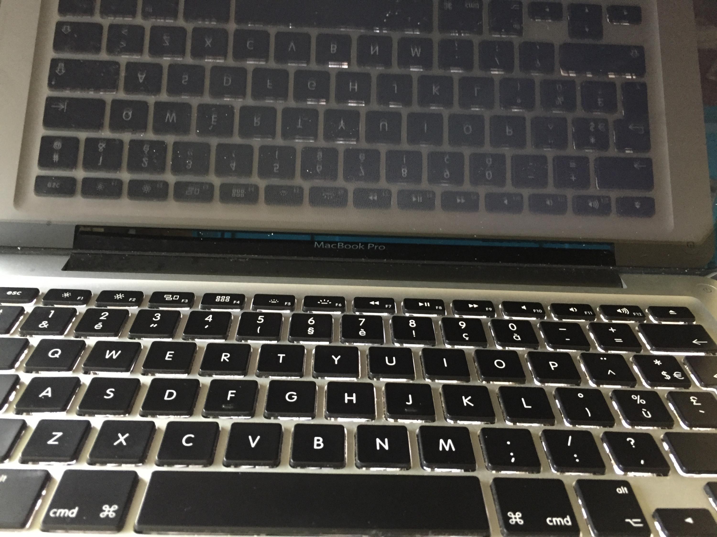

    This is the first time to repair mac book, I need help on this to guide me to repair this please. This is MAC BOOK PRO A1278 EMC2554, the problem is pressing power button i heard the chime sounds and there is light on the screen but no picture, i tested both screen and flex to another mac screen is ok.can anyone help me guide to repair this please thanks in advance

    test lcd power. i think u r missing 3.3v power for it. check schematic

          thanks i check on lvds connector PP3V3_LCDVDD on pin2 and pin 3 no voltage. where to check next please

            look at the schematic where it comes from, i supose there is switching mosfet

                            u9000 is actually that switch. check its input and output, ON signal

                                      Screen needs to be recognized in order to get power on pin 2/3. It gets recognized from the DDC bus, on pins 6 and 7. DDC is powered on pin 4.
                                      Basically, you need 3.3V on pin 4 before anything.
                                      You need the LCD to be plugged in to measure voltage on the connector.
                                      Check for liquid around LCD connector and make sure it's not damaged.

                                        i measured the voltage with lcd plugged in
