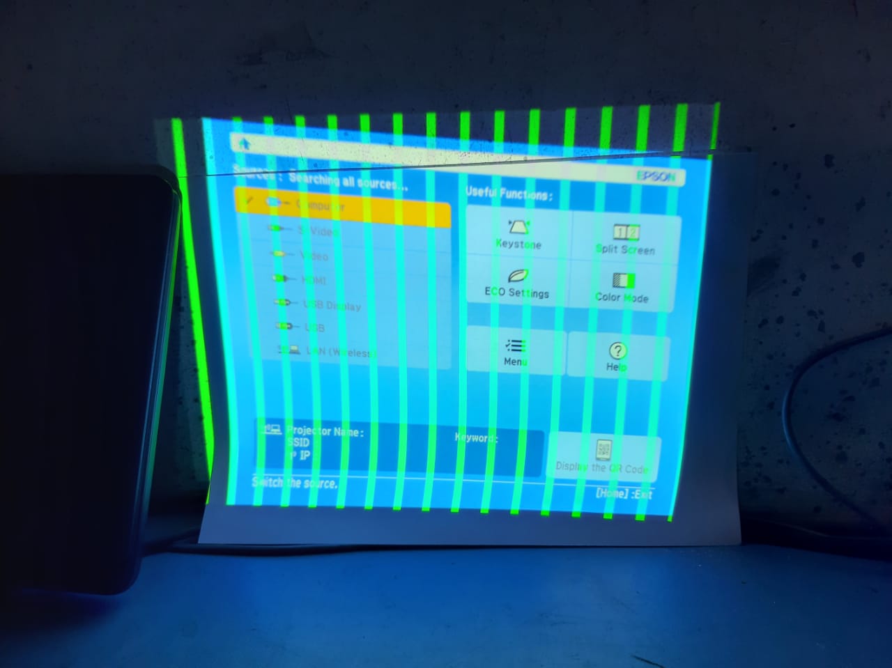

    I'm having problem with display on this projector. There are vertical lines on display. I've opened it and cleaned it, cables are all clean and not broken. This model has 3 separate cables for blue,green and red.
    Does anyone knows about the cause of the problem or solution. I dont have much experience in projectors

    Pic of problem

        Thanks smdflea for replying but its not a scanner. How do i calibrate it. i have checked all the settings in menu and even reset all but in vain.
        as per some information on net, it is connectivity issue between logic board and lens unit(In this case it is through 3 different cables viz red,blue,green, -all of which seems to be ok.

            Maybe try unhooking the flex Cable for the green LCD and see if the lines go away ? It looks more like a processing failure to me though...

              yes, firmware update didnt solved it. I tried unhooking cables one at a time and the vertical lines go away when blue cable is dis-connected. Are those spares available?? Its relatively a new model.

                Probably would have to harvest one from a broken projector. All three should be identical as they are monochromatic anyway. The real problem is they are aligned at the factory so replacing it is only the start of the battle.
                Besides you would need to be sure the LCD is at fault first. Maybe it is displaying exactly what it is told to display and the fault is farther upstream ?

                  Thanks for replying. I know it is very difficult to align them resulting in shadowy image if not matched perfectly. I dont have similar cable with me. So gave up on this and returned to customer.

                    Sir try To use another optical engine...possible problem is the Optical engine,
