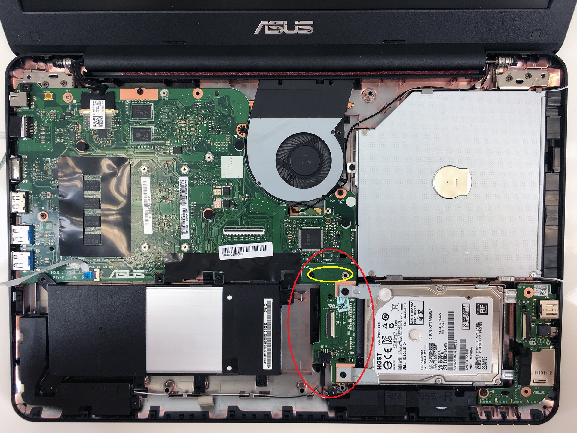

    Hello
    So i have a X555 with no audio device in the device manager do you know where is the audio chip on this board ?
    And what i need to check ?

      Re: Asus X555 no sound
      It could be connection problem. There is extra module that attaches to motherboard. On that module is sound chip. Could be faulty connection, simple clean could fix it.
      I had no sound problem, and cleaning fixed it.
        It is the connection contacts of the disk board, it has to be replaced
            i cleaned contacts, reflowed the audio IC, replaced the audio IC .. and after that i replaced the entire sub-board , the audio is still missing... i think that can be something related to chipset/cpu (sometimes) because the 2 connectors are solid (i've also reworked all the connector pins on the mainboard side .. and looks good at the microscope..the other connector is a brand new.)
            the strange thing is that there are no issues with SSD... CARD READERD... USB PORTS .. that are also placed after this sub-board.
            here some other infos: https://www.badcaps.net/forum/showth...52#post1209352
            and also on this youtube video they solved adding an USB audio card and an amplifier: https://www.youtube.com/watch?v=joOtn6vKZkY

              For those who are looking for a solution for the Sound is not working after replacing Sound chip or Sound card daughter PCB Circuit,
              Try to boot laptop with ubuntu Mint (which can boot from usb drive itself without installing into laptop). Then shut down and again boot with windows. you can see Realtek drivers are installed.
              In my case it was Asus X555LDB laptop running on windows 10 pro 22h2
              Replaced I/O board, HDD driver which has sound card in it and internal speakers.
              I've tried every software solution there is like editing registry, updating Realtek drivers, adding legacy hardware using device manager etc. but nothing worked only this !
