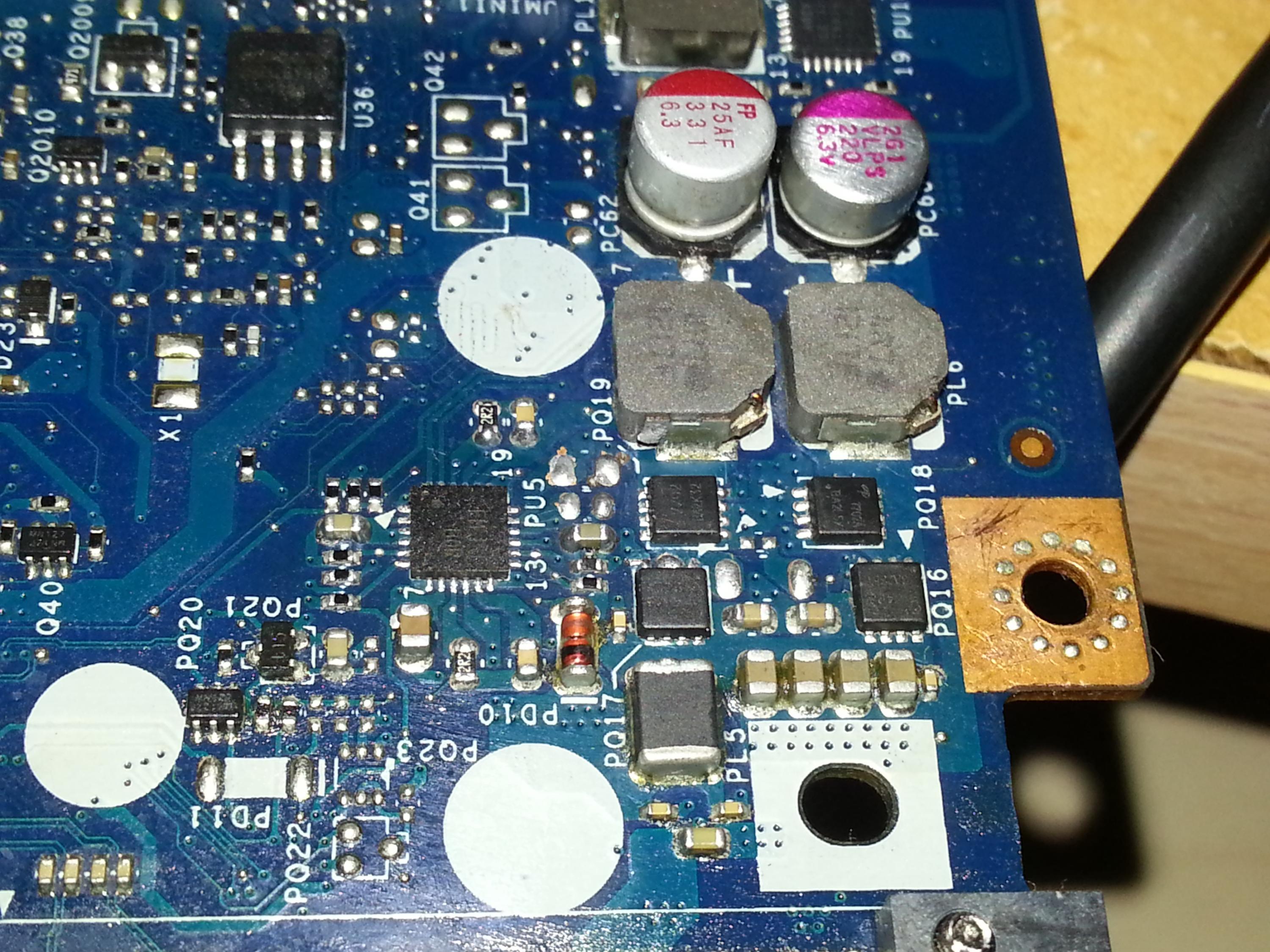

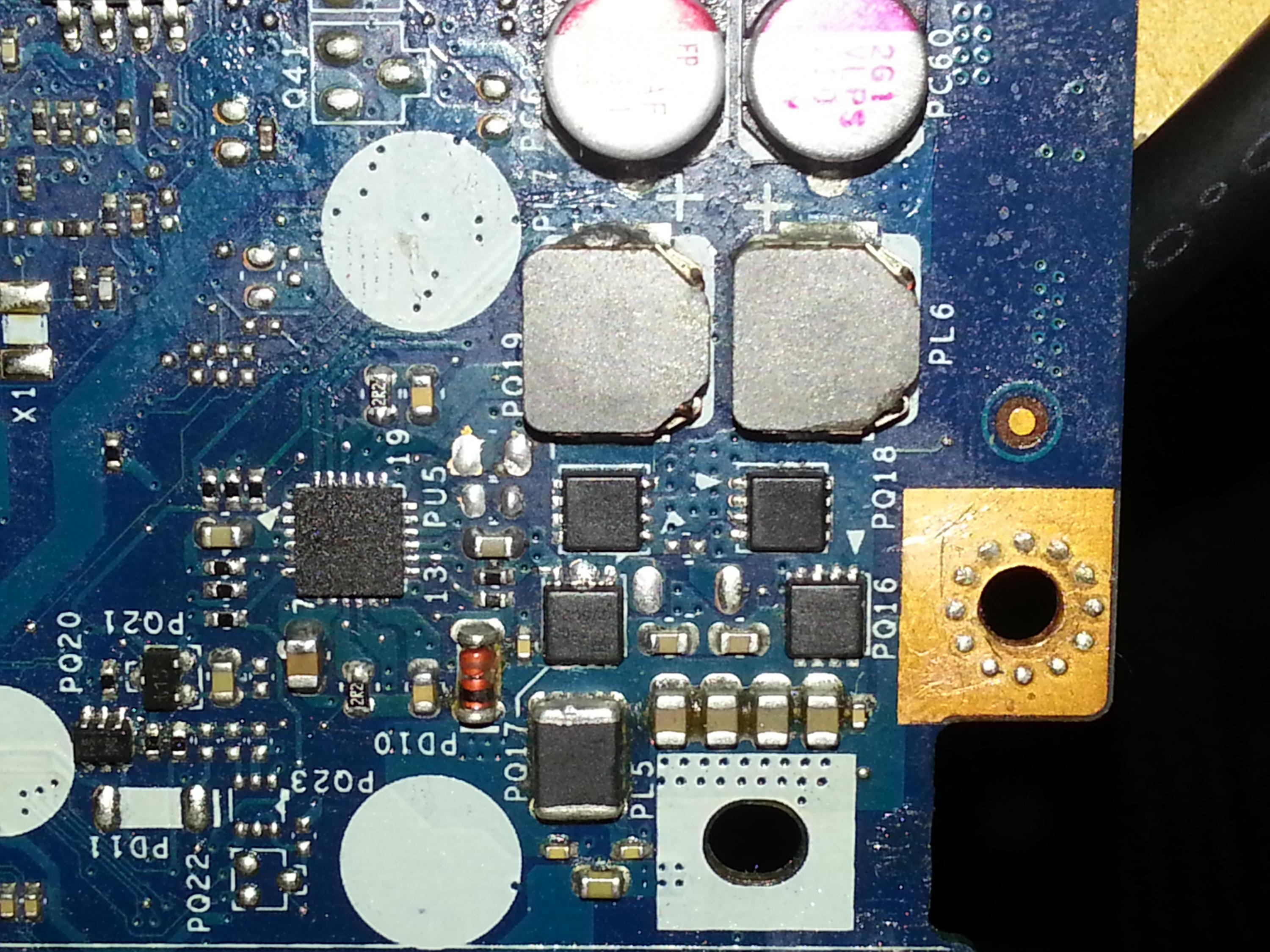

I shall have a look, though I doubt I dislodged anything by accident. Just realized I never actually posted any pics of my actual board, so that should be something worth doing just in case the eagle-eyed spot something I didn't...

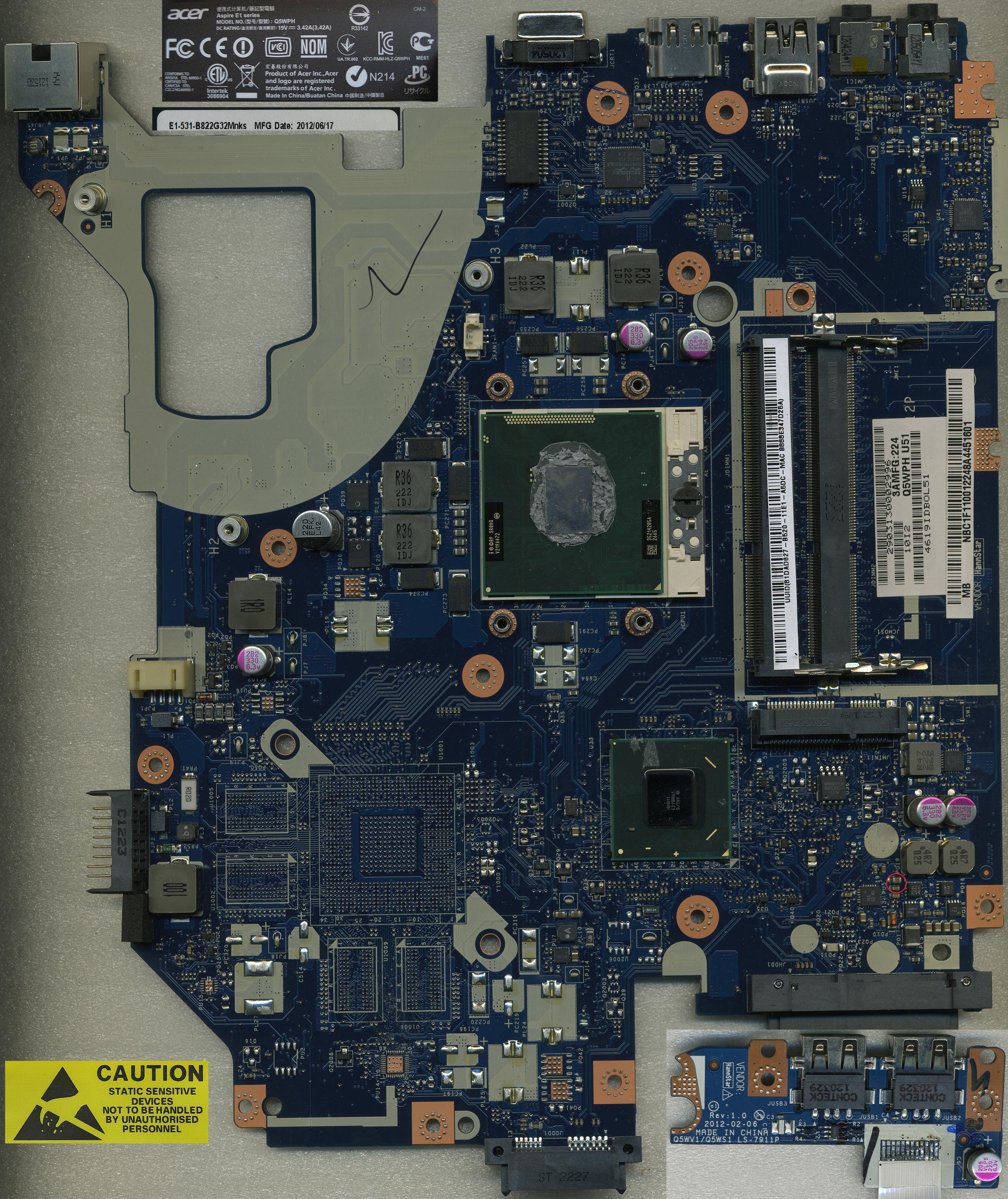

Ok, here we are back on this board. Comparing my board to the hi-res photo, I did notice a couple of caps missing (encircled in red). They are not present on my board because I think they were shorted and I pulled them off. According to the boardview which is sadly not 100% accurate, I think those are PC65 and PC66.
I tried closing in as much as possible on those joints on PU5 with my magnifying visor and some strong lighting, and it looks good to me...maybe not professional, but decent. Same on the 4 FETs...looks messy I know, but I checked with my meter and I do get continuity from the pads to the pins. The pins of the FETs stick out ever so slightly from underneath the device that I was able to, with some very sharp probes, touch the pin and not the pad. I'll probably try touching them up a tad nonetheless. Really sucks not having a scope - that would've instantly told me if PU5 is working...

Alrighty tighty. More to come: I took the gamble and replaced PU5. Using my bench supply limited to 1A just in case, I slowly increased the input voltage to 19v and observed the activity of the 5v and 3.3v rails. This time, much to my amazement, there was something there, but not enough: only around 0.4v on each. I measured around PU5 again and I was no longer getting B+ at all now - it was getting stuck at PQ9 (page 47) for some reason. PU4 which drives PQ9 appeared to be fine: it was getting its 19v on pin 20 via PD6 and nothing was drawing excess current either, yet no B+, so WTH ?!
I botched a piece of wire on B+ to bypass PQ9 and PQ10 entirely and again very slowly increased the voltage: the current increased to 1A rather quickly and PQ16 got hot - shorted...great >_> Removed it, short was gone. Just to make sure there's no short on the 3.3v rail itself which would make it pointless to carry on, I repeated the idea of botching a wire onto PC60 and slowly bringing the rail to its nominal 3.3v. Strangely, the current was approaching 1A rather quickly as I was increasing the volts, but then dropped off to 0.16A once I hit around 3v, so I suppose we can call this rail functional.
Nothing I can do now but install those two missing caps - perhaps noise on PU5 caused the breakdown of PQ18 ? :| I'll probably botch two ceramic ones with leads onto those pads....
Would it be safe to assume that as long as the size of the ceramic cap matches the pads, its value should also be close to the original or is that bogus and should be measured ? It could be a long and tedious process to find replacements for those ceramic caps, since they're not marked and I'd have to keep removing and measuring ones off donor boards until I find the ones I need.
Well, just in case someone is still watching this thread, just wanted to let you know it's all over: PCH (U33) is dead. It probably died when the last high-side FET (PQ16) shorted and sent full adapter voltage into the 3v rail which conveniently enough is tied to some pins of the PCH, so that was the end of that...
What I tried last time was installing those two missing caps and soldering a new PQ16. Same story: slowly raised the voltage to 19v and watched my current, but it never went up. When I checked the 3vALWP rail, PQ16 was already shorted D-S, although the resistance between 3vALWP and GND still read about 1-2kohms, so I didn't think there was a short there. PU5 also seemed dead with no voltage coming out of it AT ALL this time. I soldered a piece of wire directly on 3vALWP and tried feeding it 3v limited to 1a and the PCH was burning hot and caused the supply to current-limit, so it was far past dead. Just for the sake of it, I increased the current limit of my supply, which allowed the output to reach the 3v I had it set at, but the current was like 3a, 10w so a dead-short there and of course it got even hotter. I think it would've melted itself off the solder balls if I had let it run long enough !....and this would be standby ! ! So yeah, another failed laptop repair. Louis is so lucky that FETs don't seem to die in macbooks and kill stuff around them...
Another theory is that PU5 was not soldered correctly the second time around either, which is very possible, my tools and skills being rather limited and I just noticed that's the only thing keeping the gates of those transistors in check - no external pull-down resistors - so if that pin was floating because it wasn't reaching the IC, that could've easily triggered the high-side FET. At least I now have a practice board to practice my QFN soldering since it really sucks...
