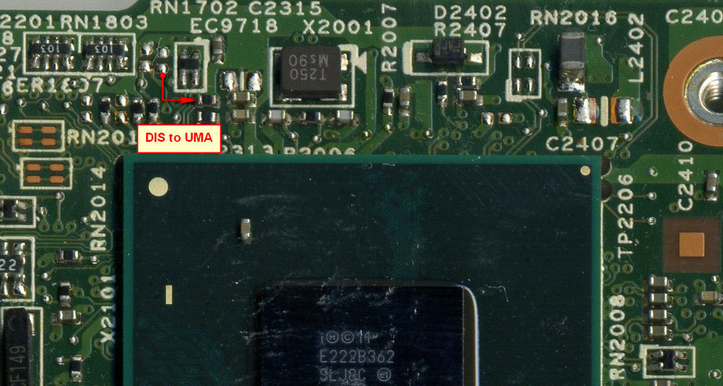

    Hello
    I want to switch from discrete to uma, but i cannot find resistor R2012 and R2013 location on motherboard. Maybe someone can post an image of motherboard where the locations are.

            Re: Dell inspiron 14z 5423 how to dis to uma
            Found R2011 (on red circle marking), perhaps R2012 is the next resistor. Confirm it with the scematic
                  May be this pic will help.
                    thank you very much.... i was looking for it. the other resistence, i think i have found the right one, and was only missing that.
                    really appreciate .

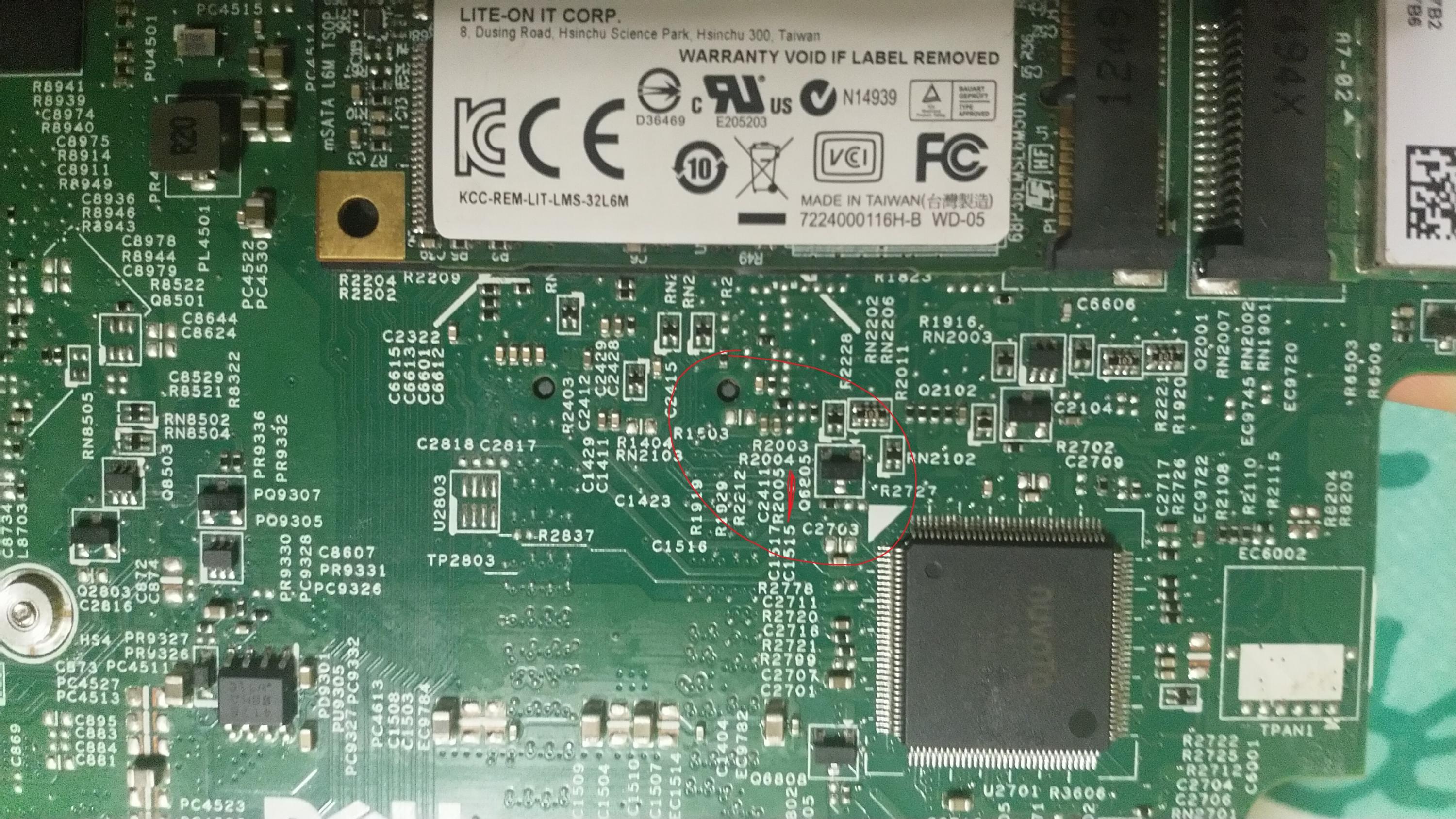

                      according to the picture attached, r2005 that need to be moved to r2004 is the one i showed in picture?
                      red moved to green ?
