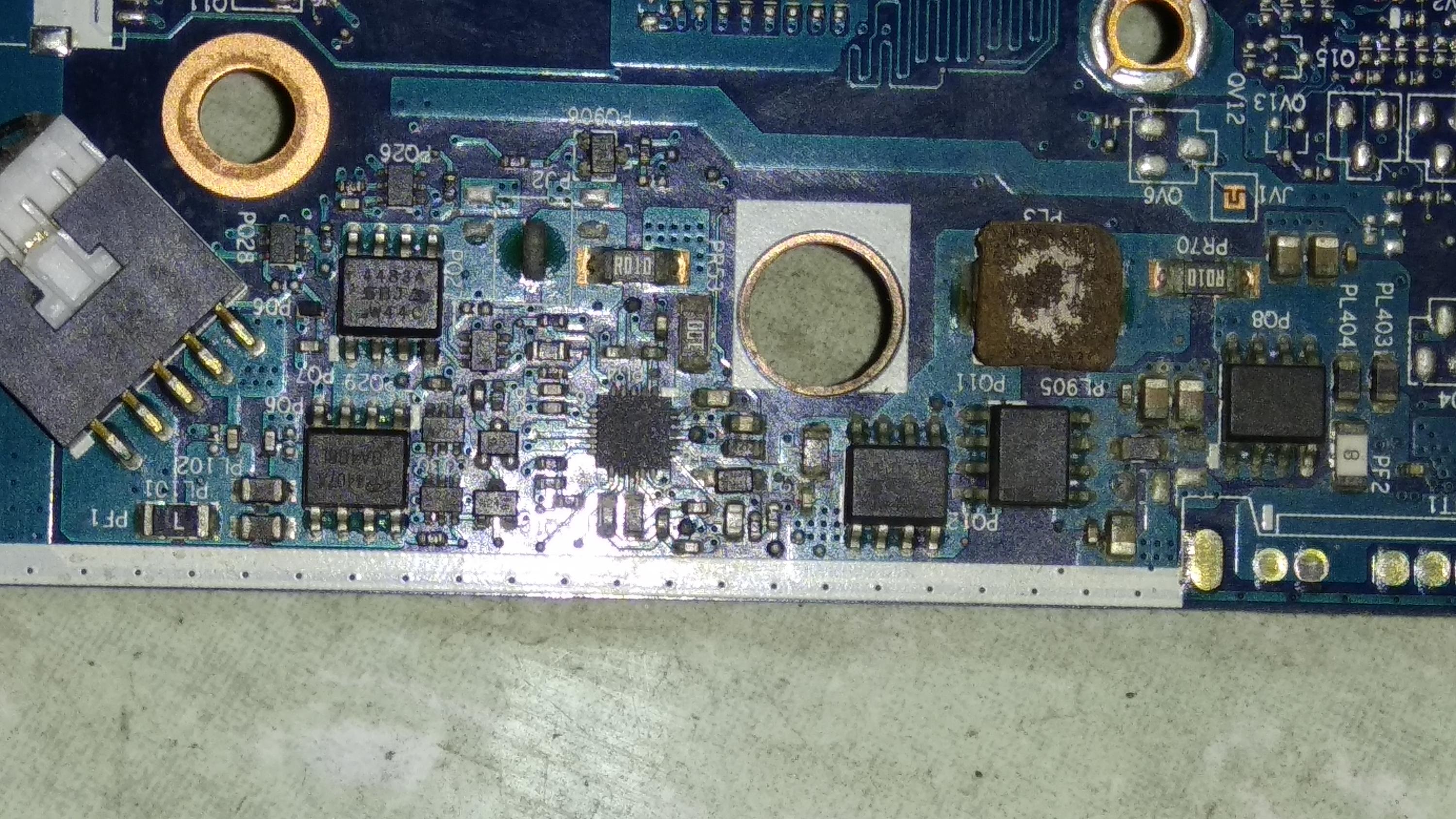

Found that G and S on PQ6 and PQ7 were shorted so I replaced them.
After replacing, there is 1V on B+ and it rises up to about 5V in a minute or so. There it stops.
When I removed PJ2, there was a nice 20V present so up to PJ2 it should be working okay now.
Soldered PJ2 back on and tried removing PJ401, PJ405, PJ501 and PJ604 instead but still the same issue.
So I tried replacing PU4, still same
 Even tried removing PQ11, PQ12 and PQ8. Still same.
No dedicated video on this board.
Running out of ideas what do try next.
