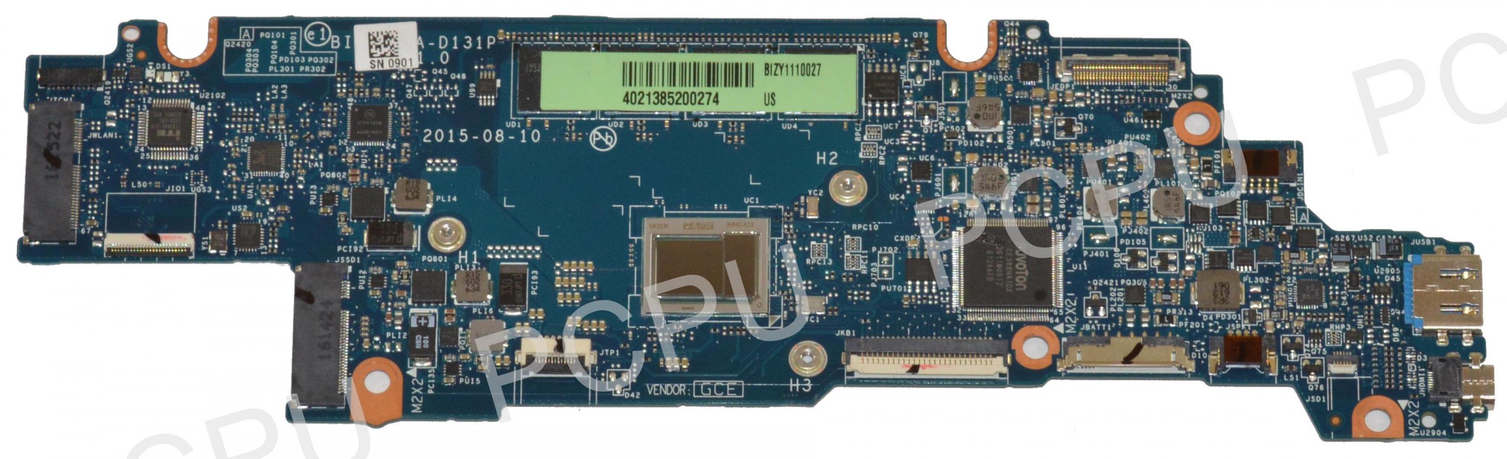

    Before going on, take a look at the motherboard. This is the best quality picture I could find of it:

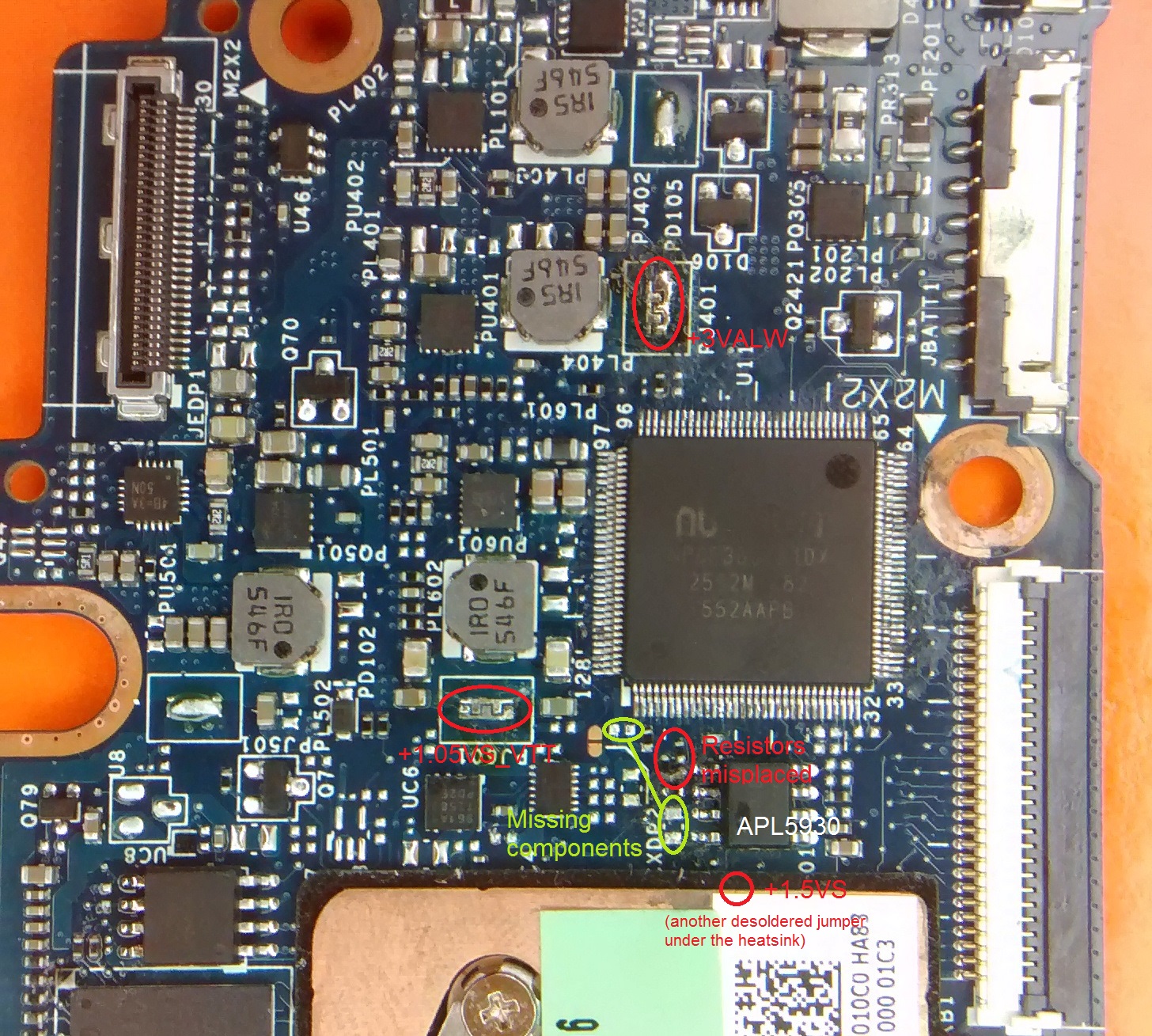

    And this is a particular of my board:
    I could not find any schematics of this board over the web. Luckily, I could find many similarities with the Yoga 3 motherboard, whose schematic I attached in this thread (look below).
    Thanks to this document I could name the shorted rails, which you can see in the image above in red text.
    I tried to supply the board with a constant current generator in order to isolate the short (up to 1A, with about 0.5W dissipated from the board). Sadly, I could not notice any component heating up. Actually, some of them warm up, but not that much, and I don't want to break anything since these boards are quite expensive.
    I also tried to desolder the EC since, according to schematics, many rails are going there and previous owner has replaced it, but the result didn't change.
    So I am looking for some help to isolate the issue.
    What's more, in the nearby of the EC there is a 3A linear regulator (APL5930). By comparing my board to the new one I could state that some of the components (in particular, configuration resistors that sets the output voltage and the output filter capacitor) are missing or misplaced.
    A pull-up resistor for the EC is also missing, but I've already placed a new one there.
    According to schematics, the two configuration resistors must be 1.54k and 1.74k. I could find the 1.74k in the correct position, but the two in the red circle are 10k (probably the pull-up resistor) and a 2.2k, which doesn't make much sense when calculating output voltage (I would get 0.8*(1+2.2k/1.74k)=1.81V, while with the schematics values, 0.8*(1+1.54k/1.74k)=1.51V). Also there's a 1nF capacitor, while in the schematics is used a 10nF one.
    If any with a similar board could measure the resistors and tell me the value will be really helpful. If not, at least please confirm that the generated voltage is 1.5V so that I can put a new 1.54k resistor there.
    Thank you

    Putting up missing components is very difficult without schematics or exact same mb. However, That's secondary but priority should be to remove shorts. Without short removal, no point in pondering over the values of missing parts.

      Thank you for your prompt response.
      I know this is secondary but it was the first thing I noticed when i disassembled the laptop. However, I am still focused on finding the shorts.
      I searched online some information about the ICs on the board, looking for one that may be the culprit. I could not find anything related. However, I found the schematics (attached below) of another Lenovo notebook that uses the same audio codec (Realtek ALC3240). According to it, the IC is powered by +3VALW and +1.8VS (the Yoga 3 schematics had 1.5VS!). So it's probable that the resistor I found (2.2k) was the correct one.
      Also, this makes it a good candidate for shorts, since two of three rails converge there. I will check it better.

        I have a b921 on my table, check for +5v short (if you have one) on U52 and U2905. Also the npce388 might need to be programmed to function correctly if you resolve the shorts.

          No shorts on +5V, but I checked anyway - nothing. However, I found pins 1 and 4 of D45 are shorted to ground, so I decided to desolder it. Differently than Yoga 3, these are connected to a pair of differential lines, much probably U2DN1, U2DP1 (USB 2.0 pair) if I follow Yoga 3 schematics.
          I believe this is sufficient to state that CPU is the issue here. What do you think?

            if the diode is gone and usb data lines are short to gnd then sadly yes.

              That's a pity. Is there anything I could do? May a reflow be of any help?

                No, only change of cpu, but you don't know what else is burned on that mb. It is not reasonable to continue this repair.

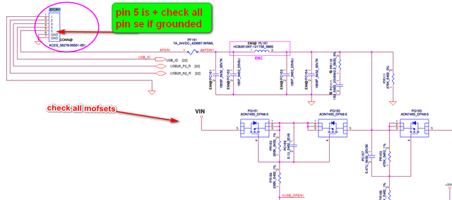

                  1: test the caps
                  2: test transistors
                  put black probe on gnd and use red on them pins if both side beeps its bad for caps.
                  transistors se if 3 legs short with gnd.
                  the mofsets look at the code google the datasheet and check the pins and ignore the gnd pins and test if other pins is short with gnd.
                  if you have dc power supply it will help to inject amps to find heat.
                  check dcin mofsets
                  JDCIN1
                  U2905
                  Q2421
                  PD103
                  PD105
                  PQ101
                  PQ102
                  PQ103
                    • 21655
                    Re: Yoga 700 11ISK multiple shorts
                    @stevie2001 , if you take the time to read the whole thread you`ll see that the problem has nothing to do with the mosfets, its a different problem altogether, and...these guys know what they`re doing .

                      Thanks. A new CPU costs about 60USD, but I don't have the tools to replace it. I thought a reflow could have helped if the shorts are among BGA balls, but I cannot be sure. The only option left is to buy a new motherboard, which costs more than 150USD. In my opinion it's way too much for such a board.

                        Full short to ground are not caused by the solder balls but rather by the die itself that's internally shorted.
                        Better throw that motherboard in the trash.
