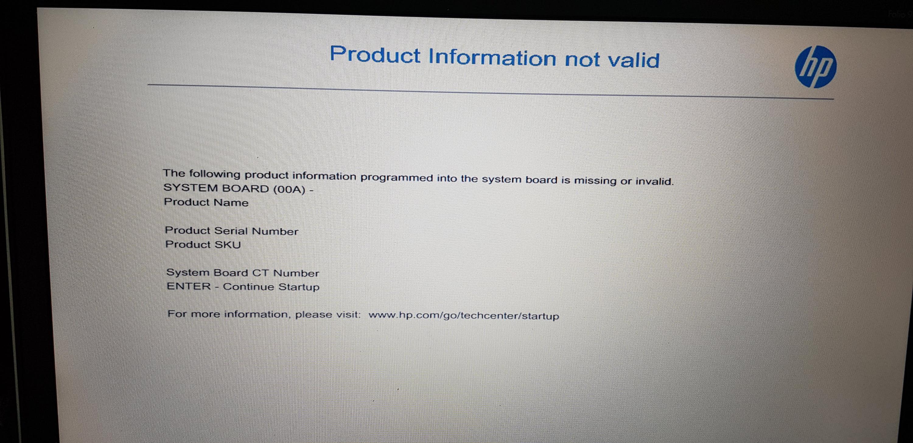

hp elitebook folio 9480m error msg
  • alihomee
    • Dec 2012
    • 1577
    • malaysia
    somebody tried both ec and main bios files and now it showing the error massage ..product info not vaild.....even after pressing enter for contuinue startup.....................any ideas how to solve this

    Re: hp elitebook folio 9480m error msg
    Hp dmi tools not doing the job????
      it even cant boot so how to use dmi tool
                i have same problem , even when i put serial i get same error ,so my advice try another bios dump
                    Originally posted by imranromi
                    Try this and reply.
                    it shows same error with ur file but only last line is not there this time

                      • ala_borbe
                        aka Donald
                        • 1625
                        • Malta
                        your vss in first post in empty... do you have original backup?
                          no i dont have orignal backup but i can provide orignal backup from another running notebook

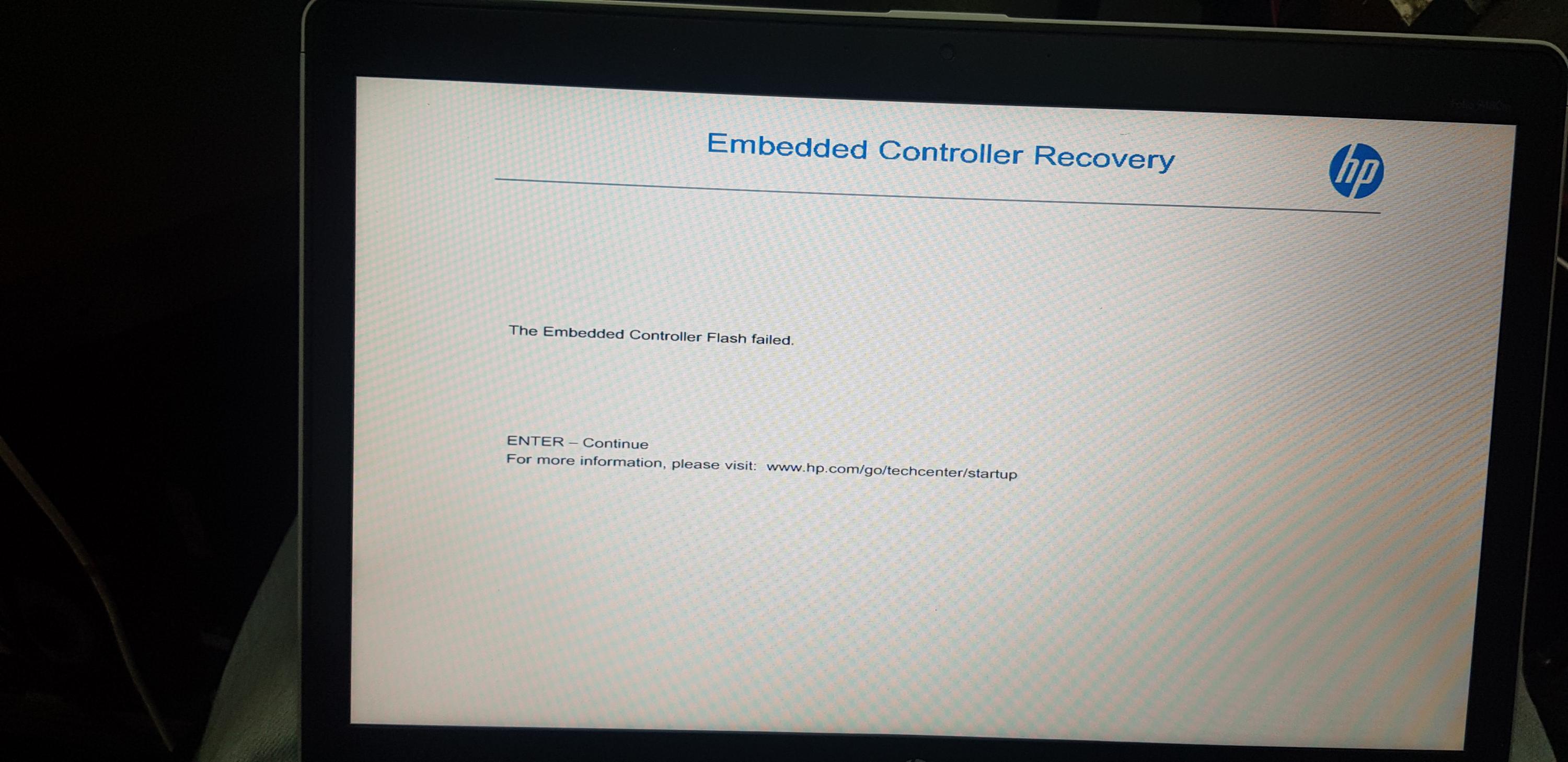

                                • alihomee
                                  • Dec 2012
                                  • 1577
                                  • malaysia
                                  now it showing this error
                                  • ala_borbe
                                    aka Donald
                                    • 1625
                                    • Malta
                                    try this
                                    its oldest version that i could find
                                    hope it works. if it does not, you can try to make emergency flash stick and turn on laptop with holding win+B keys and it should update everything and dmi should be fixed
