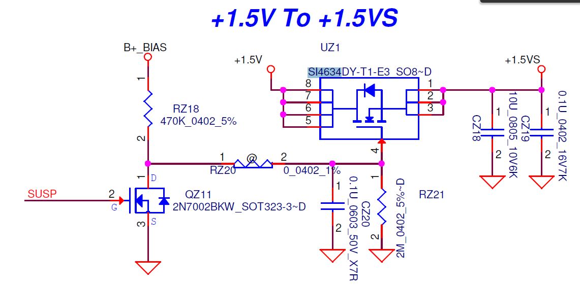

      Re: Motherboard LA-9105P, no CPU power, 7 beeps
      Check Resistor connected to QZ11. You should get 19v and 12v at the two ends of this resistor. If 12v missing -no vcc
        Sorry not 12v but 5v i meant.
        Check QZ1 pin 4-5v present or not
            check PU400 also.
            QZ11 have two resistors RZ18 (one side 19.8V other 15.4V) and RZ21 (one side 15.4V and other ground) UZ1 are open and make +1.5V from +1.5VS
            I do not have idea how 5V can be on resistors, but I'm newbie in electronics and may be wrong. See 1.jpg and correct me if I'm wrong.
            About PU400 - on PL400 I have 1.8V - in my opinion PU400 works as expected.
            QZ1 also works Gate 19V source and drain 5V
