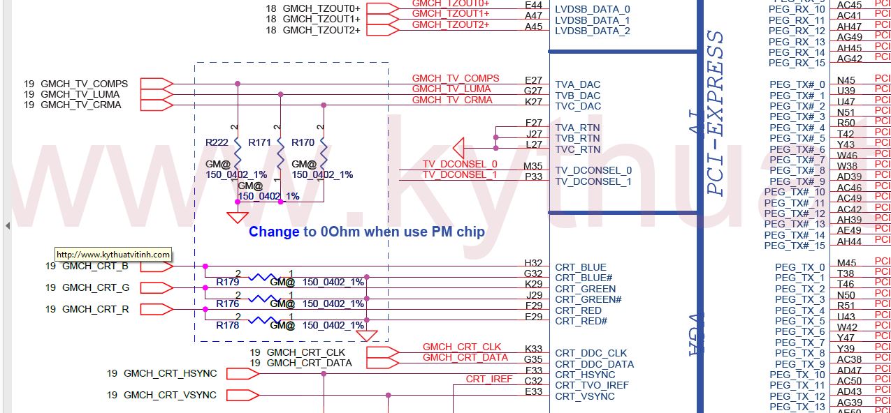

          Icl50 la-3551p
          rev 3.0
          i found this:
          https://www.informaticanapoli.it/dow...l_LA-3551P.pdf

            in page 10 ,i read "change to 0hms to use PM chip" i found the resistors in motherboard do you think if i short the resistors i got it working ?

              Re: Acer 7720ZG disable 3d card
              No, it will not work. Find RP3 and RP4 on the mainboard. Then, tell which one exists there.
                RP4 exist ,RP3 nothing
                  It seems conversion of this mainboard to UMA is either not possible or it takes too much work and troubles. Thus, it would be better if you buy a cheap MXM graphics card or scrap the laptop.
