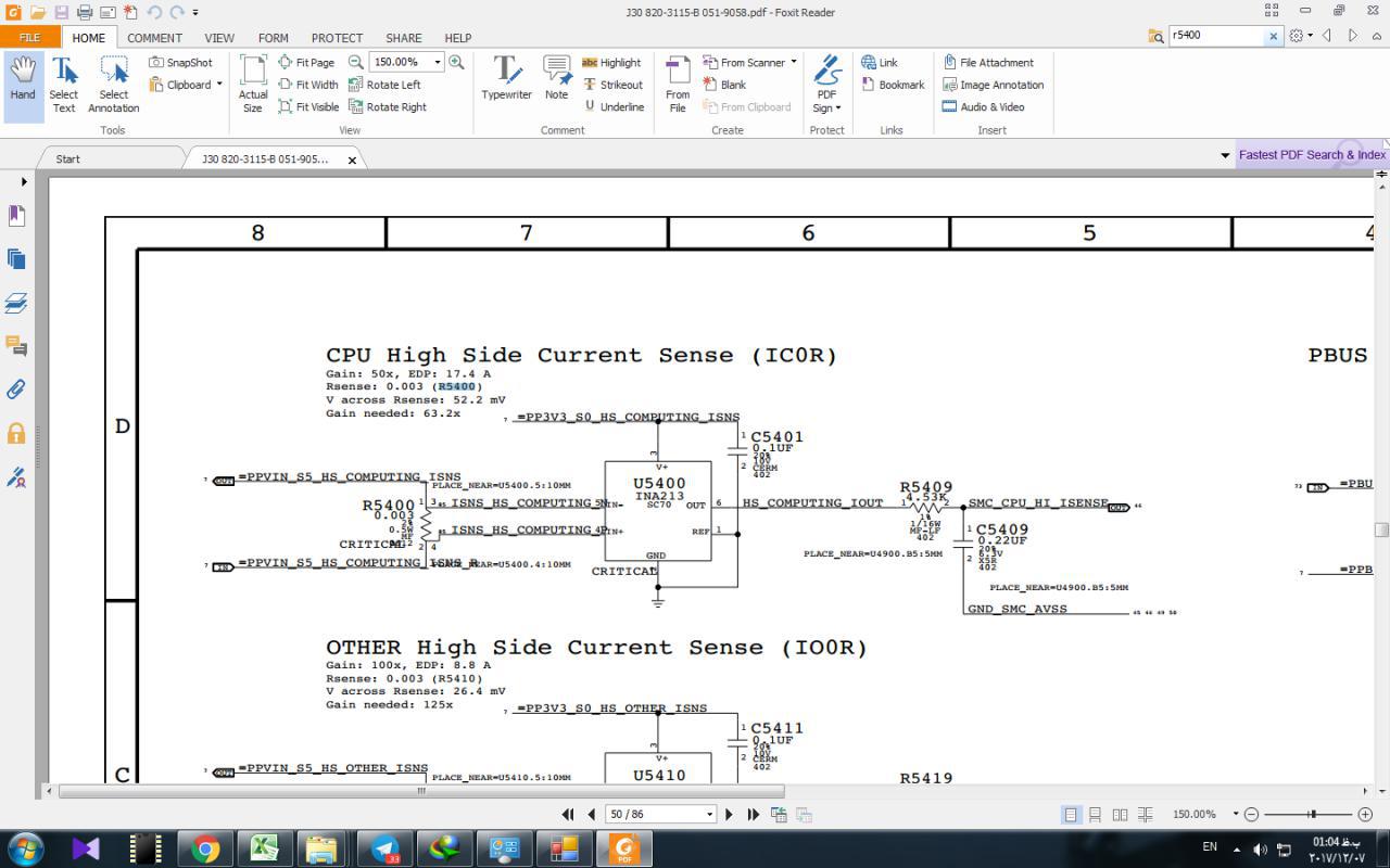

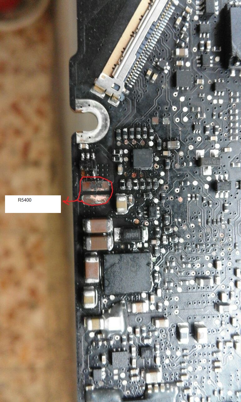

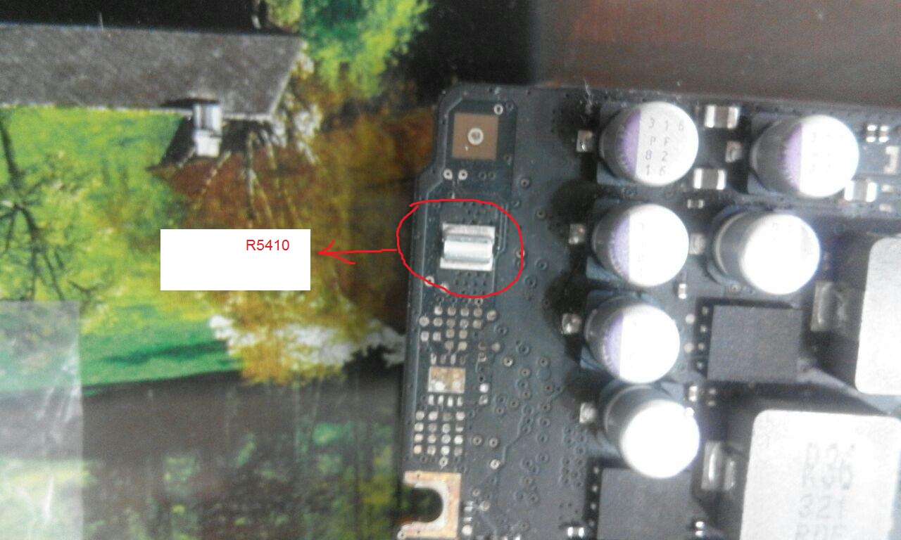

    help about damage part in apple A1287
    hi
    As picture this resistant damaged and i have not this part.is this Special resistor?
    may i use other type of resistor instead of this part?
    tnx

    Re: help about damage part in apple A1287
    Originally posted by boyebaran
    hi
    tnx
    This is a good replacement :
    http://uk.farnell.com/ohmite/fc4l64r...ohm/dp/2363990
    • caspian
      • Oct 2015
      • 1589
      • Laptop
      this is a current sensing resistor with resistance 0.003 Ohm.
      if you do not use exactly a 0.003 Ohm resistor, the laptop will act strangely and may not do POST.
