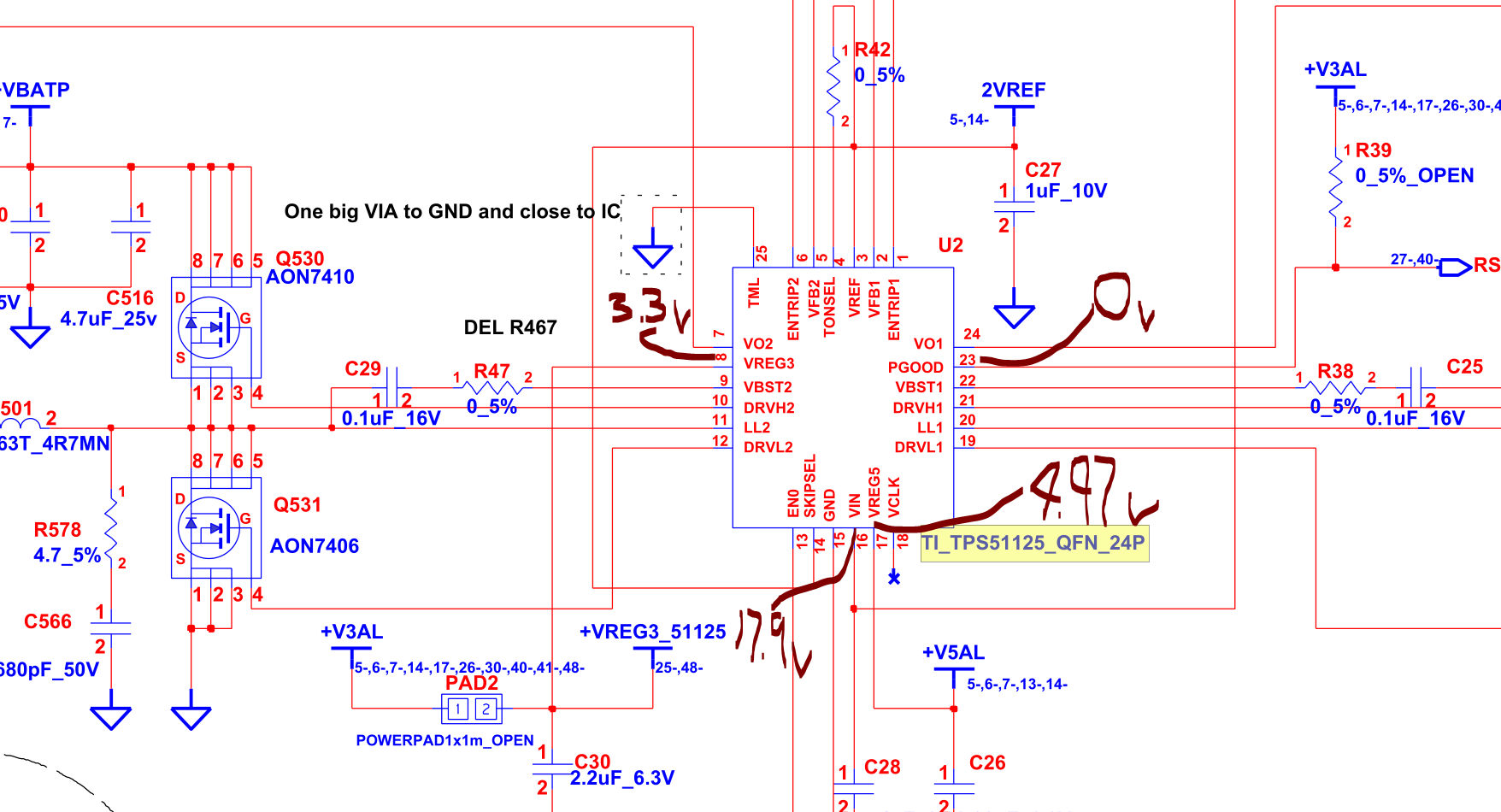

V5AL/V3AL/VIN
I've checked the Votlage Regulator IC. I get 5V on the VREG5 line and 3.3V on the VREG3 line, and get 18V at VIN. So the VIN, V5AL and V3AL are all present!Further checks

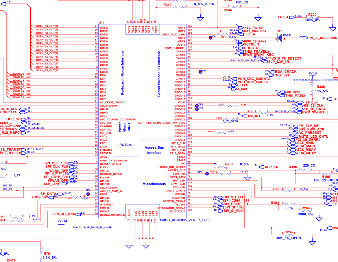

I definitely get 3.3v on power switchI have checked the Super IO (it's called IO Power in power diagram "TPS51218") it's listed as U25 IC, I get 0 voltage on any of those pins (it's 11 pin)
Next thing I measured is the KBC_PWR_ON which seems to lead to "TPS51125" IC
I get VREG3 - good
VREG5 - good
VIN - good
pin 23 is PGOOD, I get no voltage on that pin
