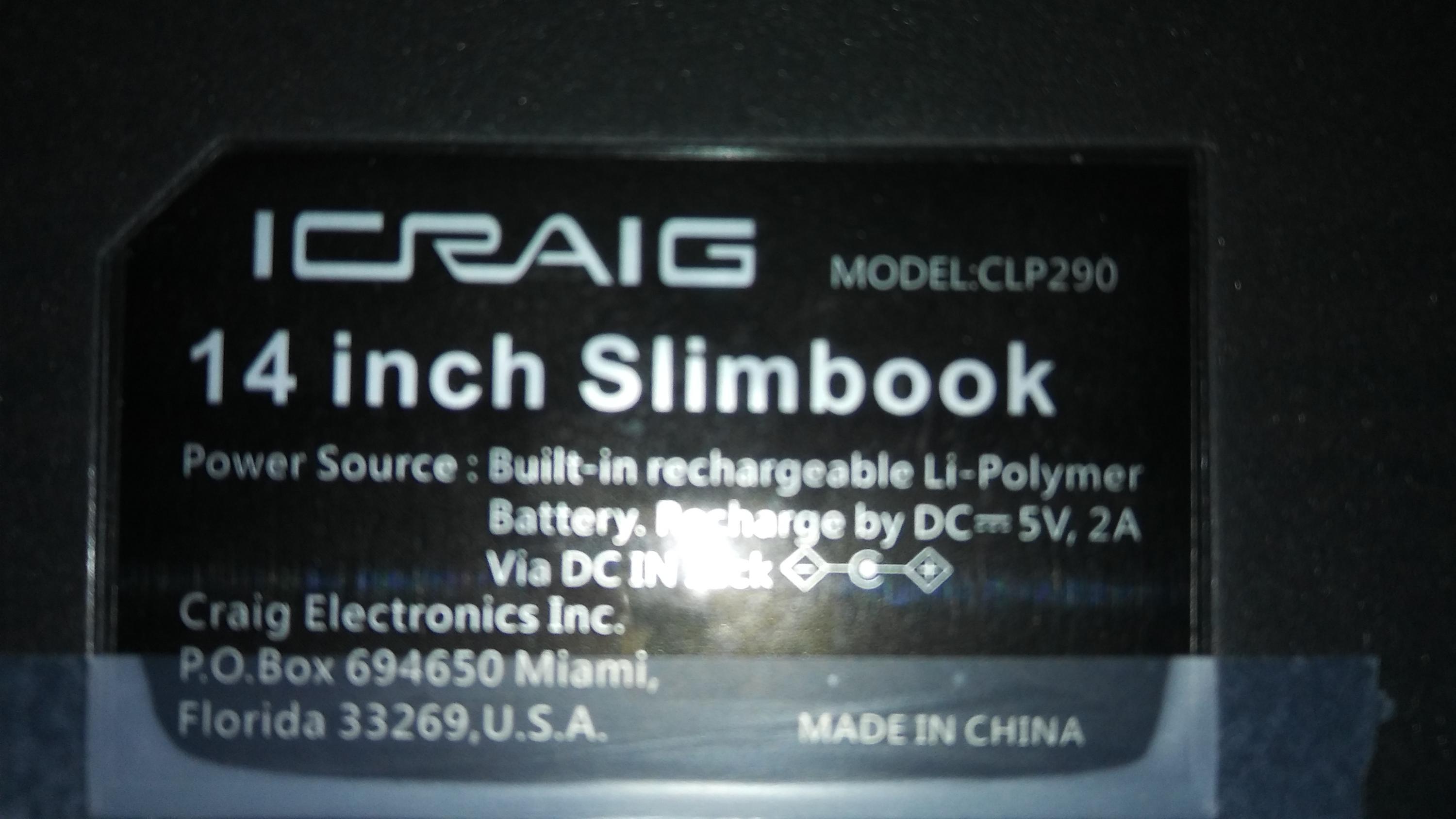

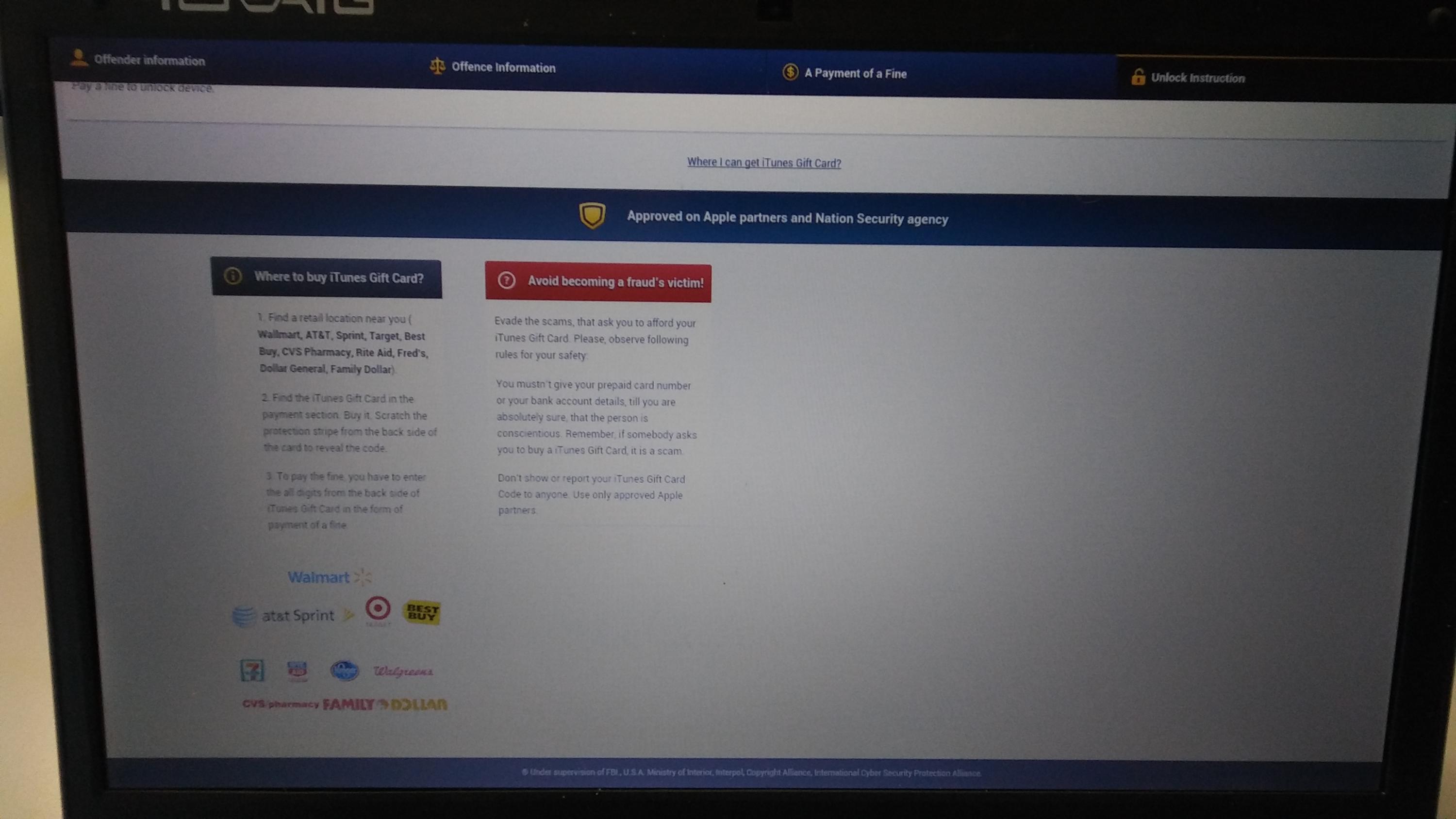

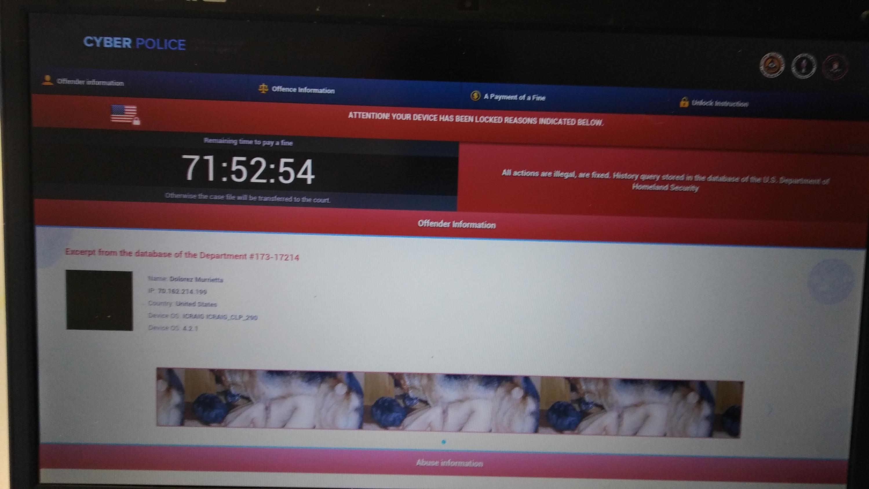

    One senior lady bought this Netbook, iCraig CLP290 has virus needs reset to factory recovery mode, I try this (15 second power button down.) it not works? Any help?
    PS: Is this a real ransomware?
    PS: How can I open safe mode, OS is Google Android 4.2 ?

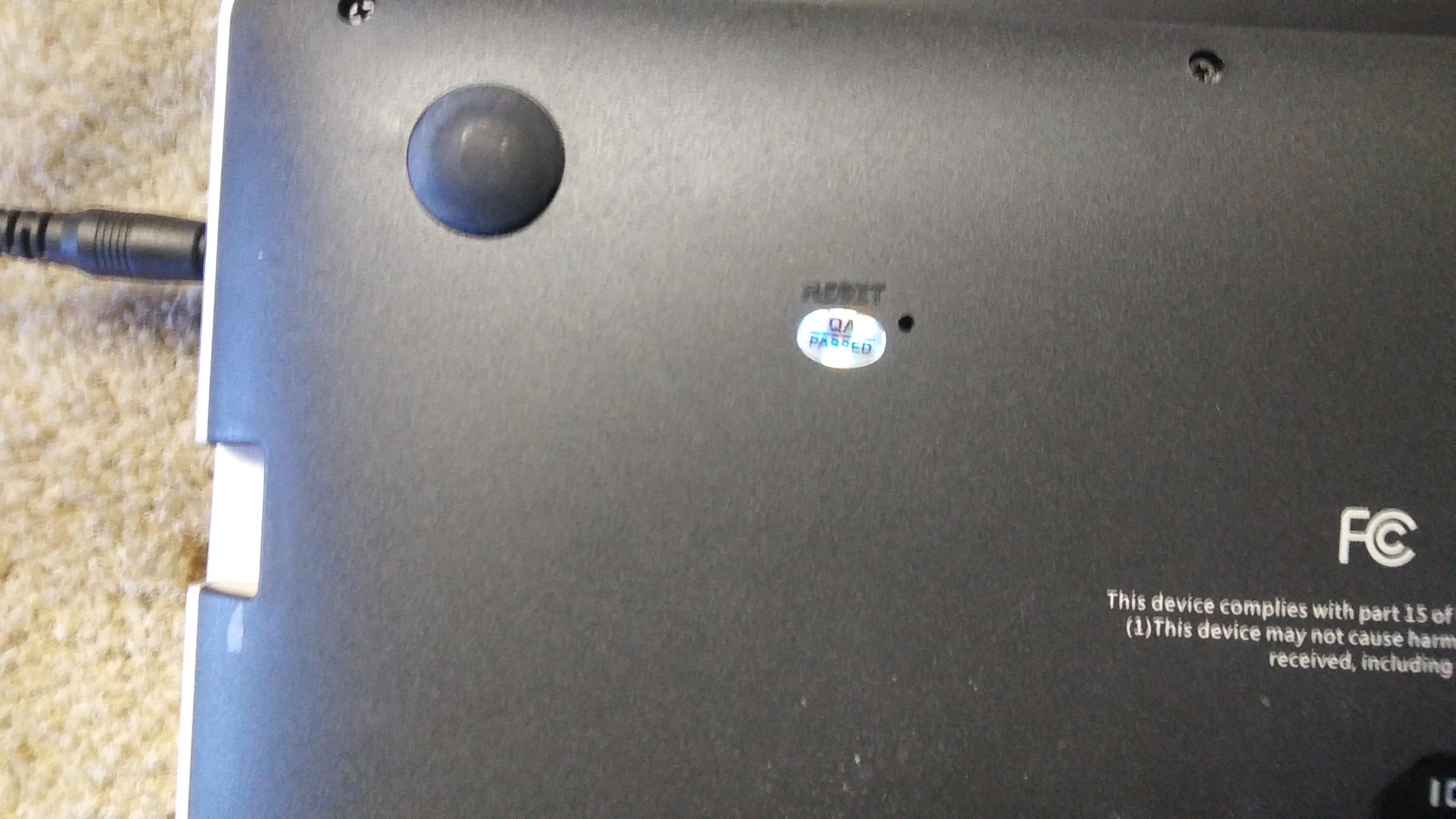

                Re: iCraig CLP290 needs factory recovery key?

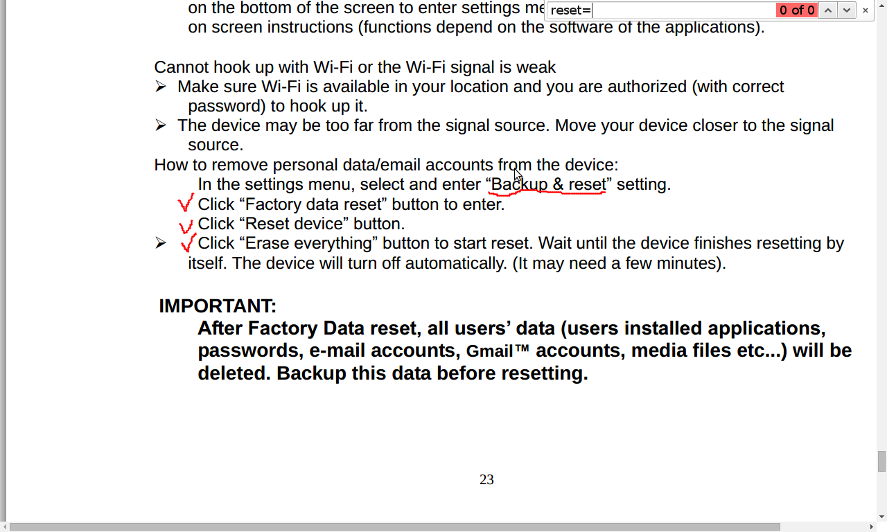

                YES, it does has A reset button, I push the reset 20 sec. still boots back to the doggy pictures.
                PS: Thanks for both of you, will try backup and reset from setting.

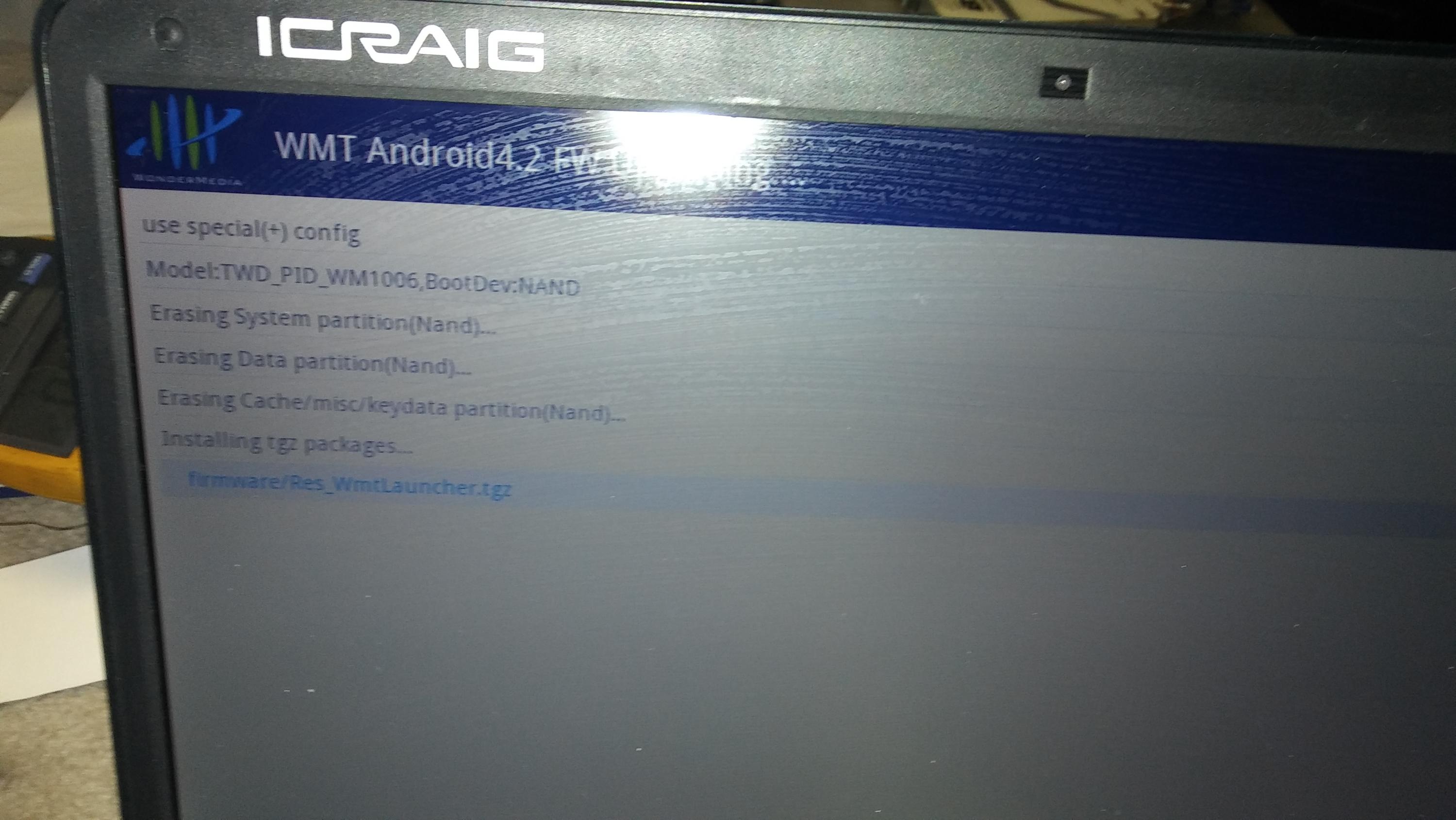

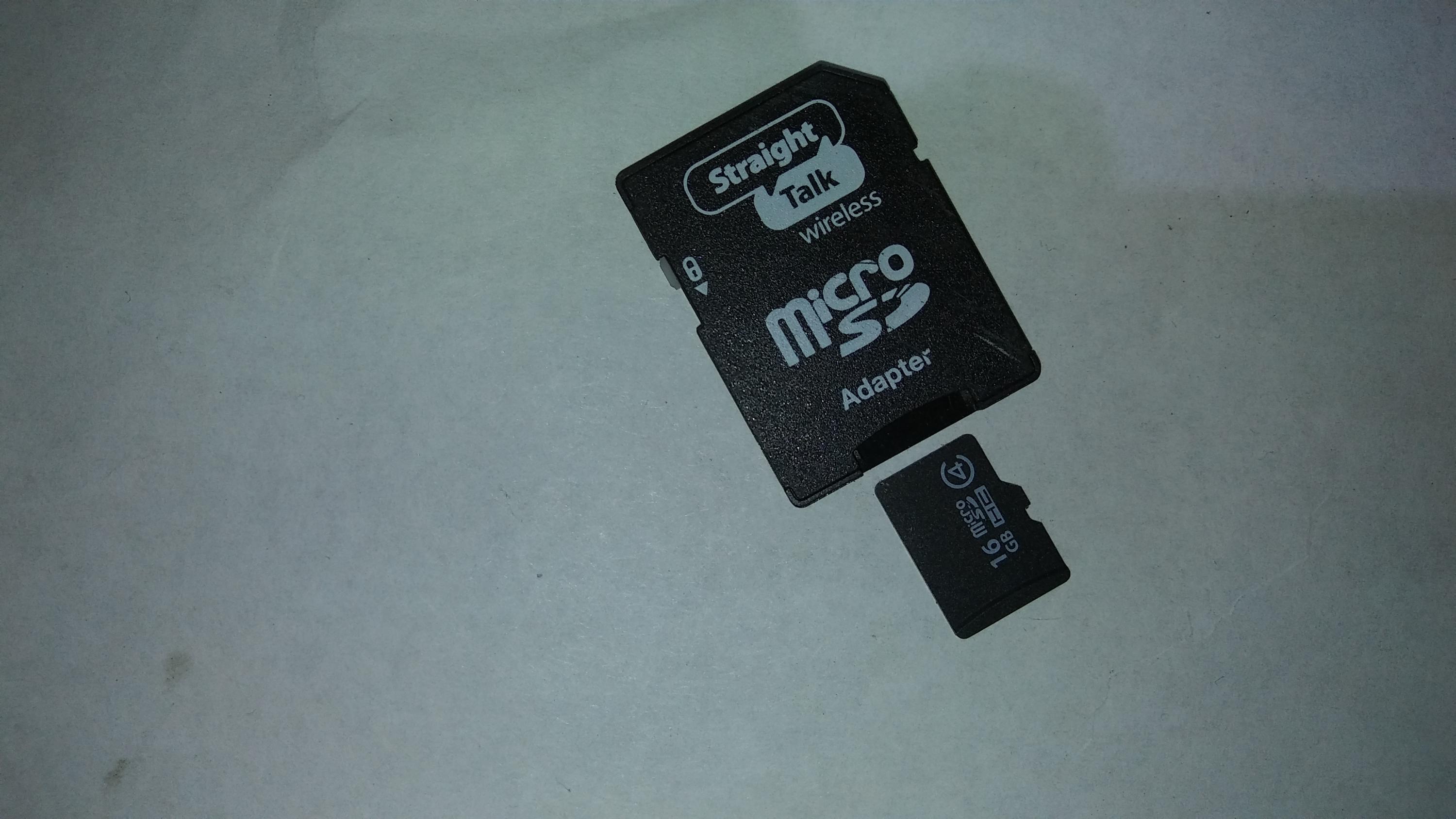

                  Some devices don't have recovery mode at all, you need to reflash the firmware, download the firmware and follow te instructions at the begining of the user's manual:
                  FW: https://drive.google.com/file/d/0B1o...dXVXBvdW8/view
                  manual:

                    This one is call: Cyber Police (doggy) ransomware.The Hacking Team, based in Milan, Italy.
                    Cyber Police ransomware can lock your Android device and ask for payment.
                    http://www.digitaltrends.com/mobile/...#ixzz4XNpAeaXW
                    First Aid for Android: How to unlock your ransomed phone
                    https://nakedsecurity.sophos.com/201...ansomed-phone/

                      After I down load how can I install ? I never do it with Android OS. this notebook has no FDD only has two USBs, I guess I need to unzip to the USB, what happen to the bootload?
                      PS: Thanks to everyone, will try it now. they want me use SD card.
                      PS: This exploit can only affect Android versions 4.0.3 to 4.4.4. That’s Ice Cream Sandwich (2011) to KitKat (2013). Thankfully, most newer phones have already been upgraded to Lollipop (2014) or higher. However, according to the latest Android dashboard (April 4, 2016), 56.9 percent of all Android devices fall into these version numbers. That means more than 500 million Android devices are affected worldwide.

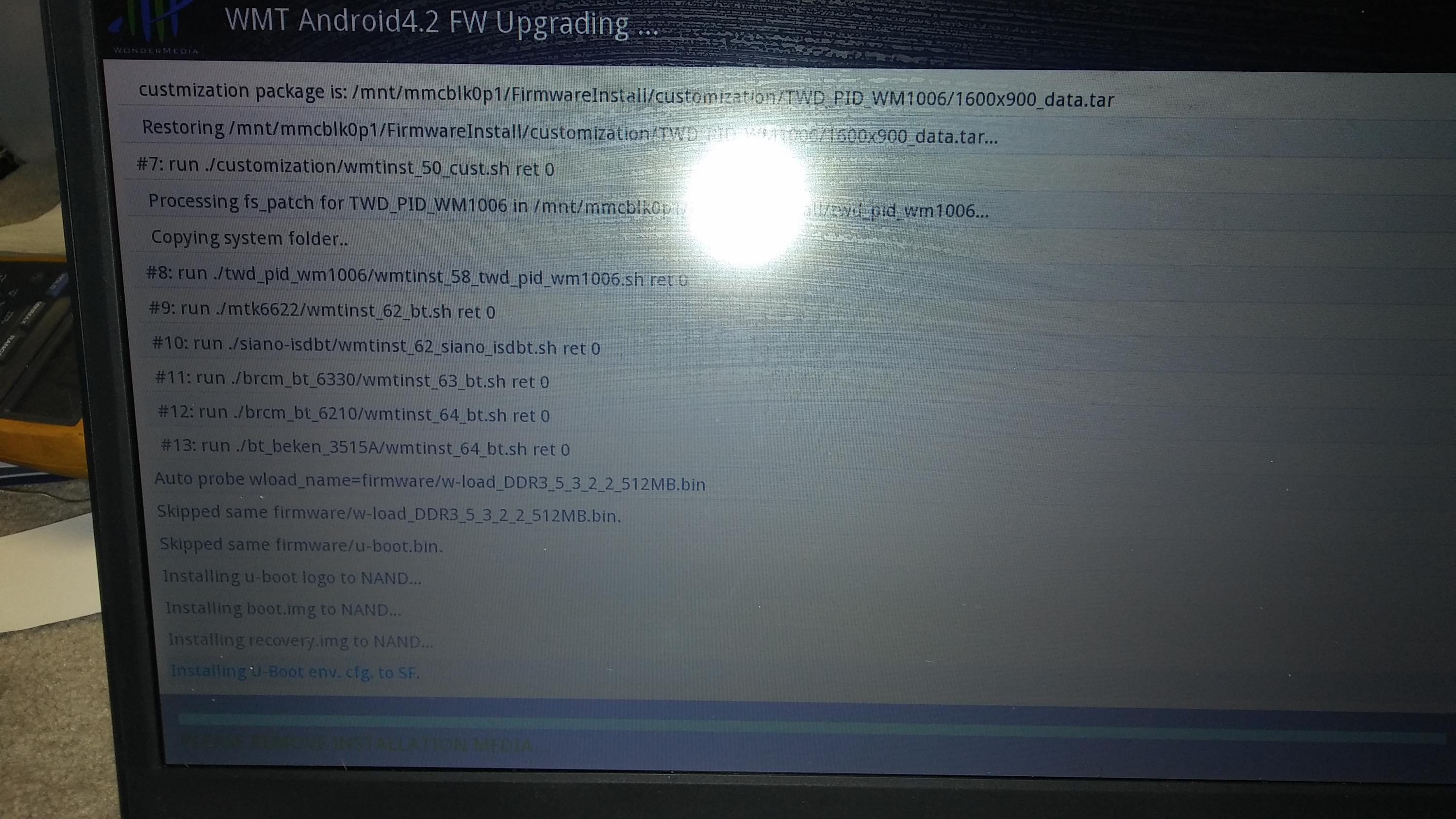

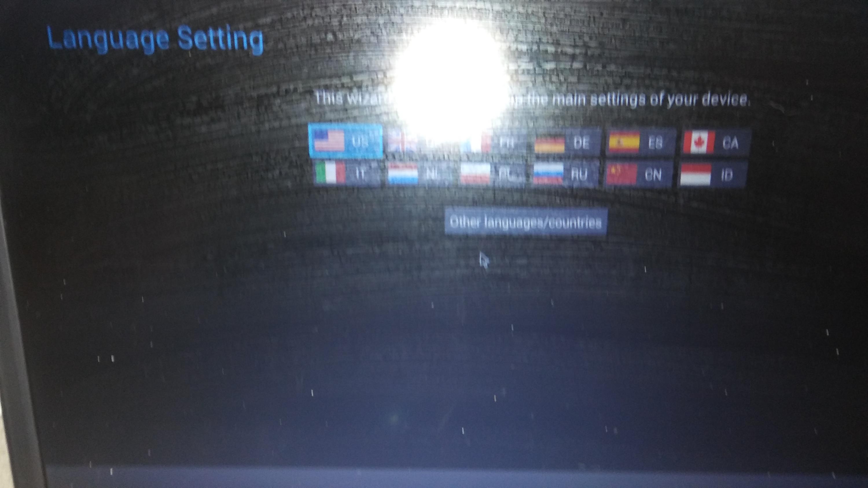

                        Thanks to everyone, I used to sit on the dark corner and fix everything by myself................................... Now...... I've Got Friends.........
                        I did it over Linux mint mate 15, I download and unzip the files, copy and paste to SD card. insert into the Netbook everything automatically finished, This is the fast way to do, instead of chasing the doggy................

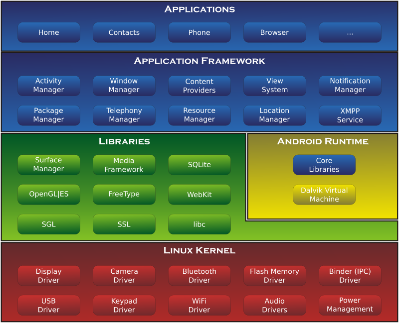

                                Android is a Linux distribution according to the Linux Foundation, Google's open-source chief Chris DiBona, and several journalists. Others, such as Google engineer Patrick Brady, say that Android is not Linux in the traditional Unix-like Linux distribution sense; Android does not include the GNU C Library (it uses Bionic as an alternative C library) and some of other components typically found in Linux distributions.
                                Picture1: 800px-Android-System-Architecture.

                                  Its not real ransomware. Its scamware. Easily removed in safe mode.
                                  I doubt its created by the security software industry.
