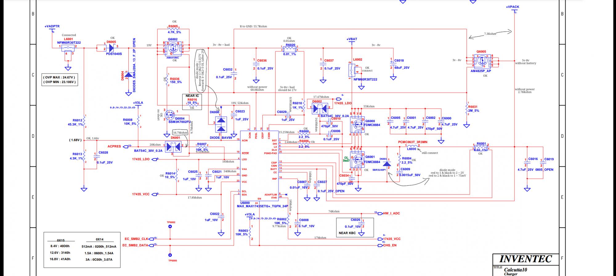

    Hi, all i've got toshiba laptop weird problem, with battery Ok but no charging and no power on with adaptor.

    charger ic, change it. common issue.

            Replaced charger ic but mosfet voltage goes 3v-8v, LDO 1.6v then 0v, AC detect is ok it show 1.66v but this laptop can run with battery

              1) can you link the schematic?
              2) which charger IC is onboard?
              3) ACDET is too low.
              4) check the usual 2*DCin mosfets. If N-channel mosfets, the gate must be ~25v to enable.
              Often the 2nd mosfet gets killed.
              5) remove the 4k resistor on ACDRV to confirm if gate voltage is not ~25v. A leaky mosfet will the boosted gate voltage down.

                Ic : MAX17435ETG
                1st and 2nd mosfet are ok (no short)
                DCin: 19v
                Idk where is ACDRV pin

                  Remove the battery.
                  Attach the proper adapter.
                  What are the voltage to ground readings for the first dcin mosfet? This is AM4410N.
                  Source
                  Gate
                  Drain
                  ACDET is ok for this charger IC.

                    With no power, meter in resistance mode.
                    Check the resistance to ground of the LDO pin #4.

                      Maybe bad ic connection, i see it not fully filled with tin
                      And DLO pin show OL when resistance mode and 0v when plug a charger
                      I will resolder it again

                        After resolder charger led on but no charger voltage from inductor (low side charging mosfet gate 0v, resistance 23Mohm and high side charging mosfet gate only 10.43v, resistance 30Mohm and my battery voltage is 10.96v = 0%) also LDO 5.25v but after resistor R6007 only 0.24V
