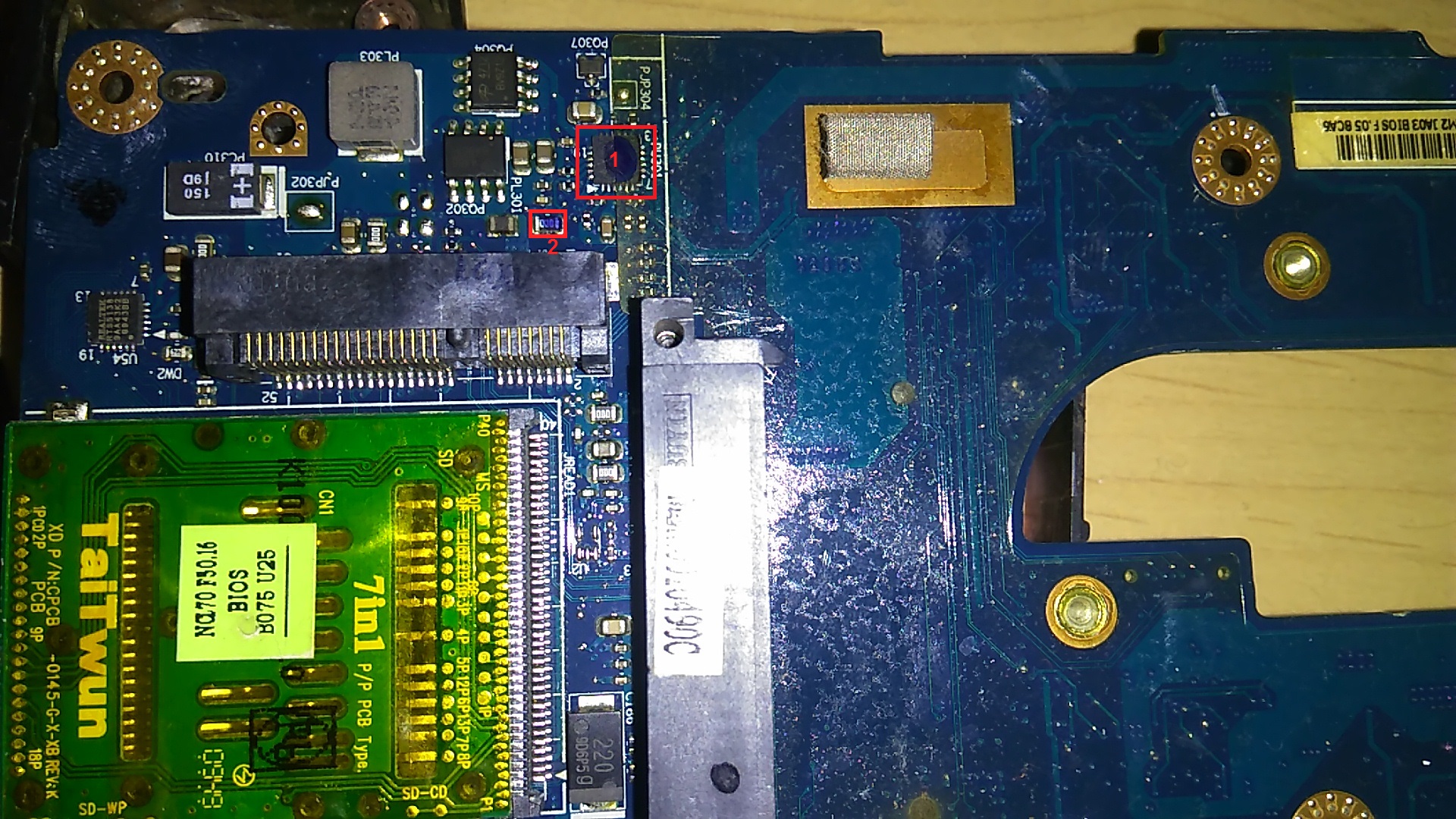

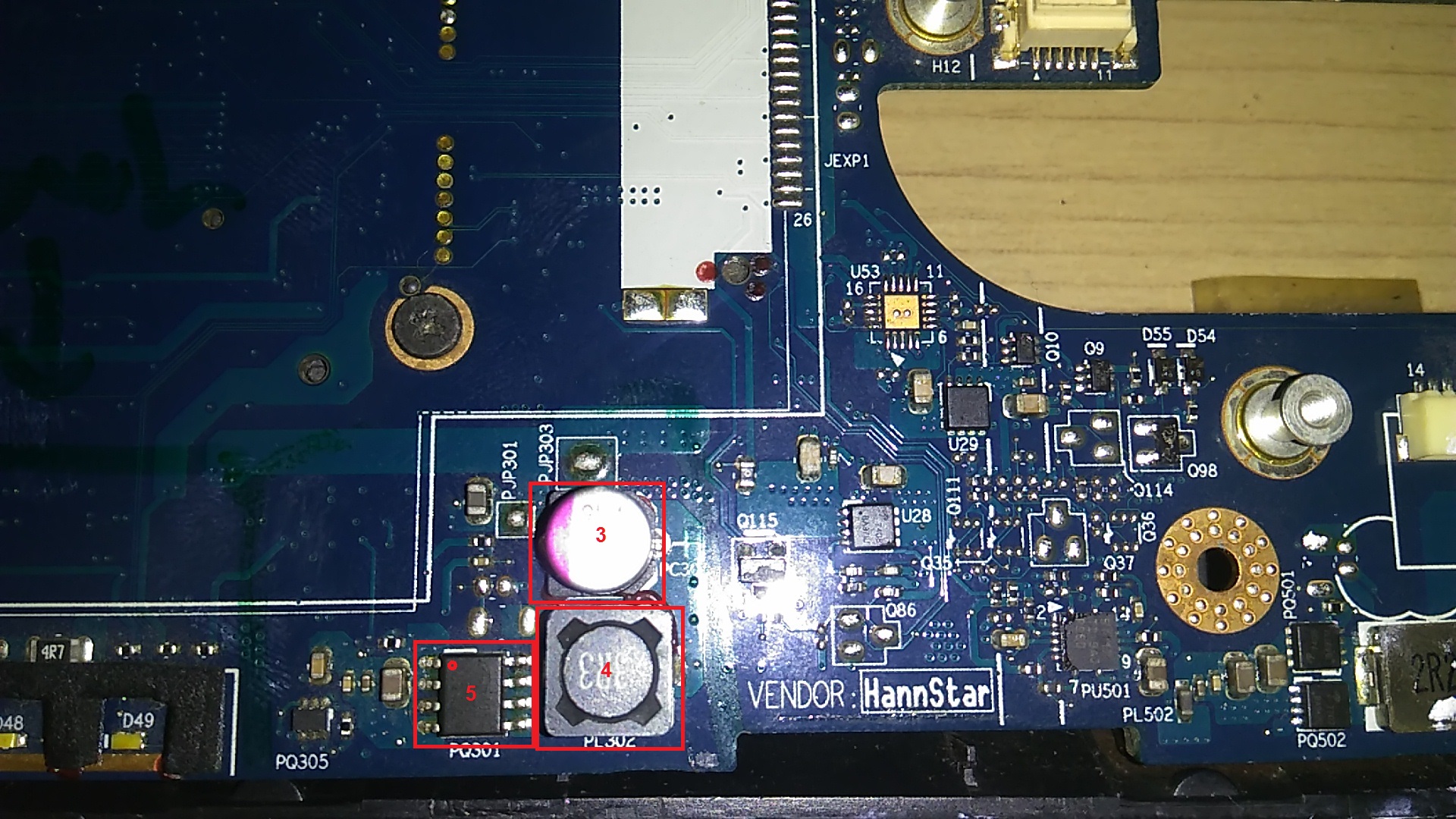

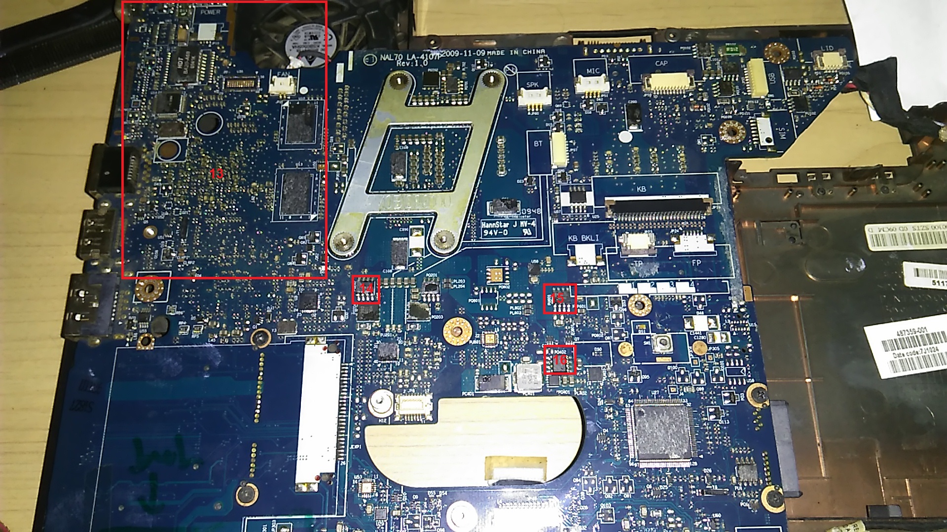

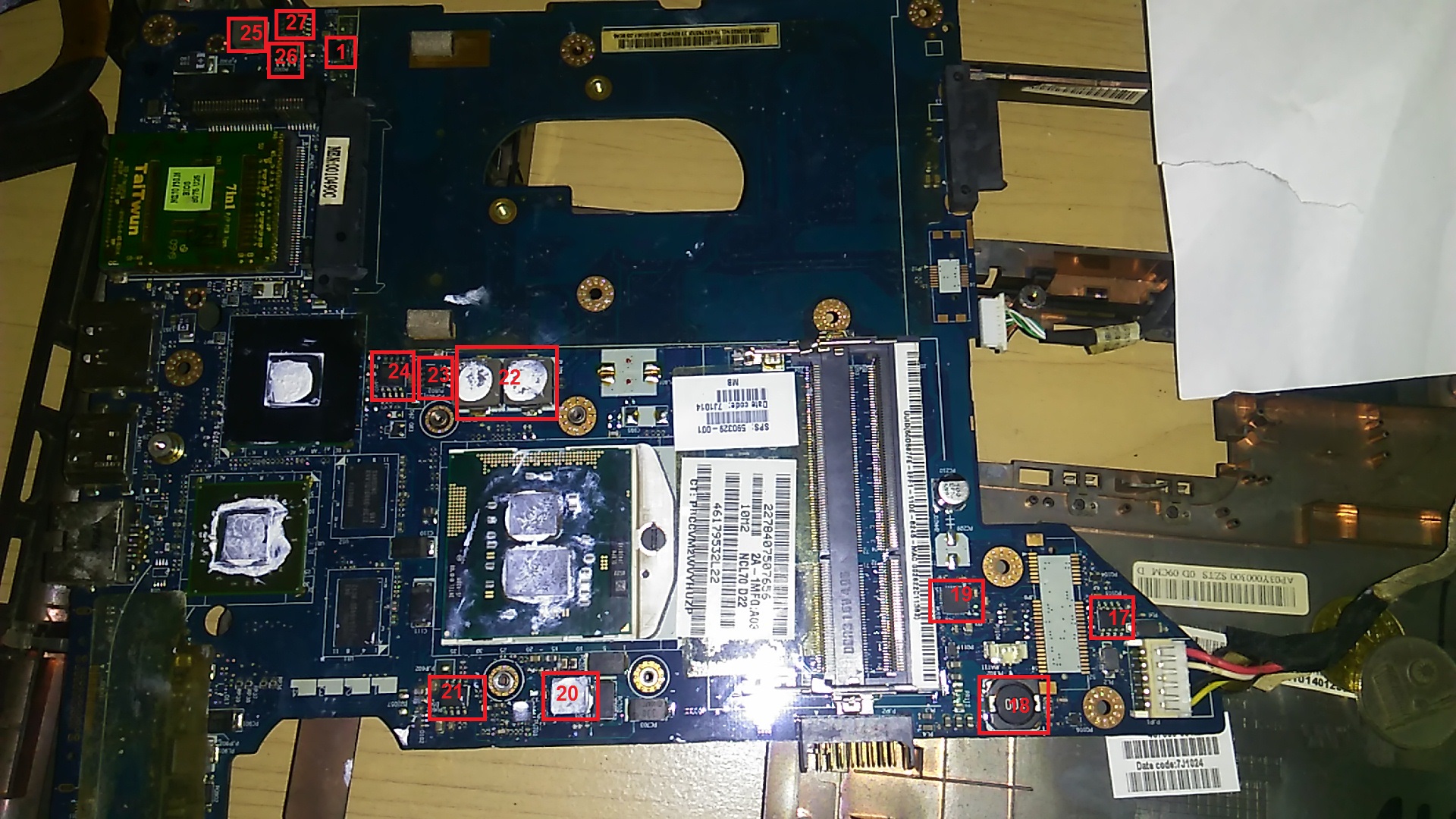

    my laptop hp-cq41 has stopped working recently so i've try alot of solution but it seems like not to work...
    symptoms : - split second light
    - no power
    i have attached some image that might help to find the problem

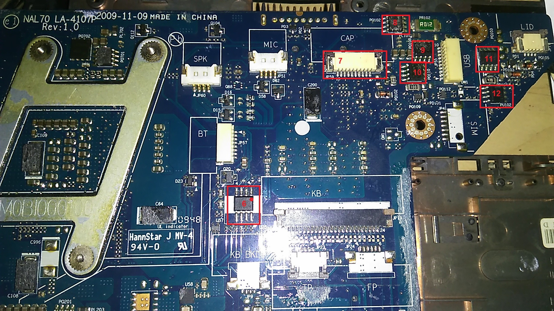

    on number 1 box, on s0 state, it is quite hot but other component like cpu, gpu and bridge seems not working
    on number 5 box, there is some voltage drop at the output pin... from 3v to some 1v-ish
    Any solution is welcomed
    TY for your time... help me find the problem

                Sorry for late reply, the PU301 is overheating and the voltage reads at each pin at s0(off) are :
                (v)
                1 1.2
                2 no reading (0.019)
                3 2.1
                4 2.1
                5 0.3
                6 1.1
                7 3.5
                8 3.5
                9 8.5
                10 3.3
                11 3.3
                12 0
                13 3.1
                14 2.1
                15 0(ground)
                16 12
                17 5.3
                18 5.3
                19 0
                20 5.3
                21 5.1
                22 10
                23 0
                24 5.3
                Tell me if anything is wrong with the readings
