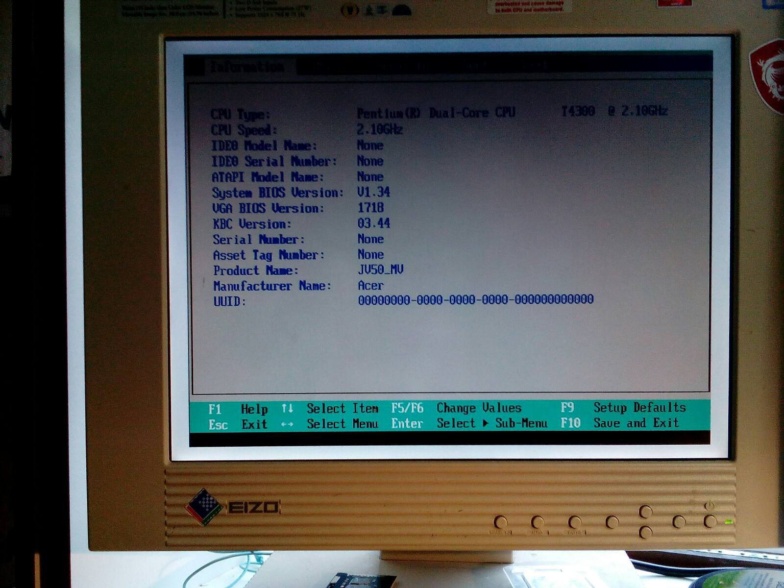

      Ok, at least i'm not alone with this question
      I tried to do this on JV50-MV DDR2 M92 board and seems it works only partially.... Probably need some help, but let's one-by-one.
      So, to run Intel graphix on this board according to schematics, one have have to:
      1) add RN44, RN76 (2x0R) - DREFCLK/DREFCLK# and DREFSSCLK/DREFSSCLK# clocker signals
      2) add R254 (10k) and remove R260 PCLKCLK4 clocker strap)
      3) add RN32 (2x100k) - GMCH_BL_ON/GMCH_LCDVDD_ON pull-down
      4) add R384 (3k37) - LIBG for GMCH, R161 (1k) CRT_IREF for GMCF
      5) replace RN30 with 4x150R and R31 with 4x75R - CRT stuff
      6) remove R159, R162, R438, R439, RN33 (for @DIS 0R shorts unused GMCH blocks)
      7) add RN34 (2x10k) LCTLA_CLK/DATA pull-ups to 3V3_S0
      8) add U12 - 1117-18 for 1.8V_NB_S0, put L6 for 1D5VRUN_QDAC
      9) add RN1 (2x0R) and move RN7 (2x2k2) to position RN2 (CLK/DATa_EDID paths to GMCH and pull-ups to 3.3V_S0)
      10) move RN24, RN22 (4x0R) to RN60, RN61 (LVDS pairs), RN63 to RN62, RN57 to RN53, RN112 to RN66 (CRT stuff)
      11) remove R366 (UMA_DISCRETE# strap for SIO), remove R369 (BLON_IN strap for SIO)
      12) add R367, R6 (0R), move R3 (33R) to R1 (LCD conttrol for UMA)
      13) *Feed pin5 (empty) of U13 with 3.3V_S0, VCC_GFXCORE witn VGA_CORE_PWR and add some blocking ceramics, e.g. BC1,2, C100, 119, 141, 175, 186, 206, 622, 634

        Re: Acer 5738g uma convert
        After doing this we have successful detection of Intel graphics adapter by BIOS and see full star with a picture only on external CRT port.
        The reason is that GMCH does not make an attempt to read EDID from LVDS, as seen with oscilloscope 3V3 pull-ups are ok and connection to GMCH pins is also measureable as a load.
        Before, i did also similar conversion on JV50-CP and there everything is working, sucsessfull reading EDID and so on.

                    Found it! Installed RN14 pull-ups for HDMI EDID and LCD now works!
                    Looks like the BIOS tries to read EDID from HDMI first and when it fails, it does not read EDID from LCD either.
