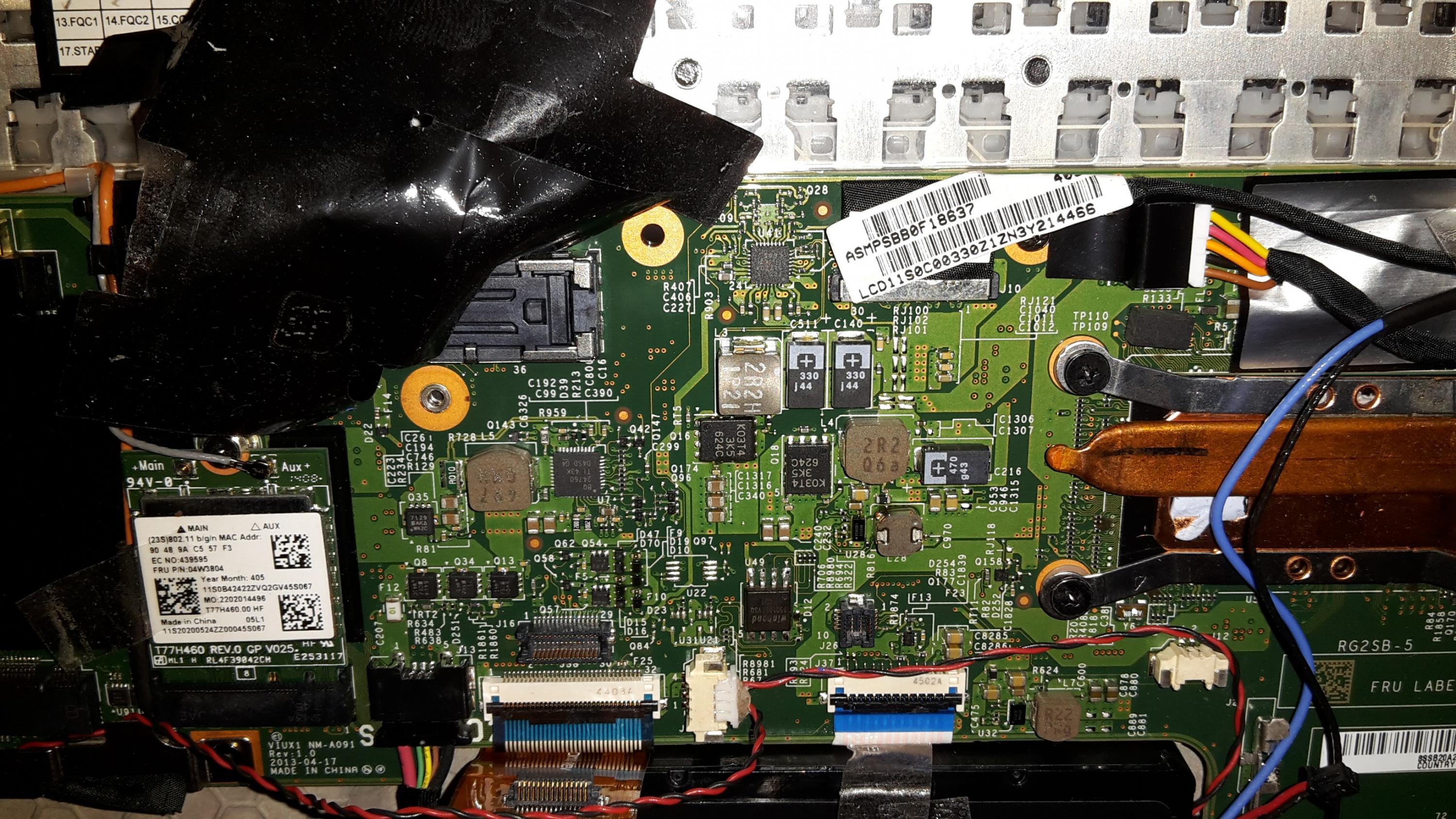

Lenovo x240 how to locate TPM CHIP
  • sstamenov91
    • Mar 2016
    • 47
    • Bulgaria
    Can some one help me to locate the TPM(Security chip)

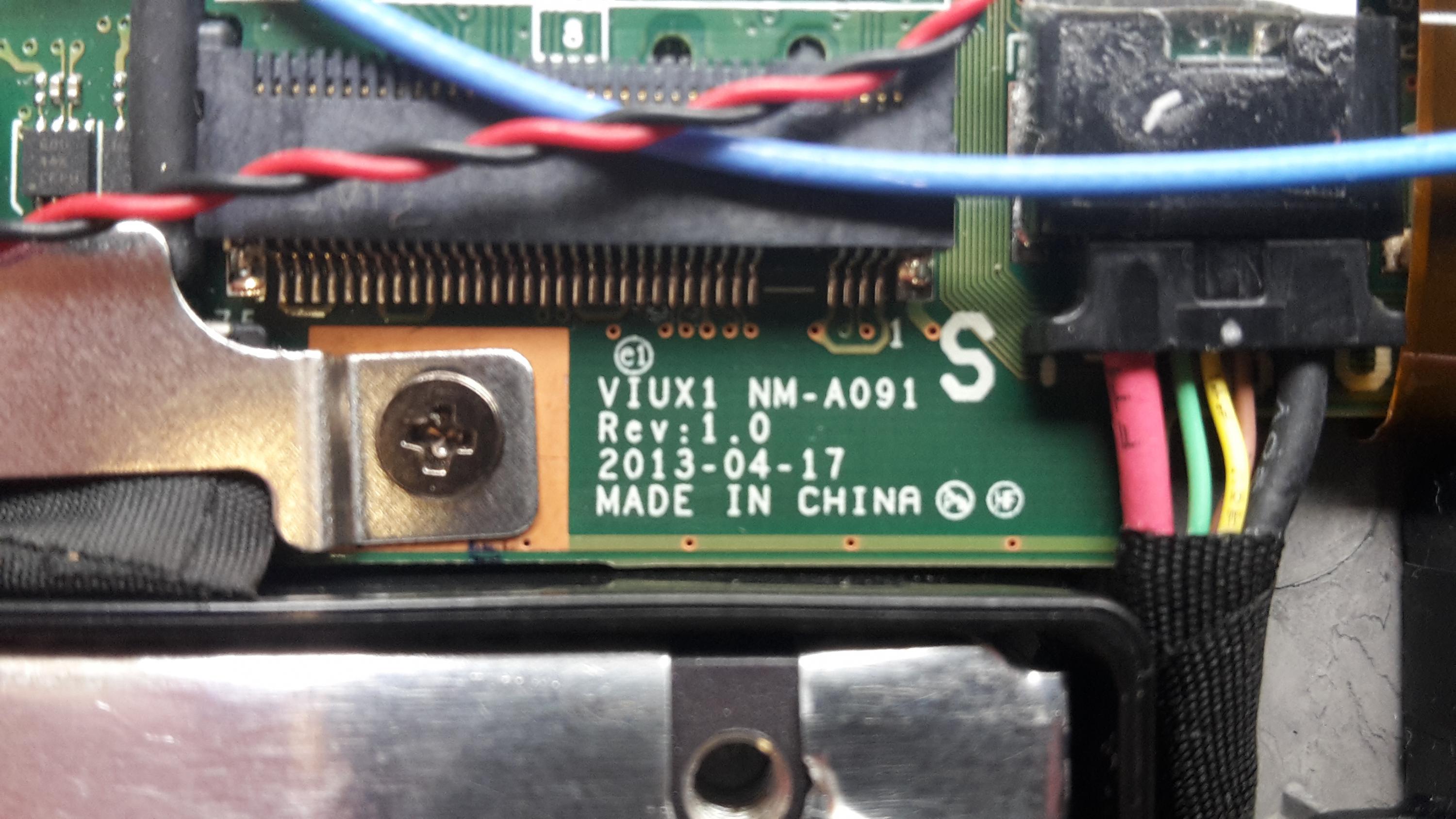

    Re: Lenovo x240 how to locate TPM CHIP
    which platform (marking) motherboard?
    • sstamenov91
      • Mar 2016
      • 47
      • Bulgaria
      yes motherboard
      • passete
        Living=Sharing
        • Jun 2015
        • 487
        • France
        He is asking for the mobo reference that is marked on, i think !

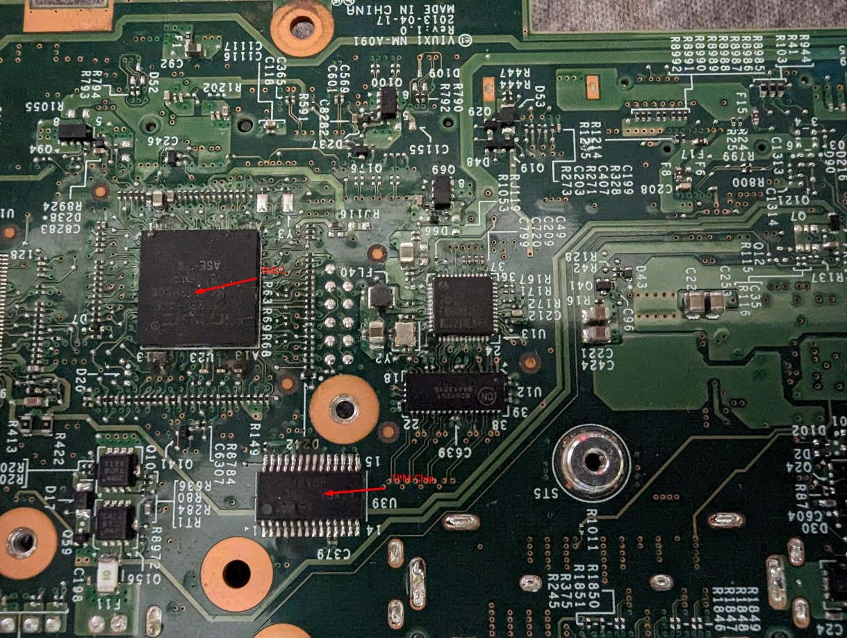

          Usually is a standard memory chip
          • sstamenov91
            • Mar 2016
            • 47
            • Bulgaria
            I wish i know witch is the chip on 100%
              Can't you read the motherboard reference ?
              All Mobos have a reference printed on it.
                there should be no other chips with the same features, without a schematic you have to desolder the chip or one pin and restart the system. If there is an error in the boot that is the right chip.
                    you mean this ?
                        The TPM holds the key to encrypt the hard drive, not bios passwords.
                        • kotnatan
                          Banned
                          • Apr 2014
                          • 181
                          • Ukraine
                          bios passwords it located in KBC (EC) multicontroller МЕС16ХХ
                                See attached for the location of the TPM Chip on X240. The top one is SMSC, and the bottom one is TPM. Let me know if you need anything else.
