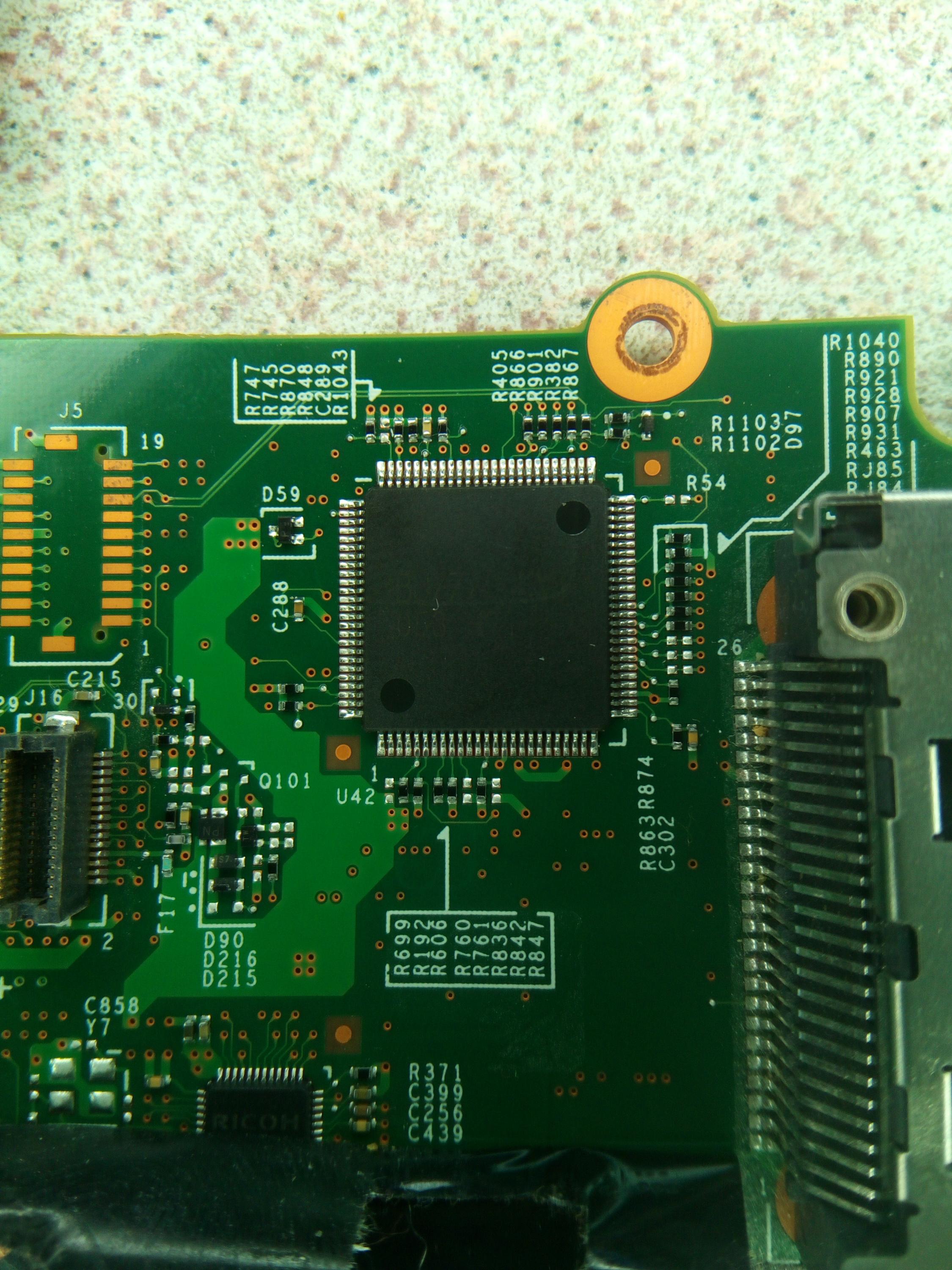

                      The lapto pcame again with the same problem "FAN ERROR" on screen.
                      This time I thought to investigate a little more.
                      I gave a look at schematics at page 69 which is the fan connector.(the schematics is not 100% accurate. the Q1 in schematics has 8 legs in my board has 6)
                      I measure at q77 which is the fan voltage 5,09V on pin 3 and no voltage on pins 1 and 2.
                      At Q81 I measure 3,37V at pin 3 and no voltage on pin 1 and 2.
                      At Q1 I have 5,09V on pin 1 and 5,09V on pin 3 or 6 (I don't know exactly what pin is because the schematics are not exactly the same) and no voltage on all the other pins.
                      Also in c301 I have no voltage and neither on pins 1,2,3 on fan connector.
                      Can someone quide me what could be the problem?

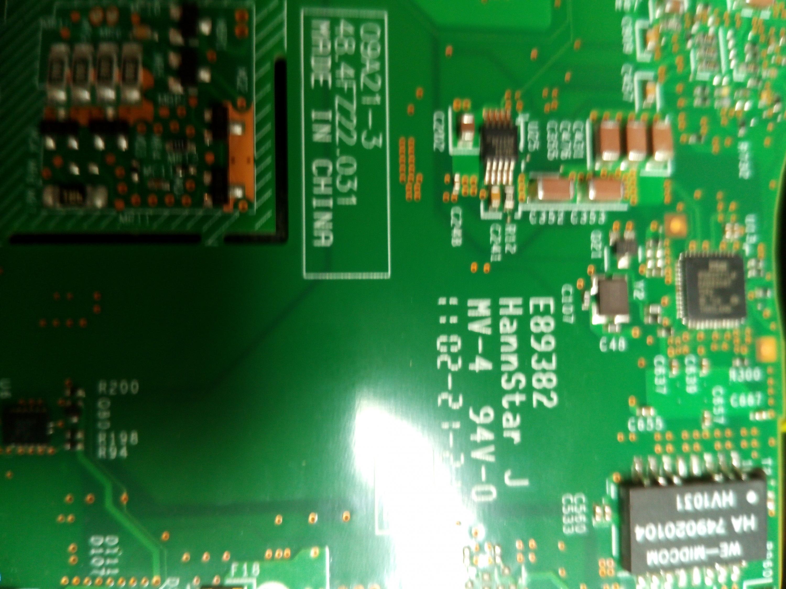

                                  On pin 2 of q77 I have 3,36V when I pres the power button and then after 2-3 seconds goes to 0V.
                                  I couldn't find the R987 and the 34 pin of U42 doesnt have a resistor.
                                  I am attaching two images of U42 and the type of motherboard maybe someone have better schematics.
                                  • atsio
                                    • Oct 2013
                                    • 819
                                    • Greece
                                    Re: T410 strange problem
                                    I' ve told you to measure on R987 and not on pin 34 of U42 because it is easier. R987 is 0 ohm and probably not installed. Measure on pin 34.
