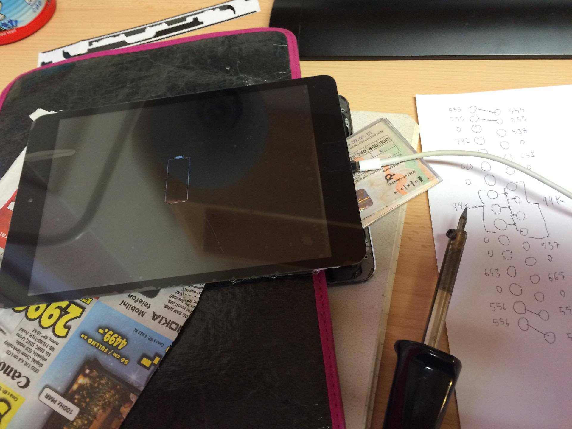

    i changing iPad mini connector, all pads are OK, but the +5V power pads have infinity resistance against GND. Is that normall?
    Thanks for help.

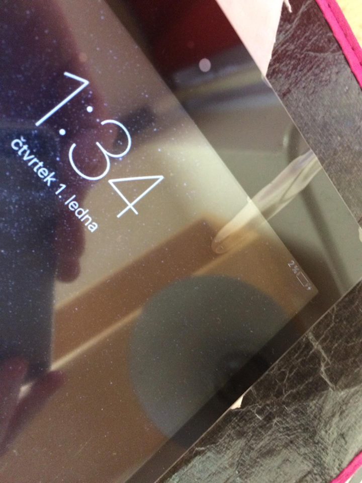

            First measuring was probably uncorrect
            I finally soldered connector and it works, charging, starting.
            Thank you very much
