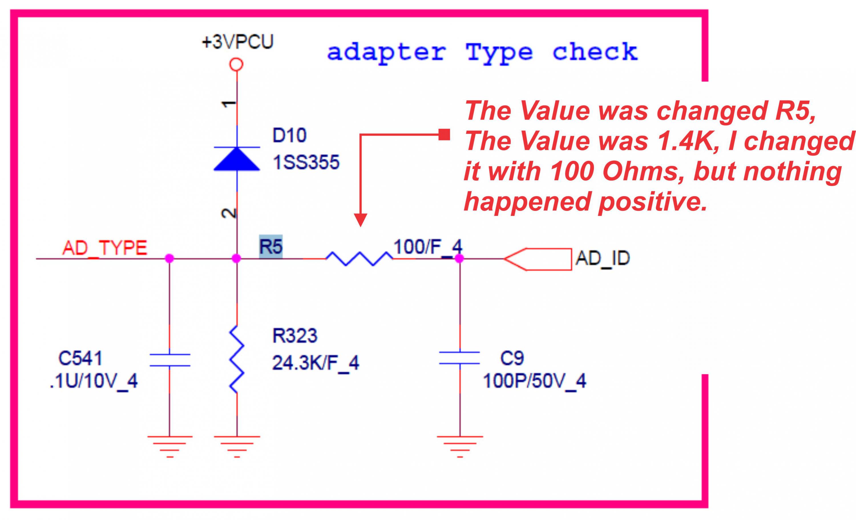

                        Re: HP DV6-3141se wont power up with charger
                        Hey Ktmmotocross,
                        I'm gonna sending you an attachment, Please check this.
                        • sonunigam
                          • Aug 2013
                          • 151
                          • Pakistan
                          One more thing, I've changed R5 because it was devalued, So i changed it with 100 Ohms the original one, but nothing happened positive.
                          Any help?

                            when connect charger pq3 must short that 8.9V to ground. chck for acokin and acin signals

                                check acok and acin signals. u must have signal on pq3 to short acok# to 0V
