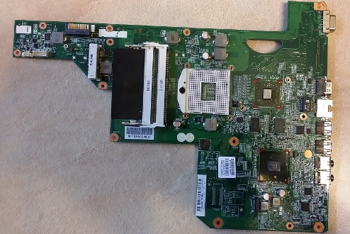

    recently i acqouired hp G62-b63eg xf235ea# with no backlight problem (it has backloght untill windows is loaded, then dim)
    another lcd did NOT solved the problem, so i did reflow and it worked
    its i5 + onboard intel + descrete vga
    motherboard foxconn star federer
    pn: 01013Y000-575-G
    PM_I_HPC_S_MV_MB_V3
    BY FOXCONN
    E253117
    two days ago VGA stopped working again, caps lock blink... since i do not need performance and i do not own rework station, i was wondering could you help me disable discrete ati vga on this motherboard and switch only to intel uma vga and like youve done with that dell

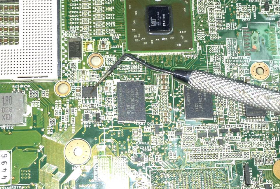

              Re: hp g62 help disable DSC vga
              if you kill the main line , it will disapear and no longer bug you
              chek pic
                  chek pic
                  tnx for help, yep your solution worked as a charm.. you are true magician, hope i will learn this stuff too.. temps go down as i disabled desc ati, it no longer appears in device manager
                          if we are talking about this hp only remove PU320
                          Im Back... sort of...
                            dj ricoh i was wrong , not the fet , you must remove DGPU output ic , usually pu320

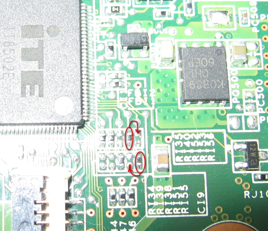

                                    to fully convert form DSC to UMA either remove PU320 or disconnect PJ19
                                    then switch resistors like in pic
                                    RI53 RI56 and RI51 RI55. -> SKU ID UMA
                                    works 100%
                                    sometimes you need to reflash bios after conversion

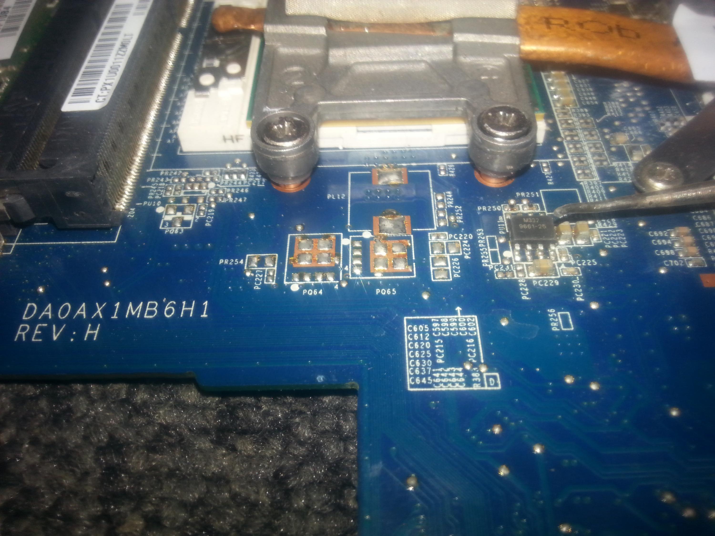

                                        hey guys can this work on da0ax1mb6h1 board this is hp62-361tx.
                                        there is no pu320. i had locates ic but not sure for that am sharing the photo below. in this board i think that ic is pu11. and m also not having schemantic. too
