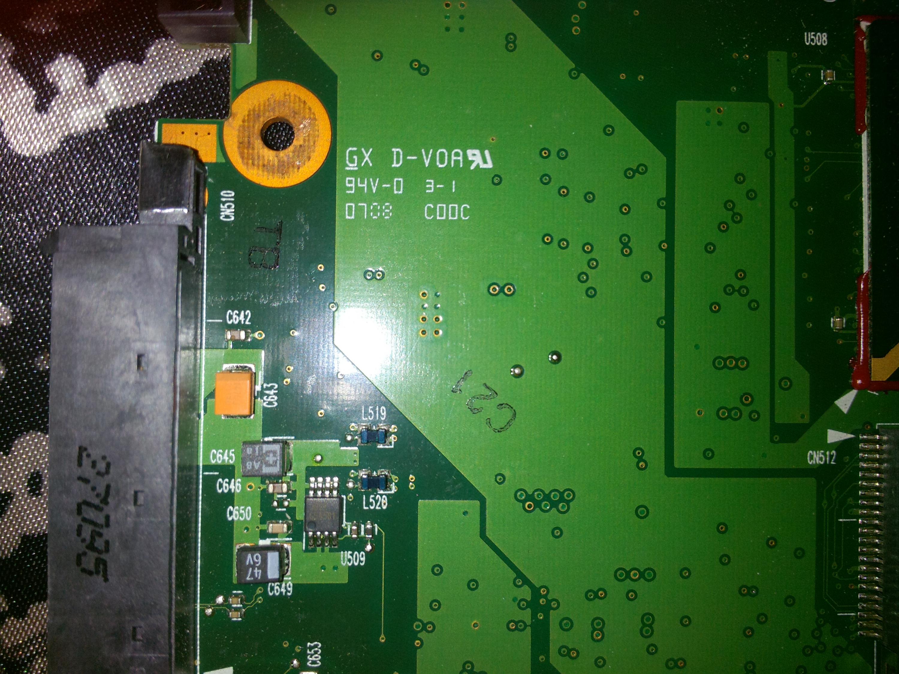

          Would a picture of the power supply area of the board help?

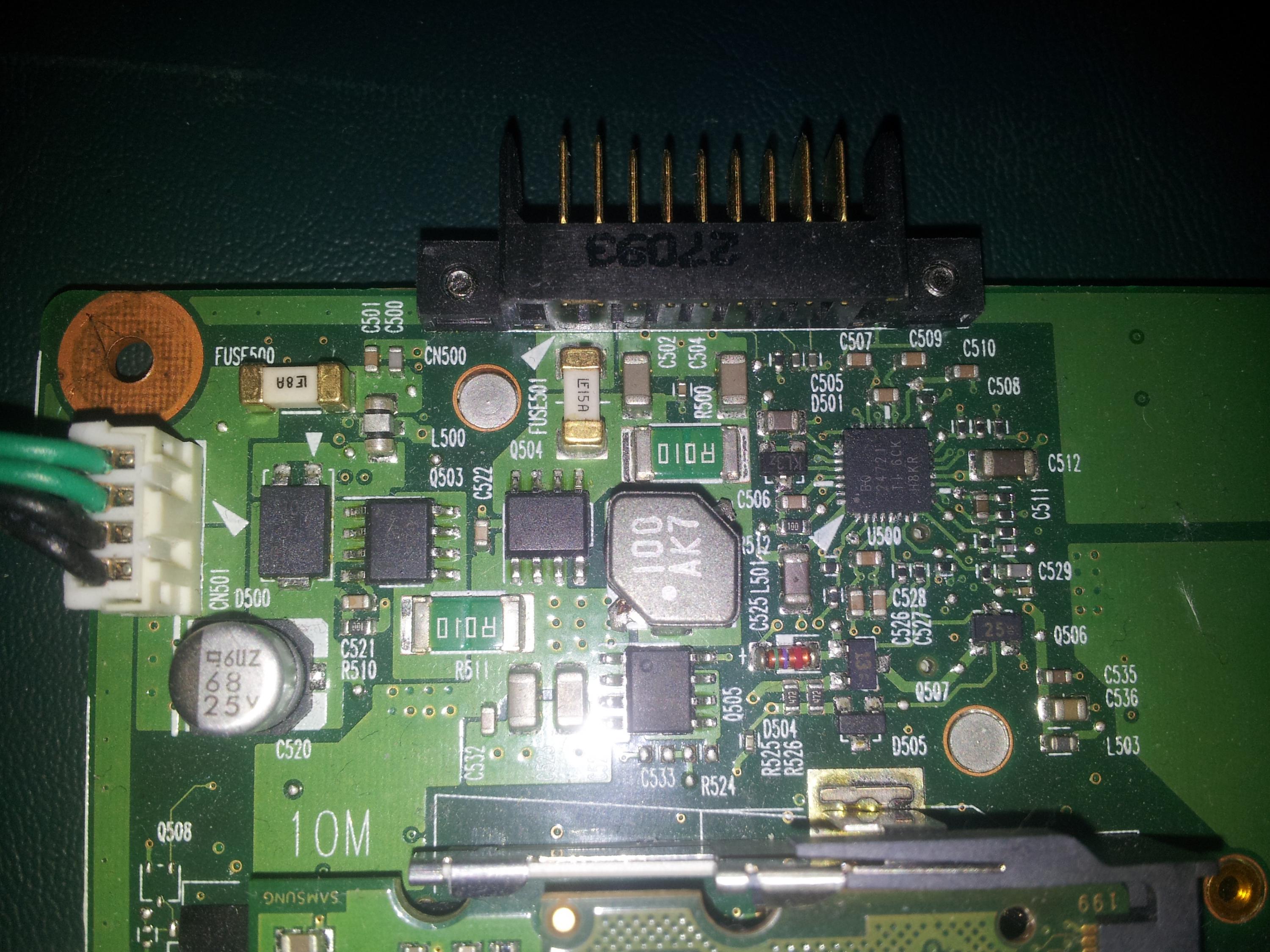

                    I have posted a picture of the power supply portion of the board and I see 3 of the devices that you described. I have a fluke 87 V multimeter so what pins on these should I test? I looked up the MOSFET datasheet and apparently it is a P-Channel MOSFET so how do I test that? The two fuses also test alright.

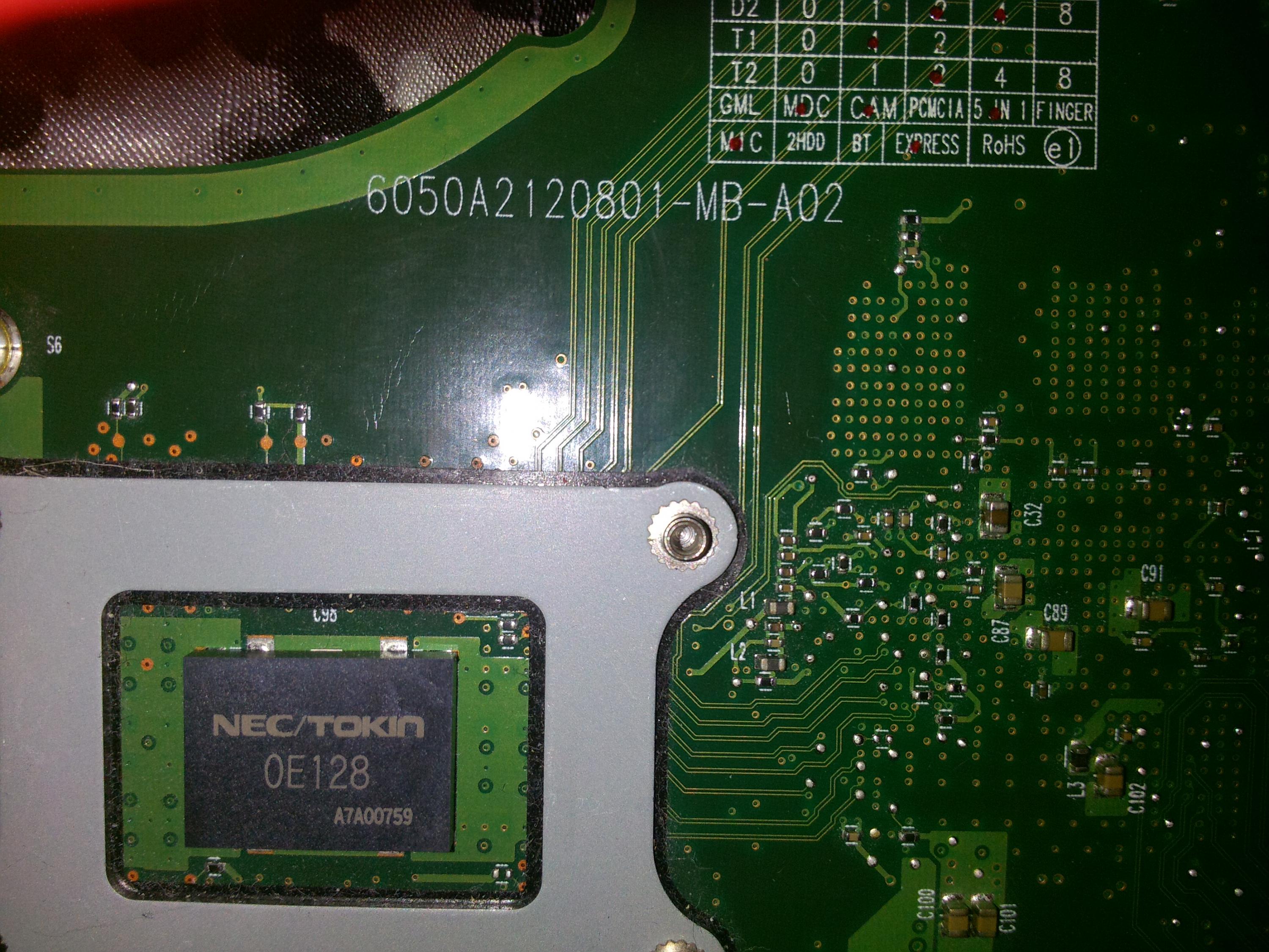

                      Give board info, markings on board.

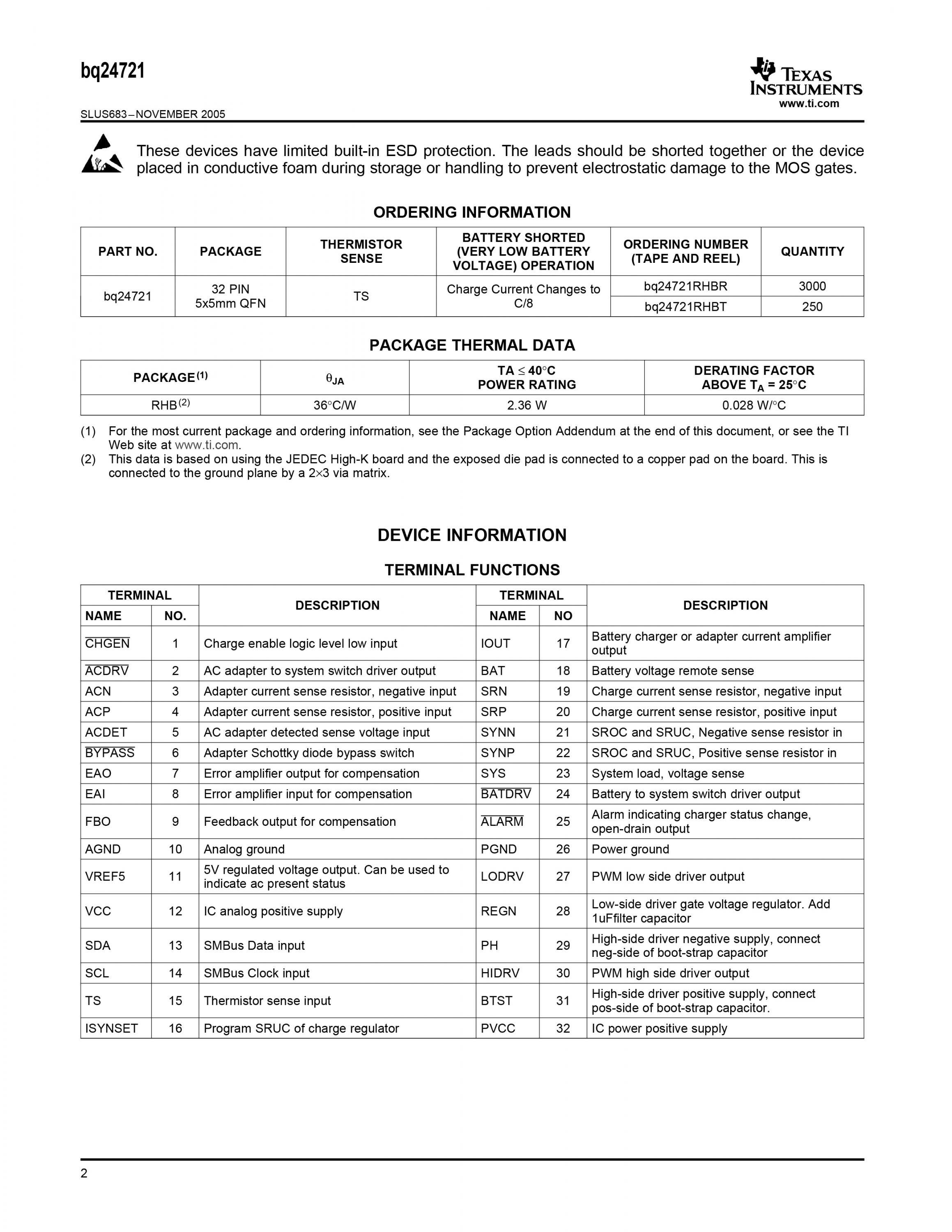

                        Hi, check the voltages on all the pins on the U500 chip, when it's on and after it power down. You will see if it's this chip the problem.

                          Here are pictures of the numbers on the board.

                            Can you point in a picture where you've shorted the battery connector?

                              I've attached the datasheet for the chip and also an image of all the pins and their functions so is there any specific pin that I should test? I went over with the oscilloscope and the voltages seemed to be ok but I had no idea what I was looking for.
                                so where are the values ?
                                every component on the board shows voltage on scope.
                                depends how you arrange them!

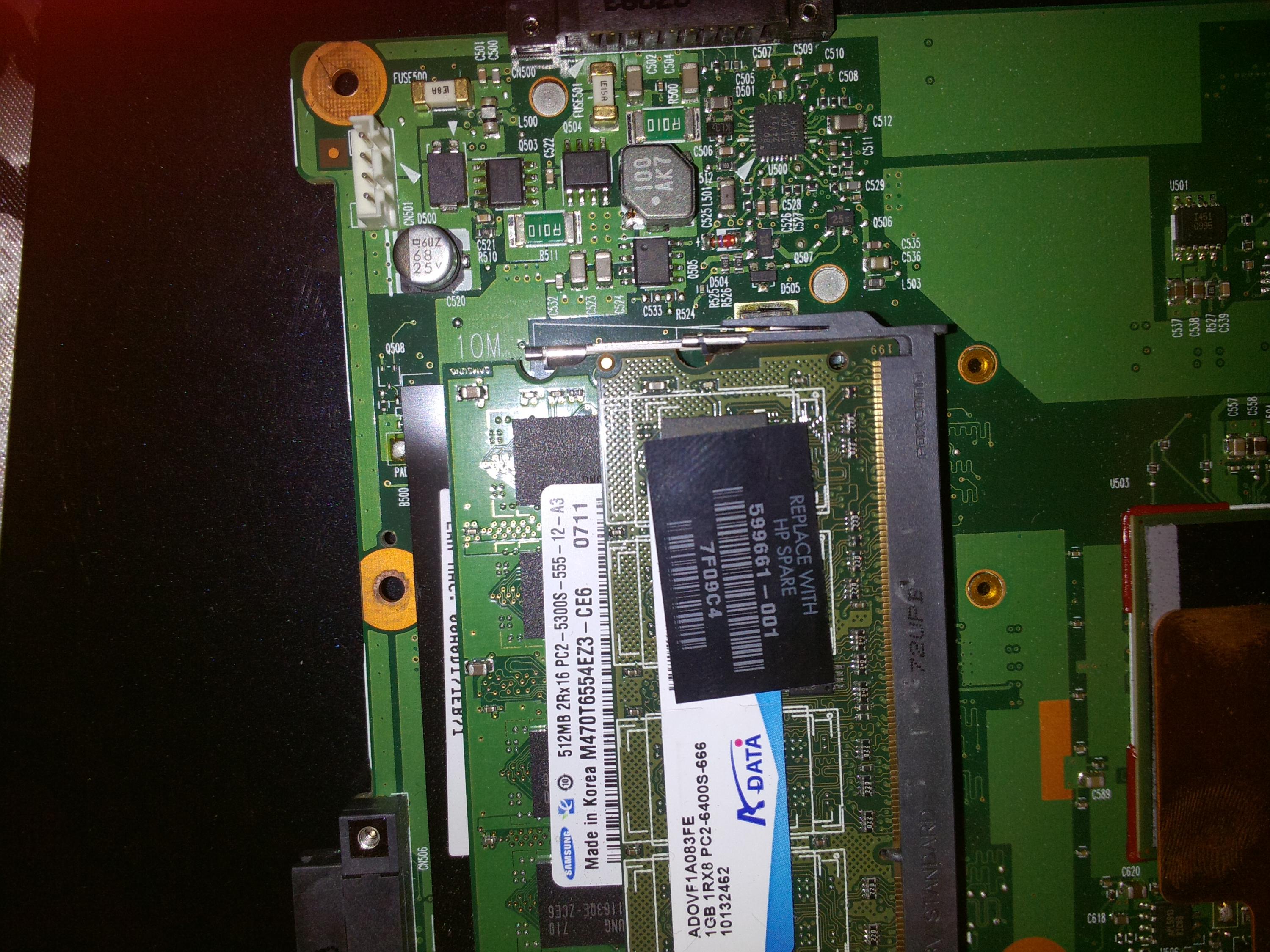

                                  I have attached a picture of the power supply portion of the board. I'm not sure but I think two of the outside pins on the battery connector were shorted together. I'm not sure which two.
                                  Are there any specific pins that you guys want the voltages for? I don't think the forum would like me posting 32+ waveform images.
