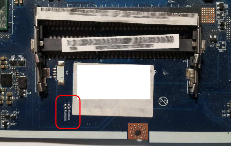

                                        Re: Acer 5742G dead after stress test
                                        While you wait for the programmer try reseting all BIOS settings to default.
                                        Incorrect values (assigned or recorded, e.g. temperature, ...) might have been stored.
                                        To archive this you have to look for a 4 points jumper located very close to the RAM door / socket, labeled "RTCRST" & "SRTCRST".
                                        Short them all together.
