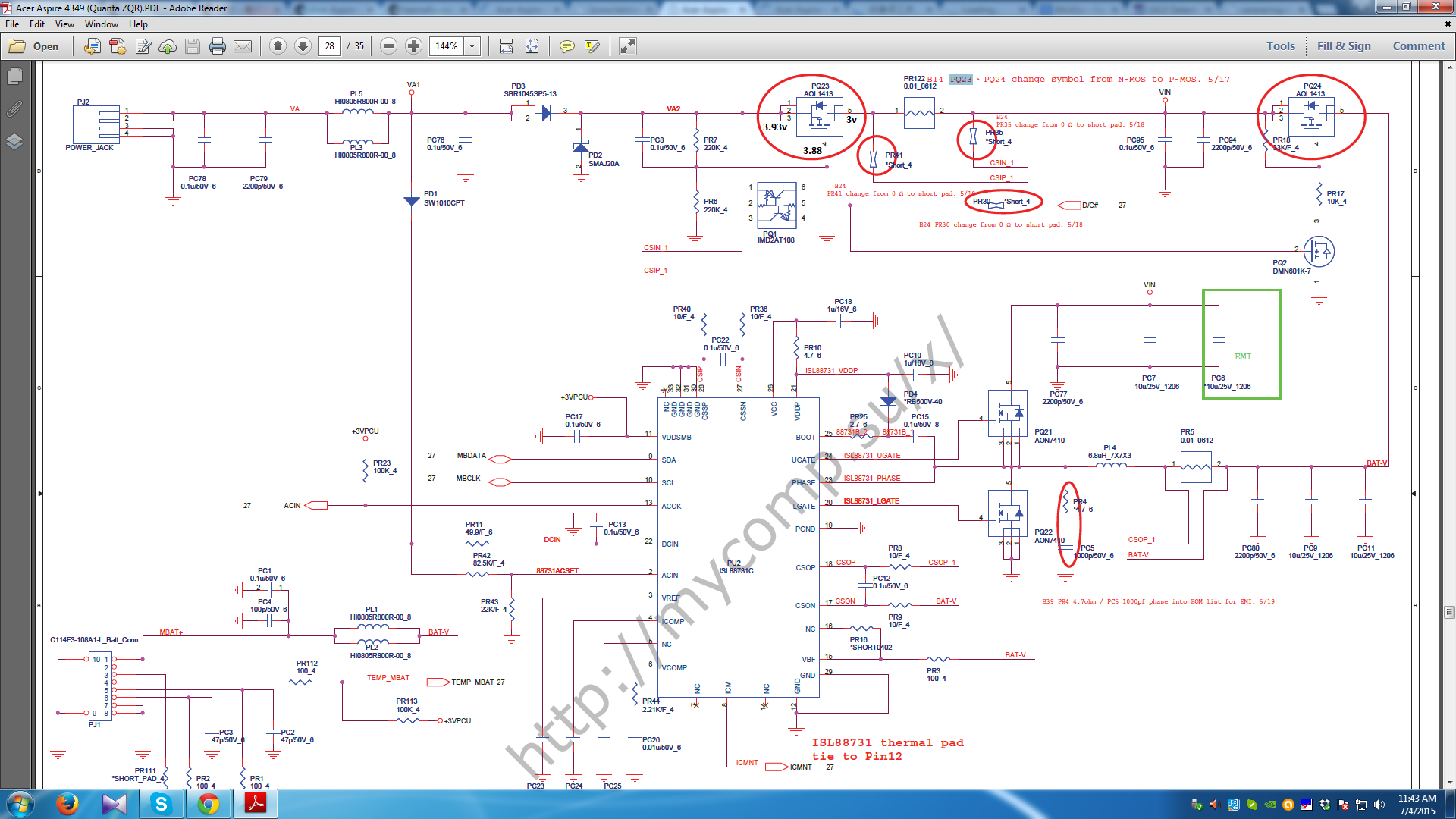

    i got one acer aspire 4349 shorted somewhere till now i cant trace.
    i feel hot when touch with finger on PQ23 (AOL1413) and i found this mosfet already blown. i know blown when i test with continuity test and i got beep sound. i think rail 19v was shorted
    i try replace with AO4433 for testing and also hot when touch with finger. i dont know how to trace where short. please help me.
    please refer attachement

              i may to try with 15v on leg 5 PQ23

                  hye meritosari im remove pq23 and now i injected 5.0v only and i found mosfet on PQ26 was hot.
                  for measure on others parts more info
                  1. im removed PQ23 and then check for short to gnd PL5 and PL3 the value is = 243.4 ohm
                  2. check for short in PR122 i got 20.1ohm
                  3. im check for short to gnd on PQ23 pin 5 also i got 20.5ohm

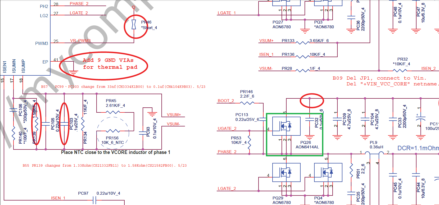

                                  update after inject power apply pq26 is shorted. now im remove and no short. without pq26 and i place back pq23 the was no short and ampere increase 0.6600A with stabile 19v.
                                  *next i need to replace pq26 (AON6414AL) also PQ23(AOL1413).

                                      yes finally im solved the problem. the shorted component is PQ26 its not pq23. now the display is come into normal.
                                      what i do
                                      1. place back PQ23
                                      2. replace Pq26 with AO4406 same channel (not sure for compabality)
                                      3. its not any brown cap always i has seen before, its upper mosfet line 19v rail
                                      thanks to all together help me.
