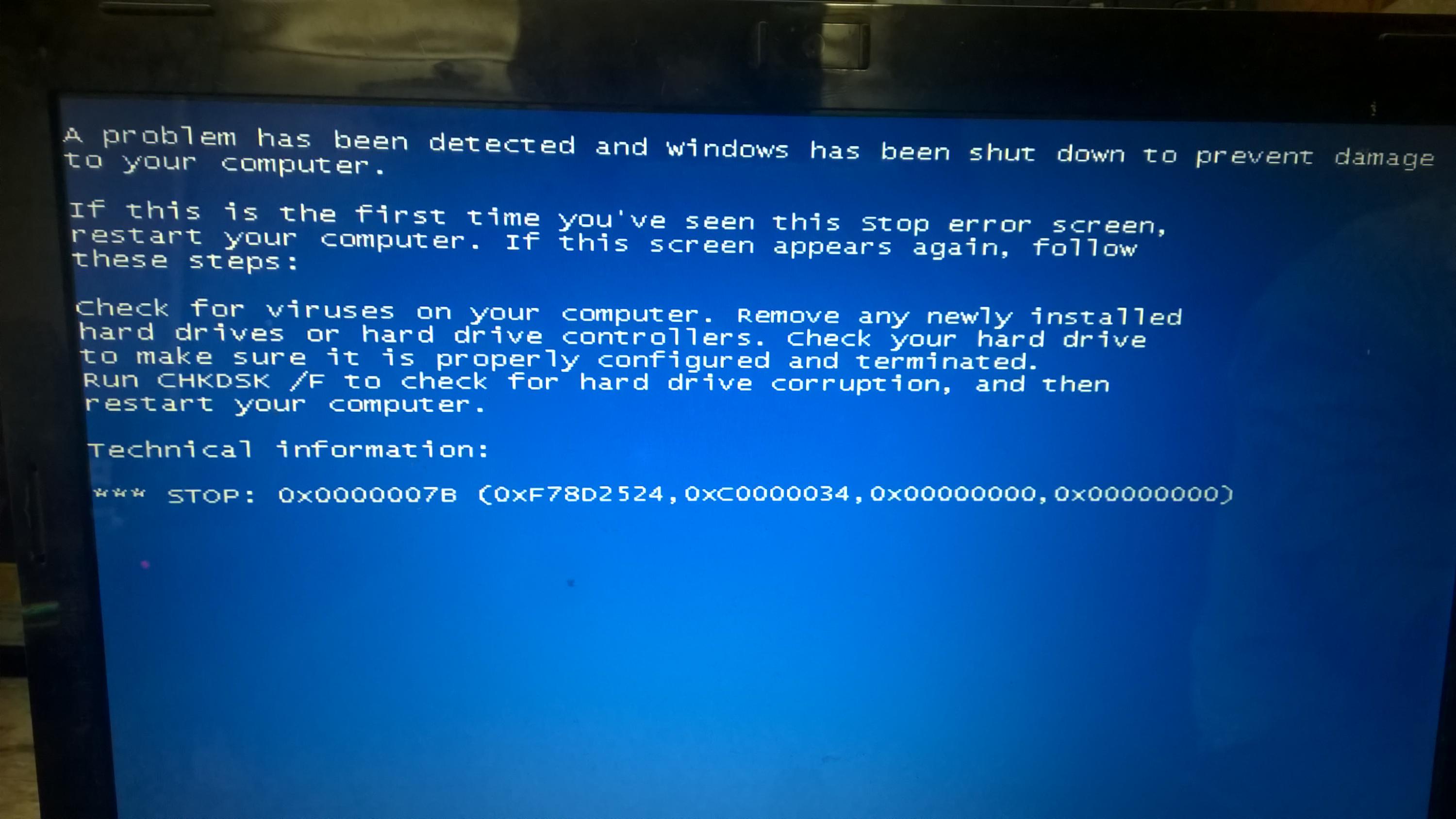

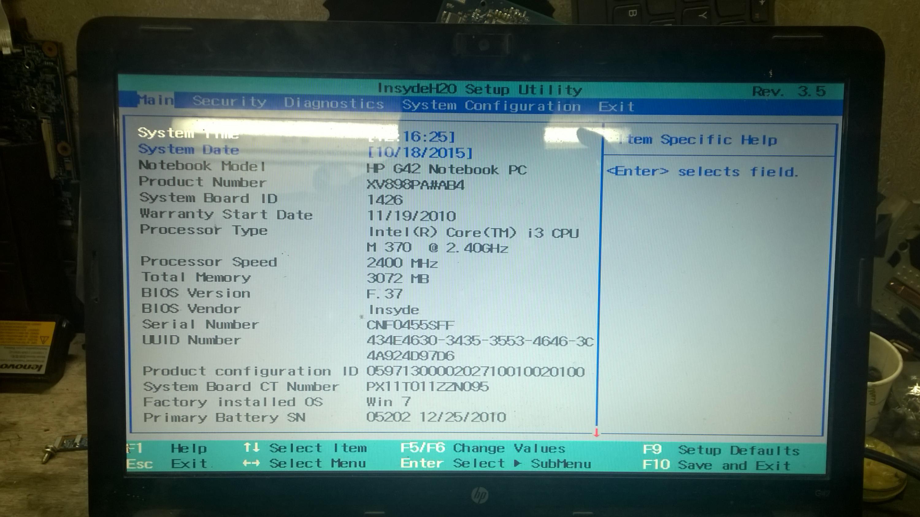

    i want install windows xp itried to booting but blue screen only appear .im going to bios . no option there in this bios ACHI to IDE mode . how to enable that option .already bios update done
    [inside h2o bios ]
    http://support.hp.com/us-en/drivers/...30AQO5O3KA30R1
    anybody have insideh20 bios tool
    pls edit this bios and enable that option
    i dont know hou to edit

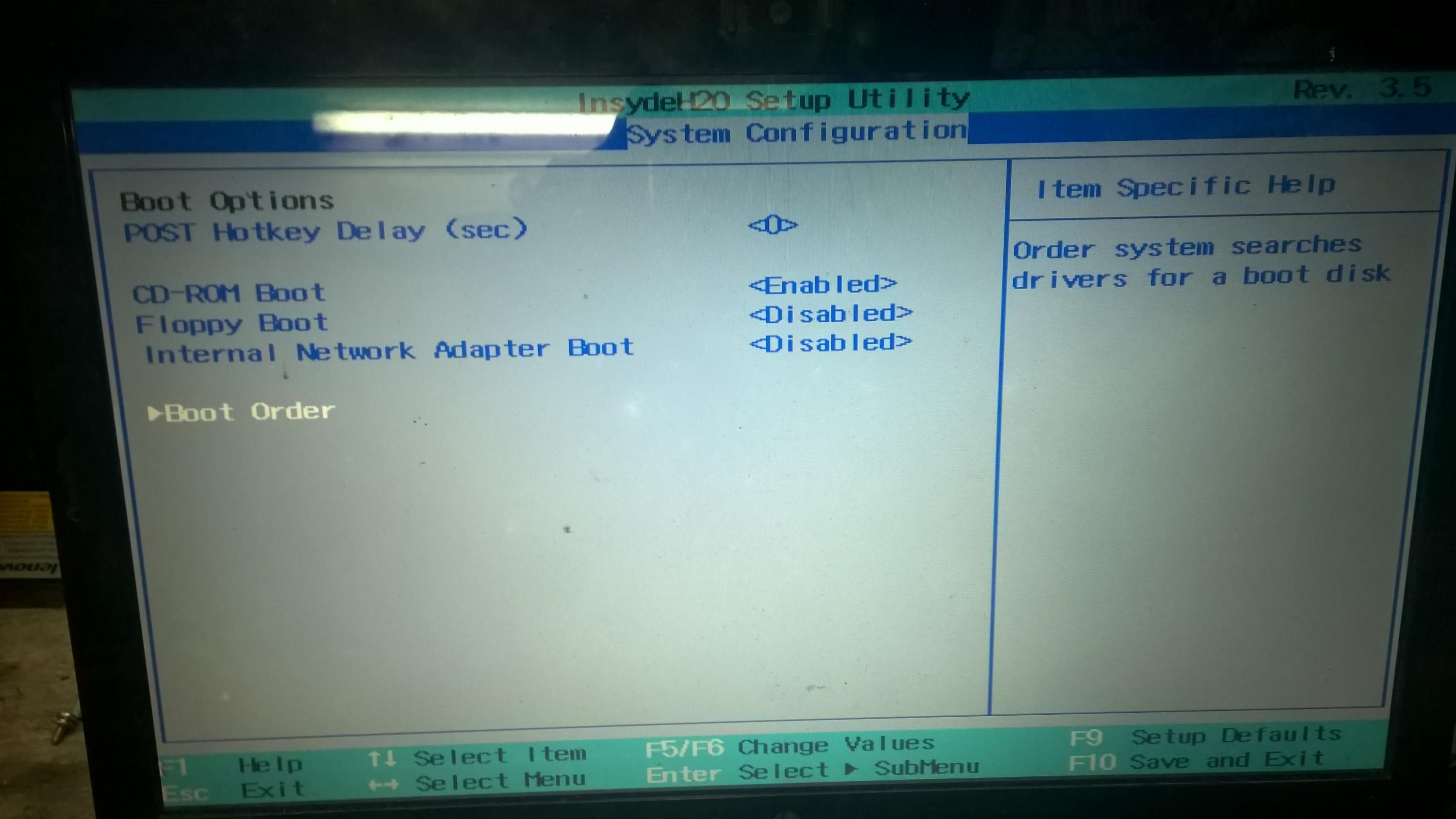

    Have you selected the correct order to boot ? Why are you installing XP and not 7 ?
    XP and 7 will both install in IDE or AHCI mode.

      You need to install a version of XP which has the SATA drivers integrated. That way it will install in AHCI mode too. However you may not find drivers for the soundcard and GPU. I would agree that installing XP on this laptop is not a very good idea.

        win7 and win8 os installing ok working also good . but i now need only win xp for this board . when insert xp boot cd try to boot after bluescreen will only come .but tried win7 os installing suceess . so i need to edit this bios switching to achi to ide mode for win xp os installing bios already up to date but no switching option there achi to ide . then how to install xp ?

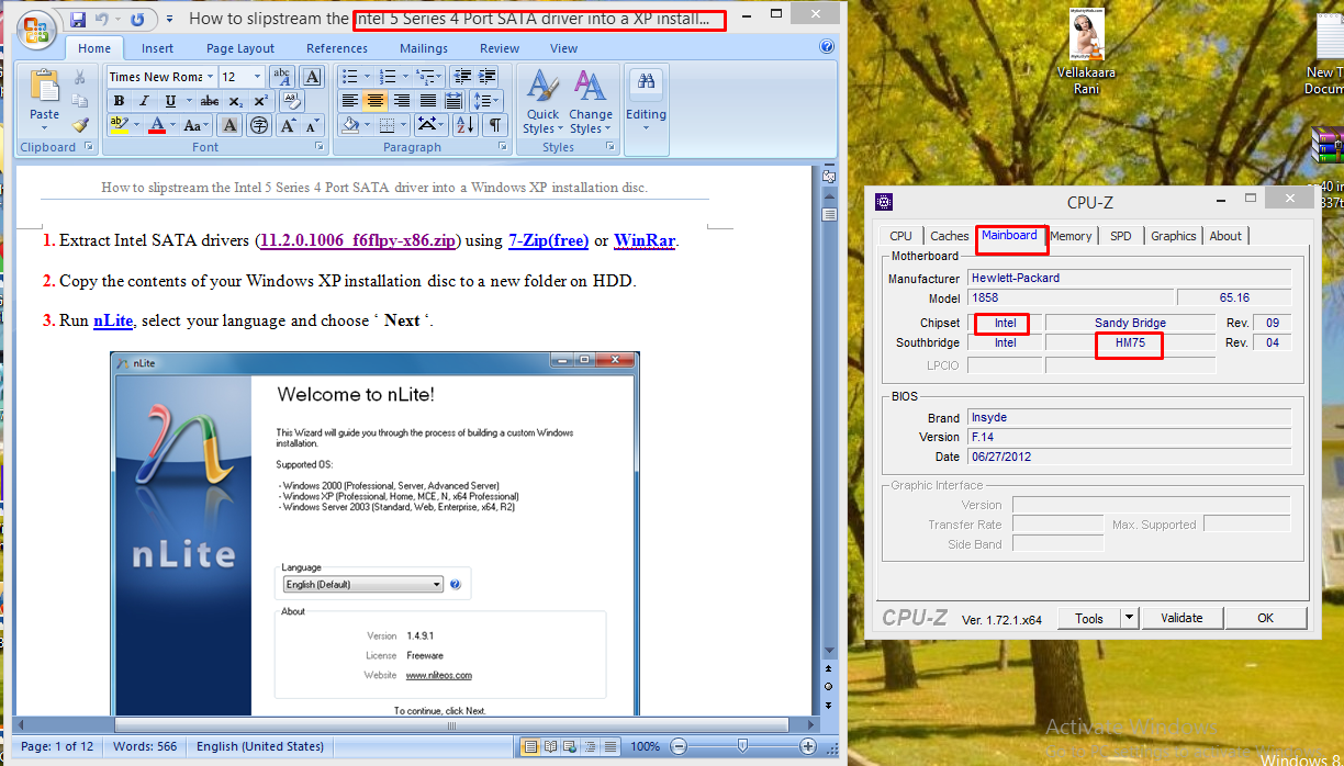

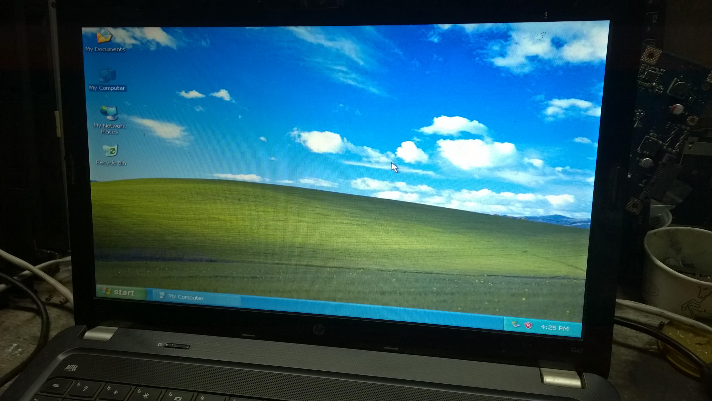

            Re: Hp laptop

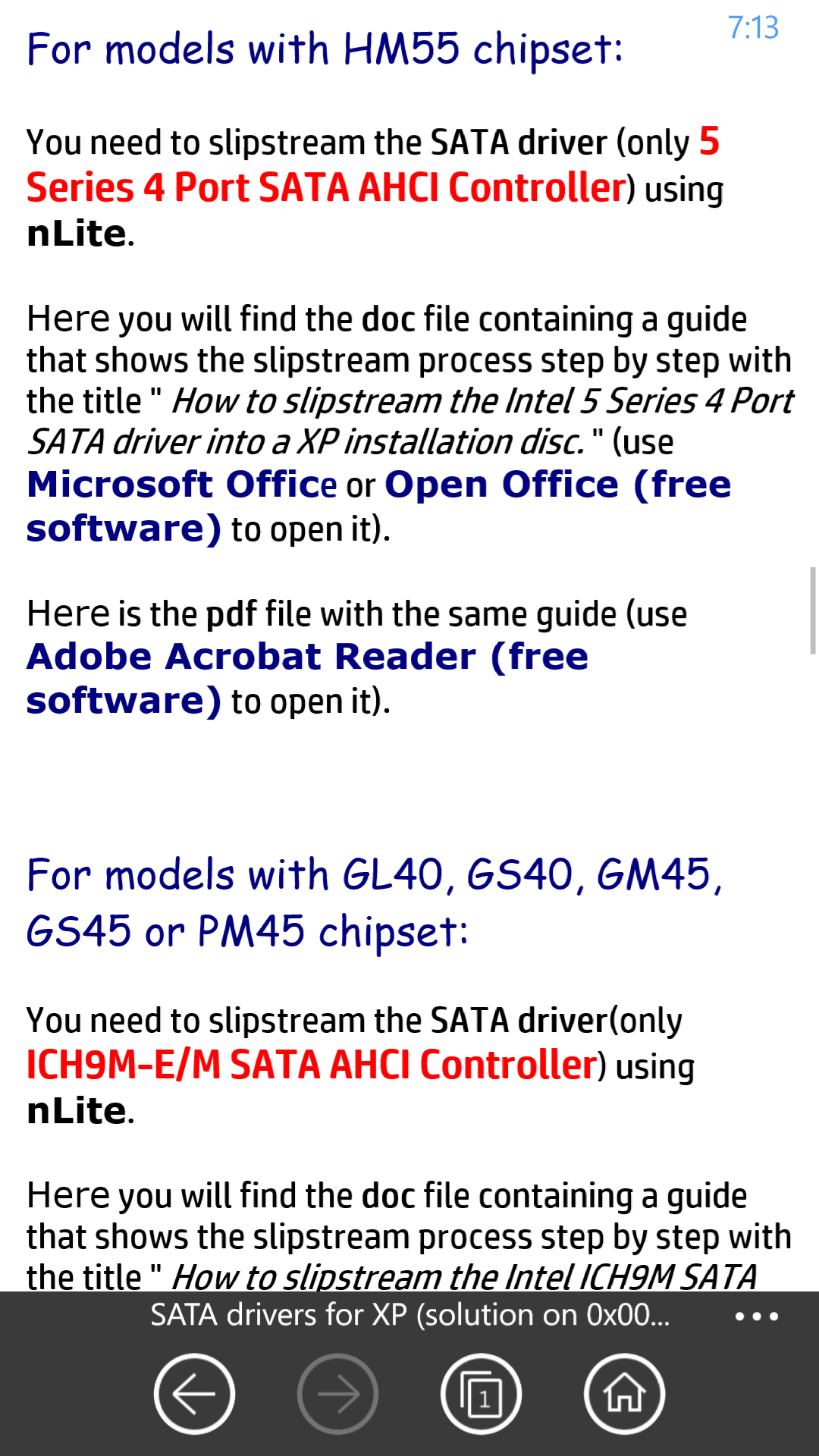

            http://h30434.www3.hp.com/t5/Noteboo...SOD/m-p/114120
            using this method edit windows xp os . for import suitable chipset sata achi driver to bootable windows xp then everything success
