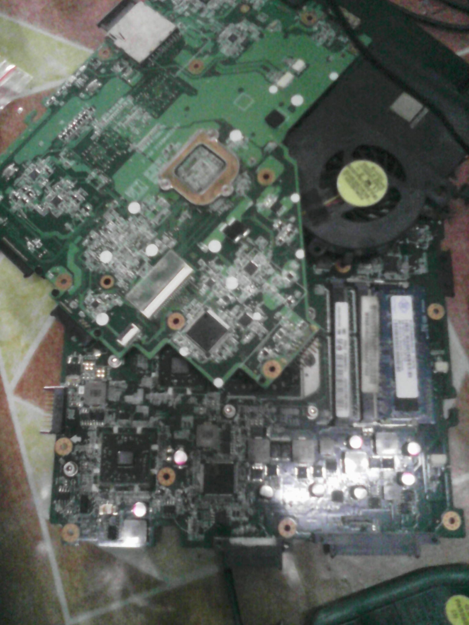

    I have an acer 4250 that can not power on when i pressed power button. But it have 3v and 5v always on. With battre and dc pluged.. 3,3v power button pin ok. Is there anyone could help thanks before.

              Re: acer 4250 can not power on
              I have reflash BIOS, but still can not power on.
                find the KBC controller and write back the model.
                that the only place where you can find something wrong.
                  It is NPCE 791LA0DX.
                    Anyone knows how wpce791la0dx works or not?
                      I have replaced ec/io/kbc. Now laptop turn on but only fan spinning no light an then turn off again. Any adea?
                          Acer 4250
                            I found bad prosessor. I can not replace the prosessor its Soldered onboard.
                              how did you found out its bad?
                                There is a caps 0 ohm. Its un usual. If its 25 ohm its normal. You know that right!?
                                      Are u sure processor is cultprit? What status now solved or not
                                        thanks for your kind before,
                                        the fan is rotating sir, but current stop on 0.5 A with ps
                                        please help me ...
