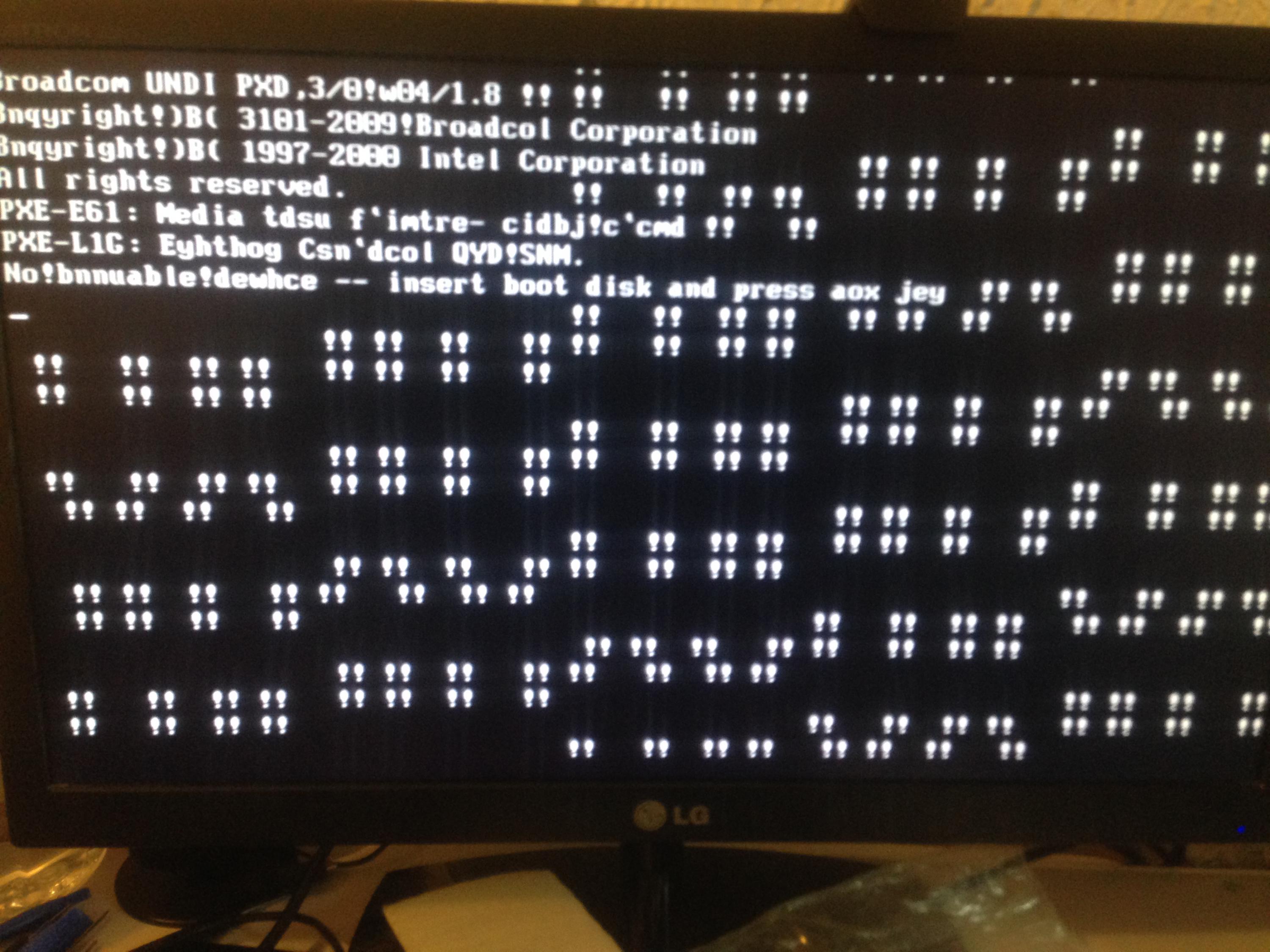

    i got this notebook with GPU problem. I order new gpu and install it. After that i do not have picture on LCD. On external i have picture with defects.
    Please what do you think i coud do?

    why do u order a new chip? just reball old.
    do refflow to better attach balls

      i did reflow but still the same. i will try to de reball on old chip. But i want to confirm that this is GPU fail and not vram.

        Looks like vram.

          i will try to do reball on original GPU and put it back but how to check vram?
