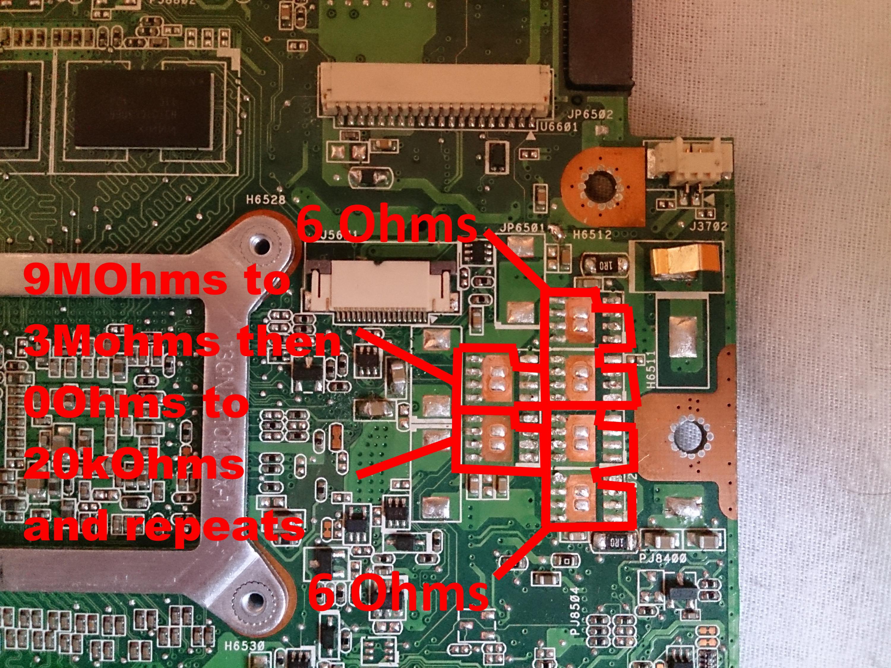

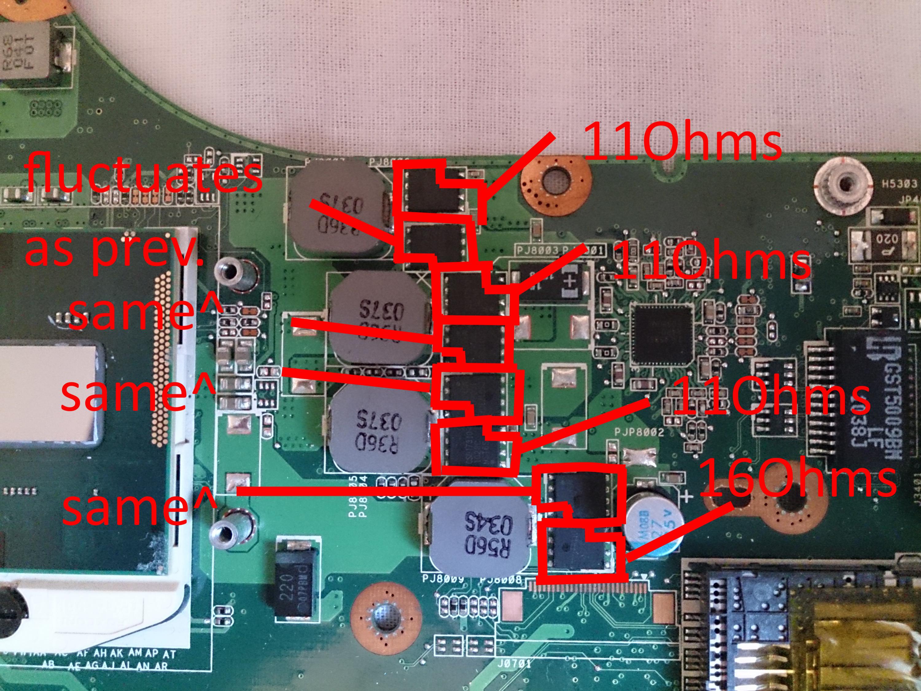

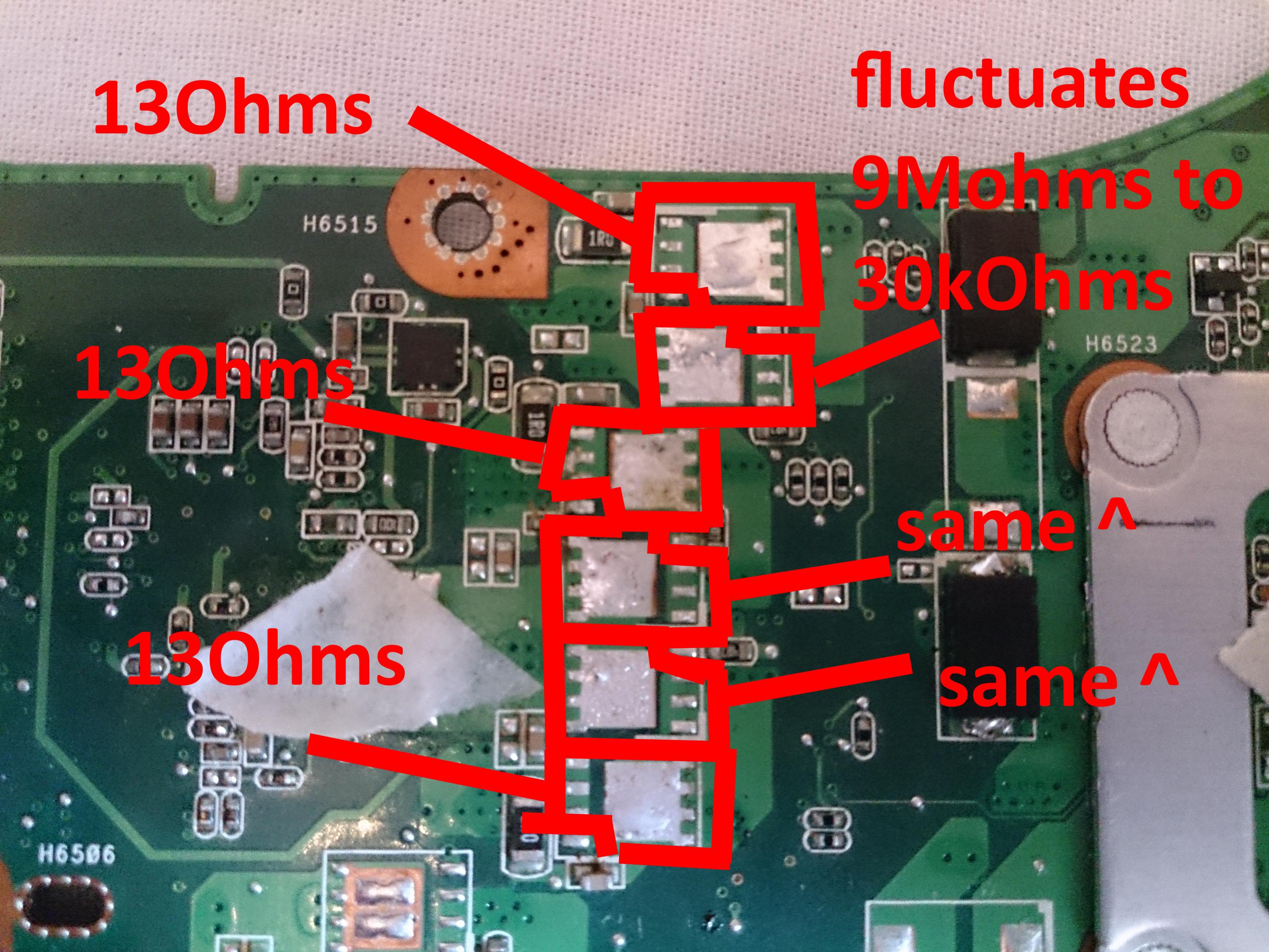

                • grahamw01
                  • Jan 2013
                  • 256
                  Re: Asus N53SV Dead No Power
                  please see attached.
                  They are all measured resistances between drains and gates, it seems where ever there is drain from one to drain from another, the resistance fluctuates repeatedly. It will drop from about 9MOhms to 3MOhms then jump to 0Ohms and rise to about 20kOhms, then repeat.
                  One picture shows some capacitors that look like they have already been replaced.
                  I have not yet tested the mosfets that are still visible (near the CPU)
                  Thanks!

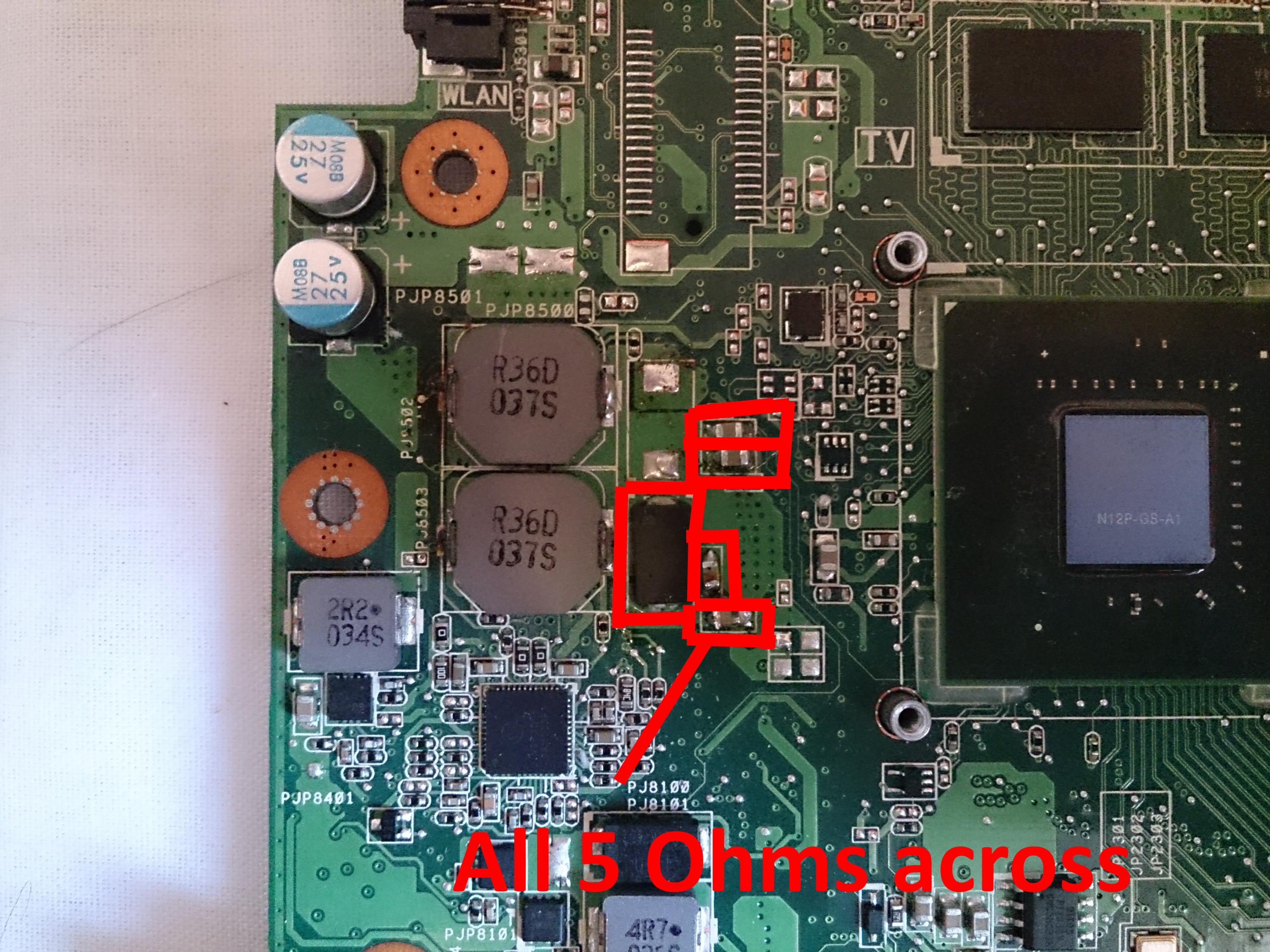

                    The 6 and 5 ohms resistance is a normal resistance for GPU chip.

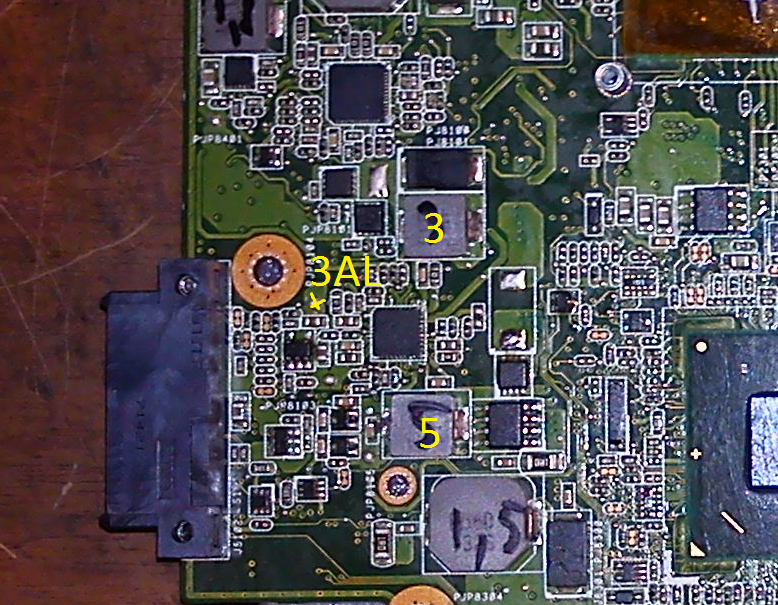

                    Lets assume that bios and EC are fine, then first things that are turned on when adapter voltage is connected are 3.3 and 5V.
                    Measure resistance from these 3 points to GND and post back results. They should show rather high resistance.
                    • grahamw01
                      • Jan 2013
                      • 256
                      3: 5.35 kOhm
                      3AL: 23.8 kOhm
                      5: 11 kOhm
                      Thanks!
