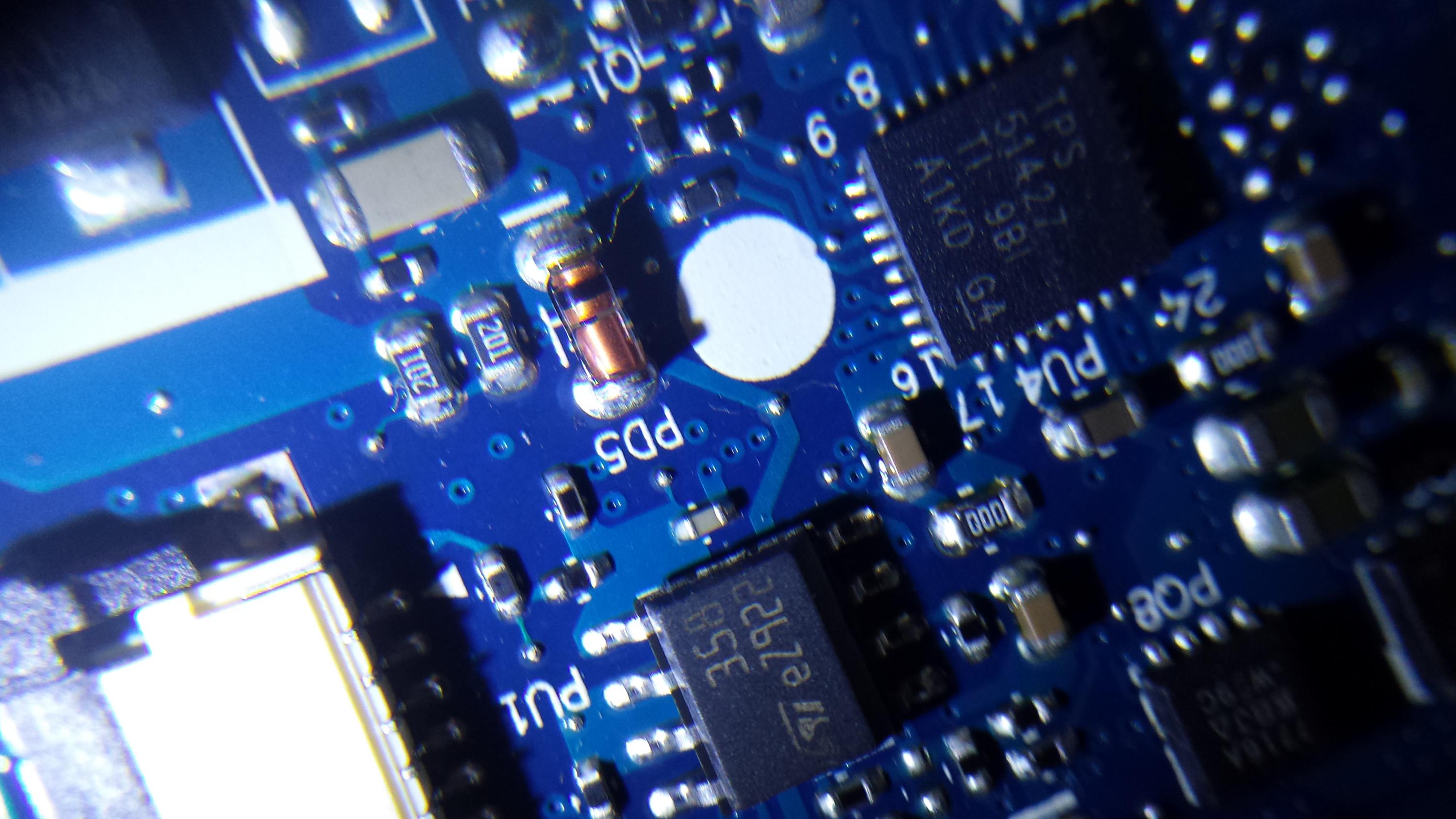

    what is this laptop SMD?
    What is this copper coloured SMD labelled PD5 in the picture?
    I have a netbook with no signs of life and thought they might be the problem. There are 4 of them near the battery and power terminal, some of them have 19v going in and coming out and some have 19v on one side and a couple hundred mV coming out.

    surface mount zener diodes.

      FYI
      LL4148
      https://www.badcaps.net/forum/showthread.php?t=24098

        I think a zener diode would have a different colored band or some other markings. That looks like a 1N4148 or a similar diode.

          The schematic will tell you what it is.
            Re: what is this laptop SMD?
            +1 for 1N4148.
            "some of them have 19v going in and coming out and some have 19v on one side and a couple hundred mV coming out." That is depends on how it is being used in the circuit so it does not mean it is bad.

              Laptops never use 19v inside they use a DC to DC converter and you get the B+ power used for be over 18.5v the B+ power also come from another DC to DC converter conected to battery.
              You need the schematic of the board or atleast a photo near AC in.

                BTW 1+ 1N4148 and it enver fail the isues from no light is a bios issues must check the 3,3v on bios or the usual shorted cap on any DC to DC converter.
