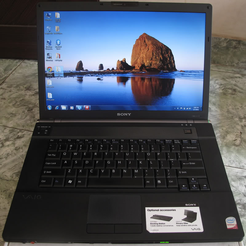

    My Sony Laptop died
    i never take my laptop outdoors, had it sitting on a cooling pad along with another large fan to cool it
    there's a green button to turn it on, tried Battery as well as adapter
    thinking its a Motherboard issue since CPU, RAM, HD were upgraded recently
    heard about "reflowing" but the idea of putting anything in the oven is kinda freaky
    if i have proper soldering tools, can i just add solder?
    specs:

    Re: My Sony Laptop died
    hi, problem and synthomus even not described well.
    does notebook fan spin when u press power button ?
    if so could be a bad northbridge or bad ram or cpu or corrupted bios.
    if fan doesnt spin:
    a) if u have 3.3 and 5 volt, could be bios, nb, kbc
    b) if no 3.3 and 5 volt, bad power circuit
      i cant even turn it on, i recently replaced the fan as the old one was worn out and made sure it was oem
      i like always like modifying things and it just wont turn on
      lot of people have had problems with jack for charger but like i said, it never left its spot in my room
        You've got a power issue there. Nothing about putting the board in the oven or things like that. Do you have a multimeter?
          i have a few...what should i be testing? i have it apart and can take pics
            First make sure your charger is putting the right voltage out by plugging in the wall and measure the other end. If voltage is good, I would pull the battery and then plug in the charger and see if any thing turns on. Any LED?
              Then I would start eliminating sections and see if you can get a led or power
              light. Even if you only have the main board and nothing else you should get a light of a LED or power light.
                FINALLY got around to fixing this. ended up buying a new Laptop and put this on the back burner
                thought it was the Motherboard after checking all suggestions, replaced and its running great!
