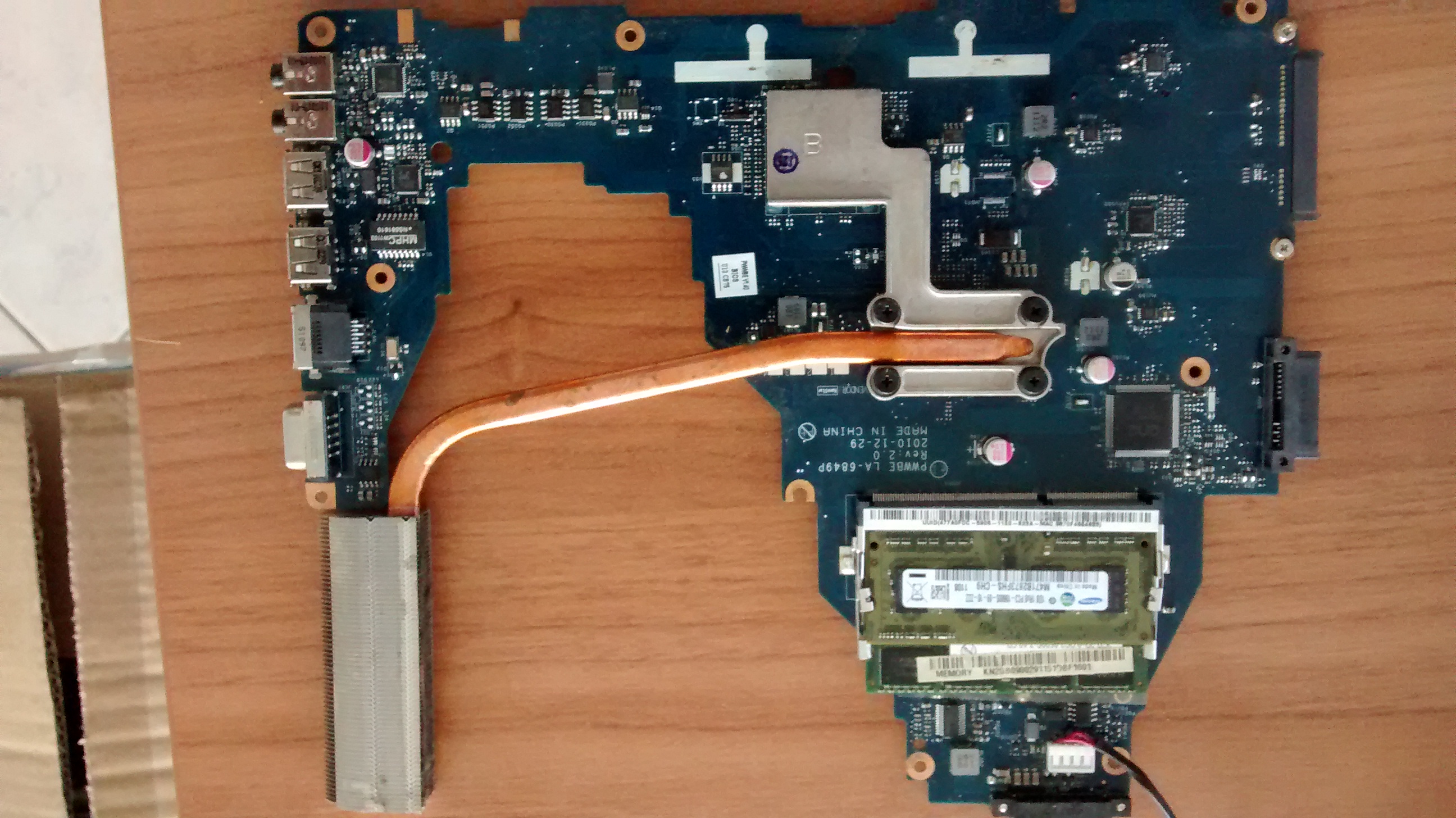

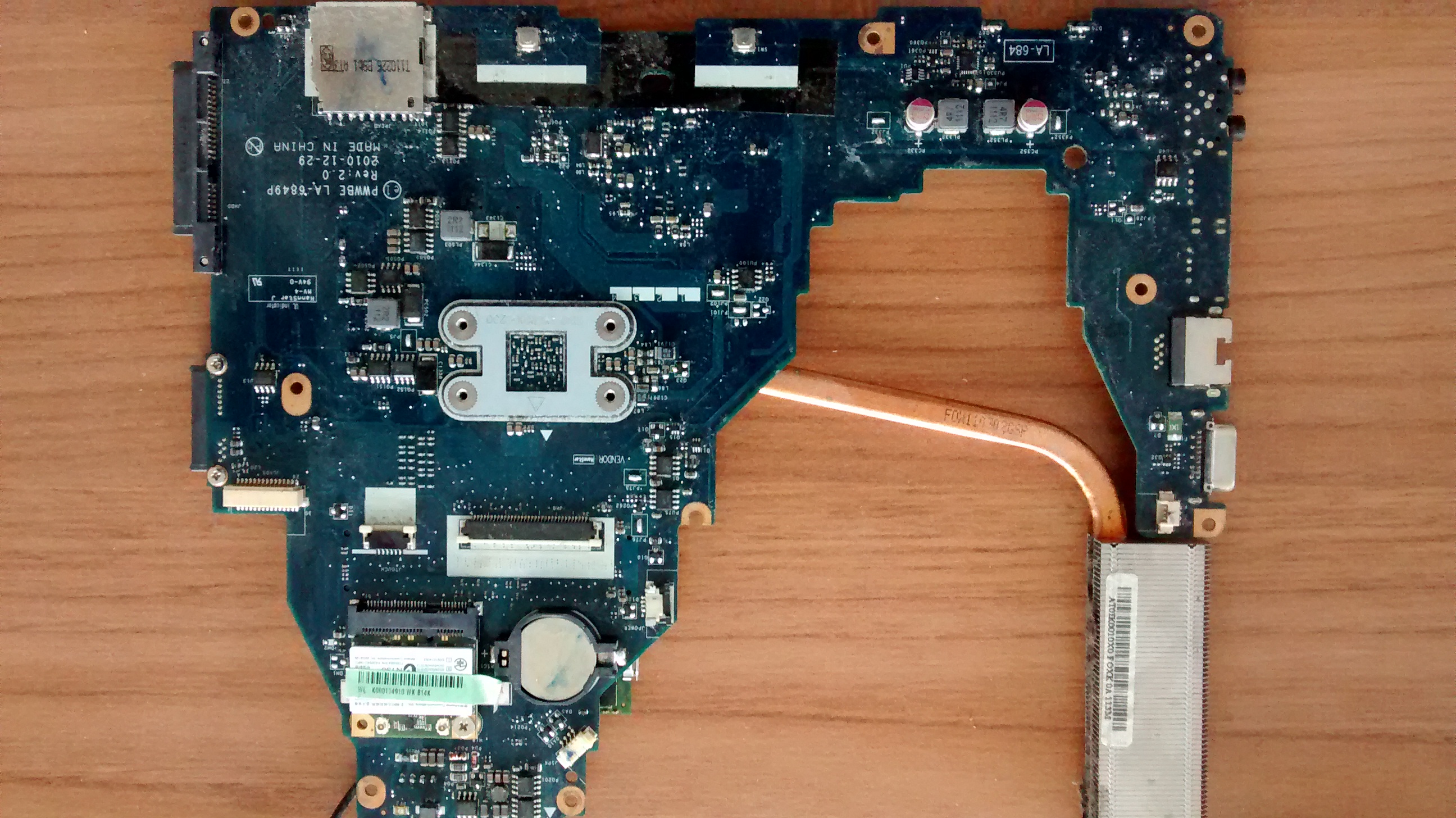

    I have a toshiba c660D with LA-6849P motherboard.
    When I plugged it on power the green light that has power lights but when I press the power button nothing happens.
    I checked the power mosfets they have 19V.
    I checked the chipset PU330(page 30) which has 3 & 5 volt
    pin 16 VIN 19V
    pin 8 VREG3 3,3V
    pin 17 VREG5 5,08V
    so I have voltage there.
    Can someone tell me how to continue.
    PS I couldnt test the power button. What should I short to test if it power on without the button?

          Here are the readings
          PQ 331
          pin 5,6,7,8 19V
          pin 1,2,3,4 3,3V
          PQ332
          pin 5,6,7,8 3,3V
          pin 1,2,3,4 0V

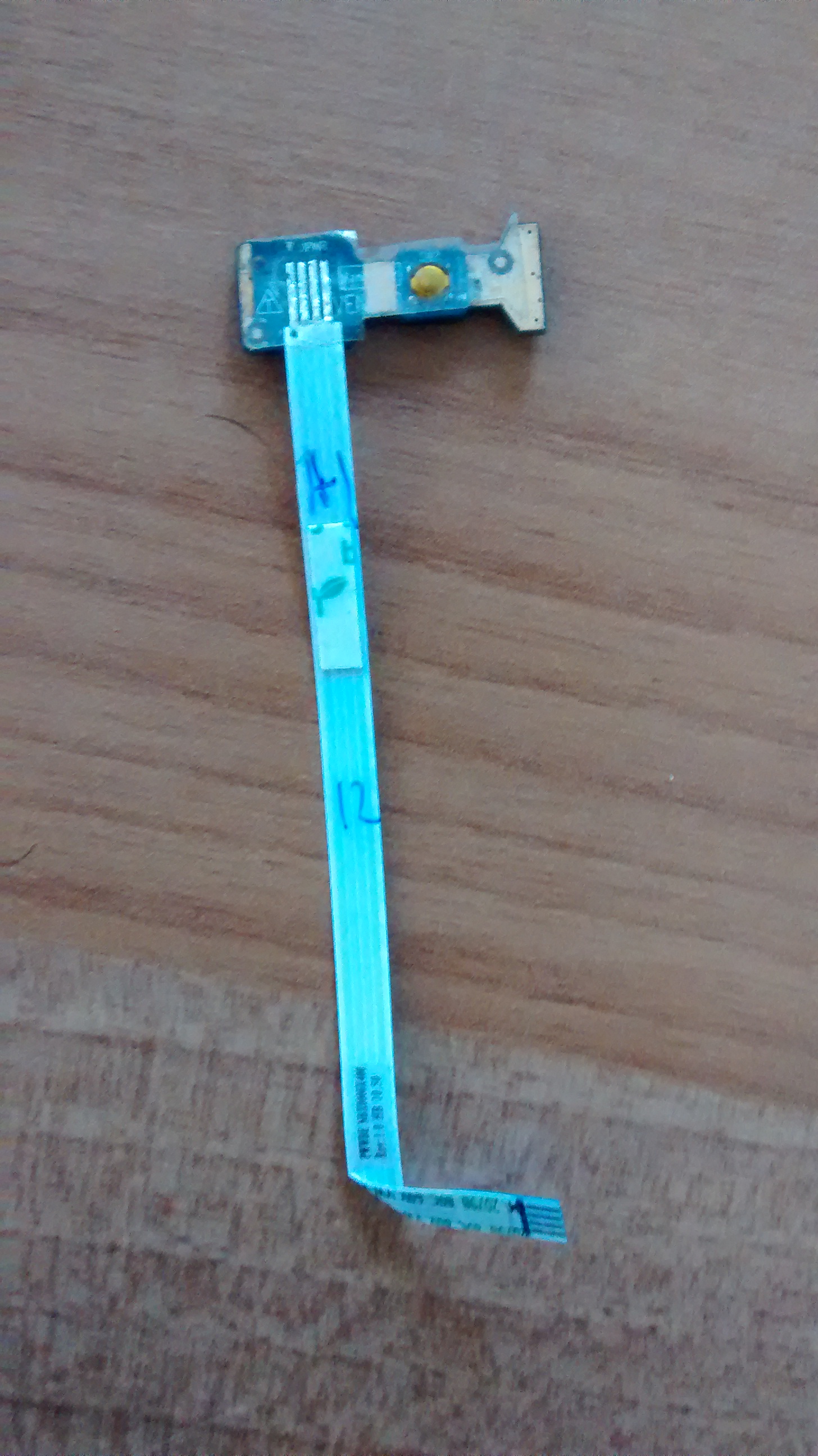

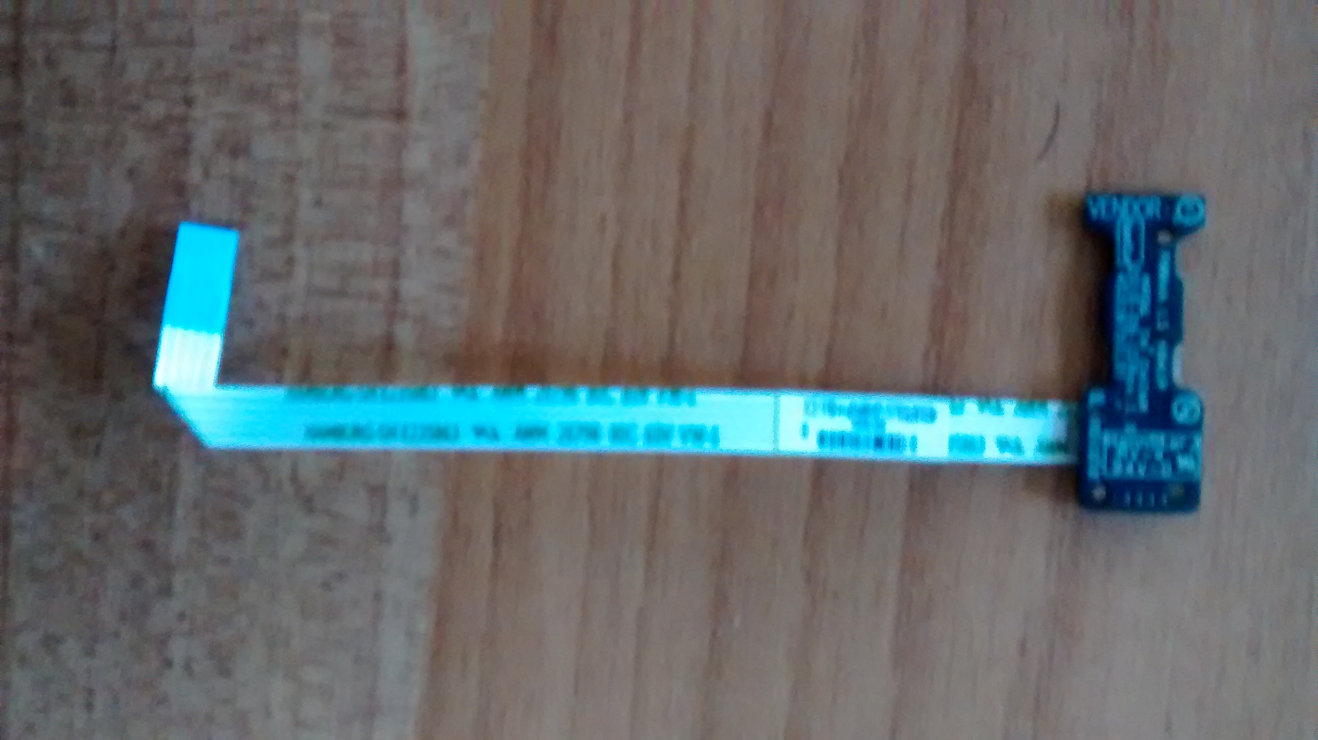

                  Re: Toshiba c660D-16L power but doesnt boot
                  It's a little difficult to measure it.
                  I attached 2 pictures to see how is the button.
                  There are no pins. How should I measure it?
                  Should I put -probe to ground and +ground to the first pin to see if the voltage goes to 0V?
                    exactly like that. just black probe to the ground and red probe to the + side
                      Voltage doesnt change when I press the button it remains 3.3V.
                      I tried short pin 1 with 4 ( ON/OFFBTN# with GND) but still nothing.
